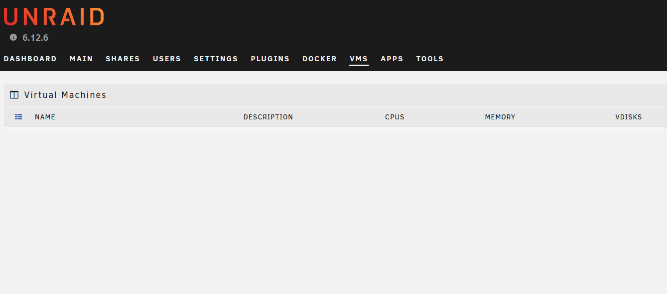

After the recreation of the VM all seams to be ok for a while. But today, again, the VM is working properly, but I cannot manage it from the web GUI.
From myunraid.net I can see my vm
but from  the vms page I don't

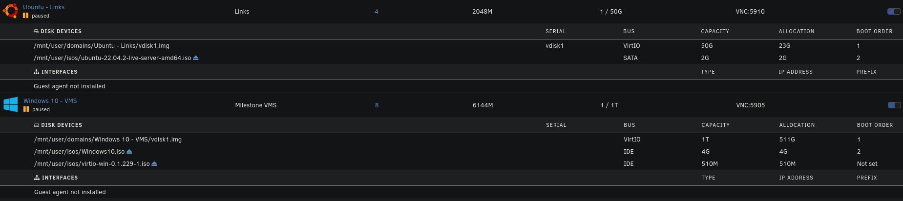

Here's a couple screenshots that should show what you need:VMs-screen.thumb.jpg.87af8190242a7cd61efcfb13208c21c0.jpgstorage.thumb.jpg.66b4162f1d81b63f001fa7c15432b6d1.jpg
According to the diags, domains share exists on disks 1, 2 and 3, and disk1 is completely full:
Filesystem      Size  Used Avail Use% Mounted on
/dev/md1p1      5.5T  5.5T   16K 100% /mnt/disk1
So any vdisks stored there will have issues.
I've figured it out. It seems that my vdisk1.img files were corrupt. I rebuilt the VM and it worked without issue. I did also notice through all of this that I had to manually assign the port for VNC on them to avoid them all trying to use the same one and crashing.

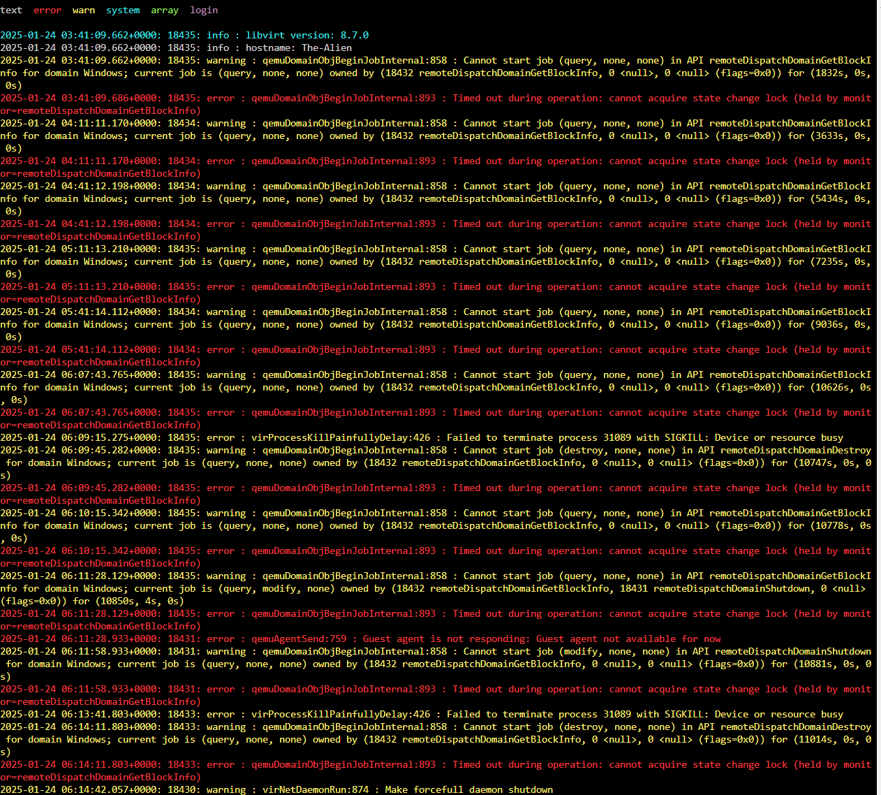

I just recently went to settings -> VM Manager to turn off the VM and then turn it back on and now my VM tab in unraid says "Libvirt Service failed to start." When i click libvirt log, it looks like below:
What do i need to do to fix my VM instability issue? Should i proceed with upgrading to 7.0.0 to fix this, or do i need to rebuild my libvirt.img file? If so, does anyone have a precise step by step so i don't destroy anything more by clicking delete image file and doing irreparable harm to my poor VMs :( (i'm bit of a noob so handholding is advised, last time i clicked around i accidentally applied docker safe new perms to my appdata folder and screwed up almost all my containers...).
