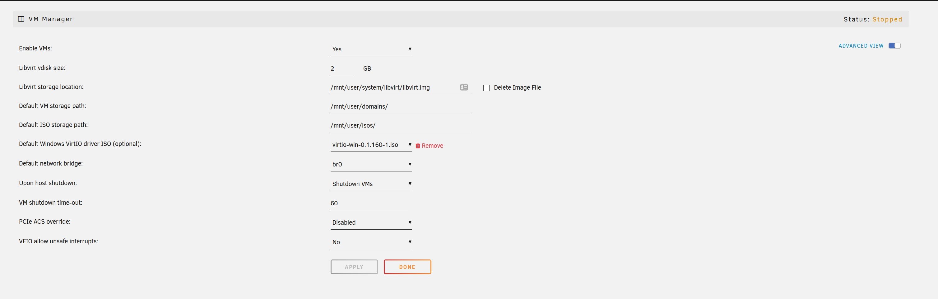

Hello, I didn't want to create a new topic as I'm experiencing this same issue with "Libvert Service failed to start" appearing. I've rebooted, I've tried to restore the previous Libvert.img. I've made sure that it's pointing to an img file as shown here2481038_Annotation2020-03-24231308.thumb.jpg.909690bc70faab146885754339a0efce.jpg
I've included the diagnostics. What's strange is this happened after I downloaded the newest VirtIO Driver ISO after building a second VM.
diagnostics-20200324-2258.zip
It appears to be starting correctly at array start, it then failed to restart, rebooting should fix that.
Just tried rebooting again, same issue, still says "Libvirt Service failed to start"
Do you have something restarting the service? Like mentioned it starts correctly at first array start, try booting in safe mode.
Nothing that I know of, would I just boot it without plugins? I see there's a no plugin and a no plugin, no gui option.
1 hour ago, johnnie.black said:
Yes, safe mode
Just tried starting it in safe mode, started up the array manually and got the same error. Should I upload the diagnostics?
Yes.
Now it's a different issue than before, the image is corrupt:
Mar 25 11:14:57 CrusherJoe kernel: BTRFS error (device loop3): bad tree block start, want 30408704 have 0
Restore from backup then boot again is safe mode.
