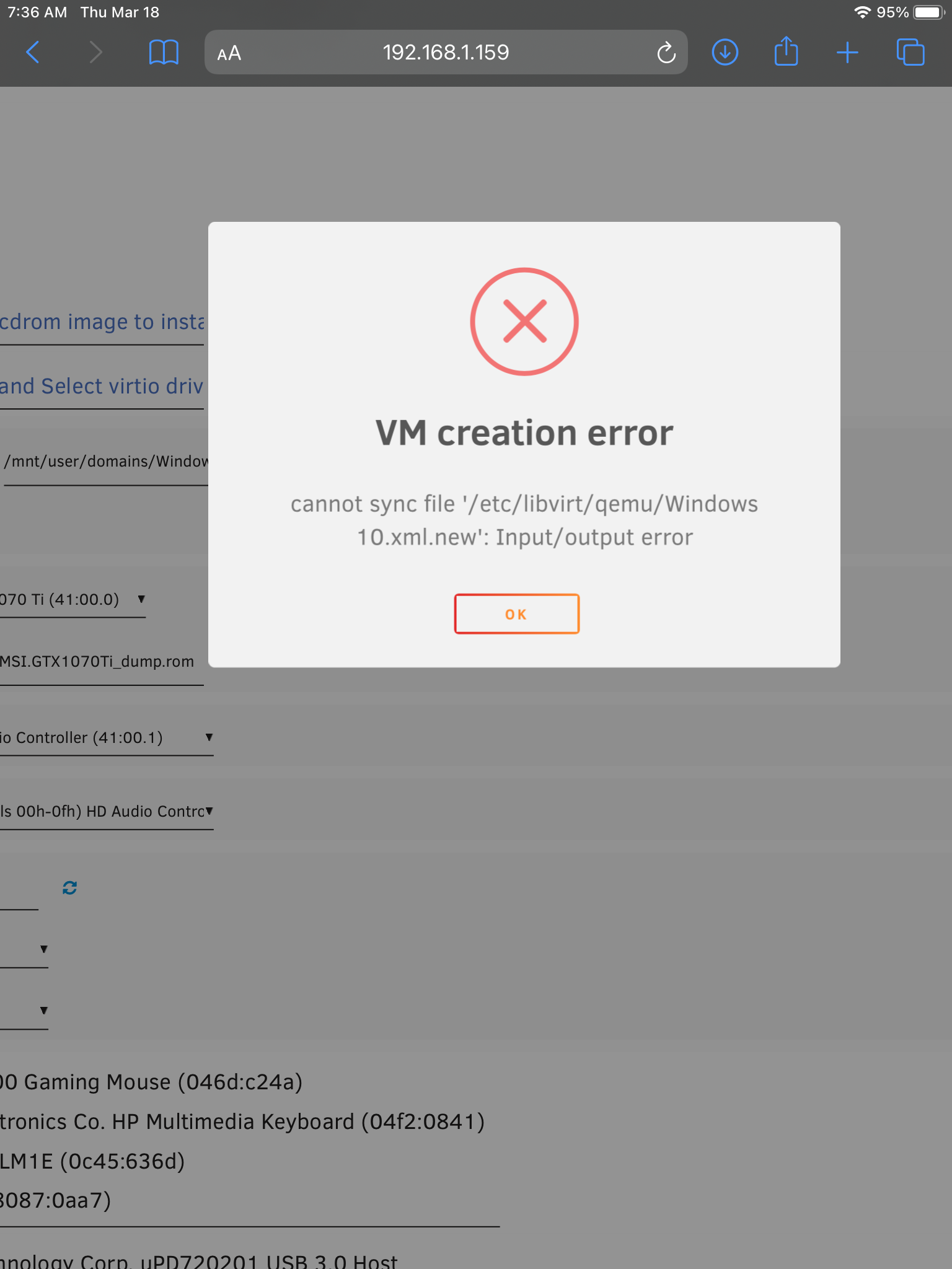

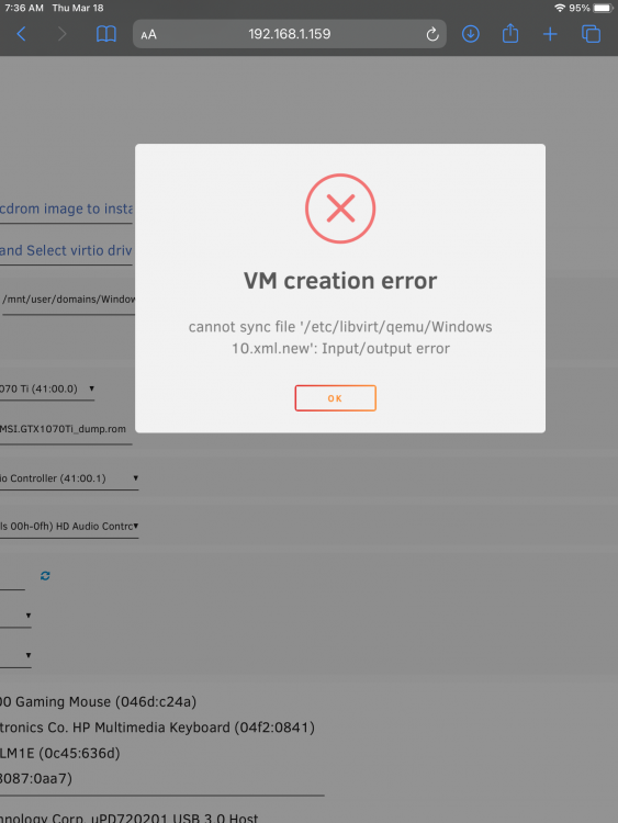

This just started for me this morning.  None of my vms will boot so I cycled the vm service and got this error message.

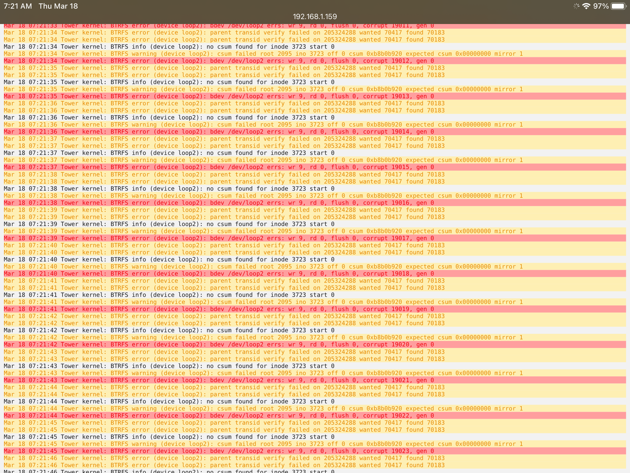

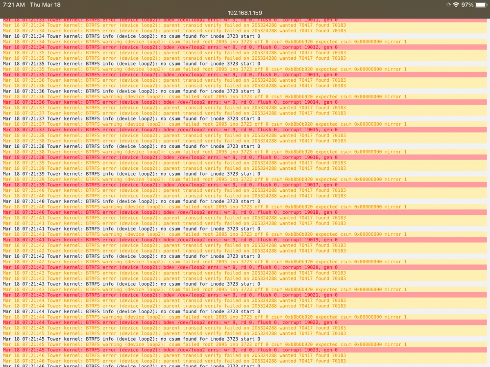

seeing this recurring statement in logs, also attached system diag.
tower-diagnostics-20210318-0723.zip
loop2 is the docker image, and it's corrupt so it needs to be recreated, because of the log spam can't see the problem with libvirt, but most likely it's because cache is completely full, free up some space, reboot to clear the logs and if still issues post new diags.
A reboot resolved the docket error.  Lost all my VMware sessions but the images are still there at least. When I got off create a new image it threw the screenshot below. After I cycled the vm manager it tossed the liberty message.
tower-diagnostics-20210318-0740.zip

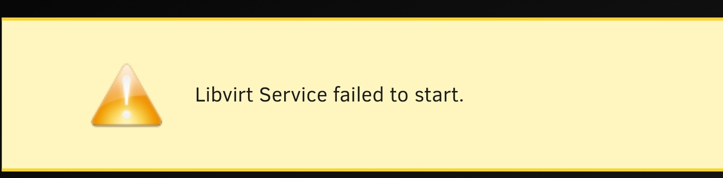

You know what the "Libvirt Service failed to start" banner looks like.  Attached, my diagnostics and any help in understanding my problem is greatly appreciated.
Scott
enderman-diagnostics-20220119-2208.zip

Here's why
Jan 19 19:49:13 Enderman root: /usr/sbin/libvirtd: error: Unable to initialize network sockets. Check /var/log/messages or run without --daemon for more info.
I'm not a network guy, but something looks like it changed (br0 not available???)

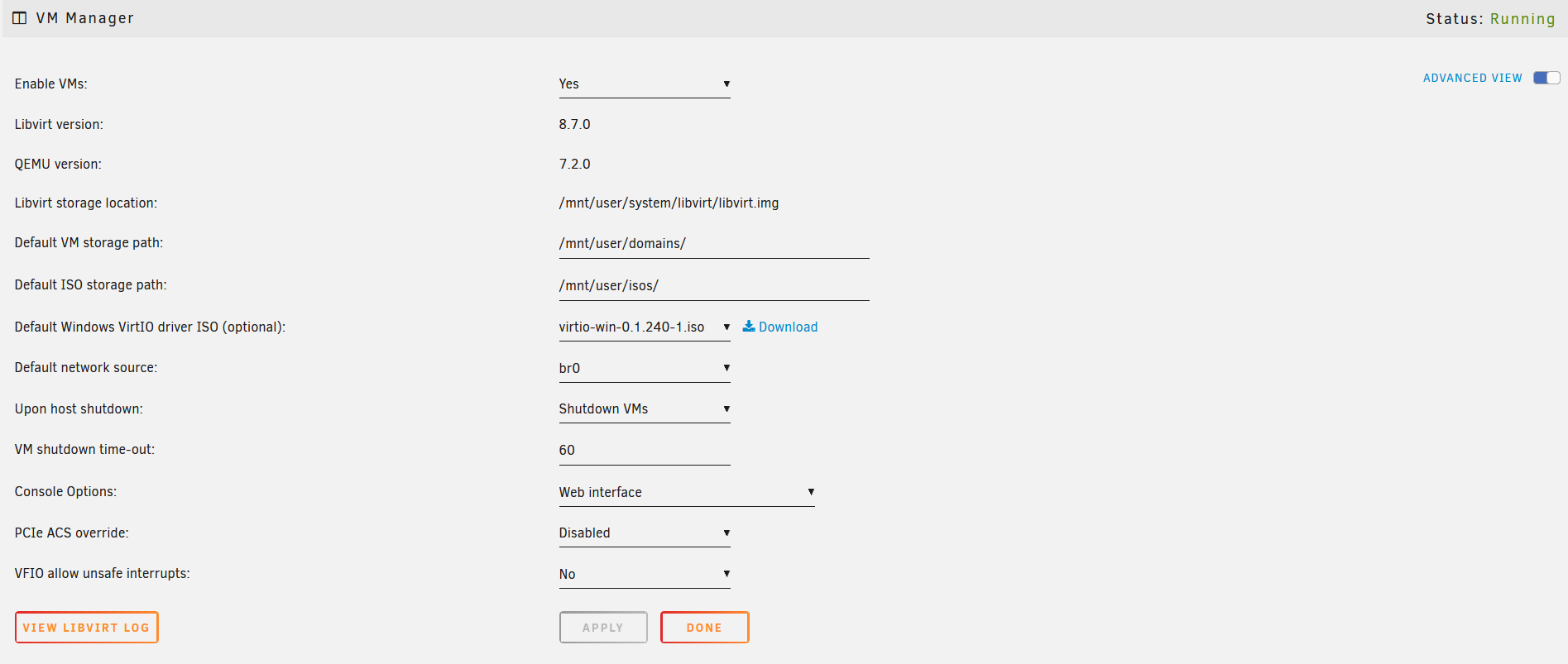

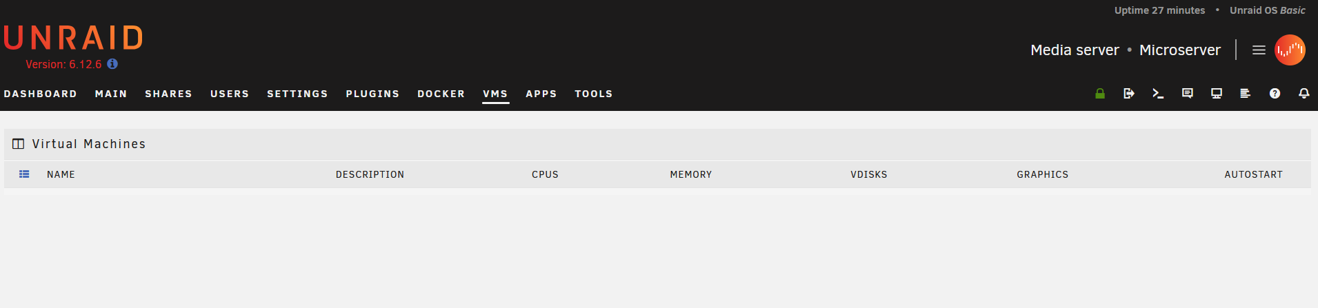

Hello folks, I have a similar problem: after a power outage my VM does not appear, it is turned on, but not working completely. Network and USB devices do not work.
If I disable and re-enable the VMs, I get "Libvirt Service failed to start.".
I tried rebooting the system, deleting libvirt.img and recreating the VM but I still have the same problem.
I don't have any logs on logterminal/libvirt.
What can I do?
