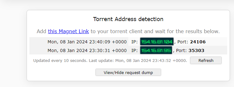

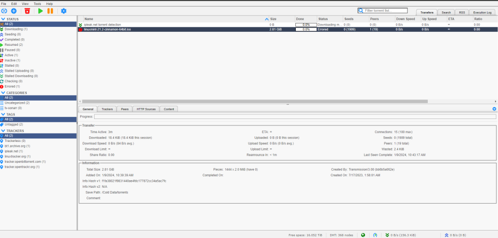

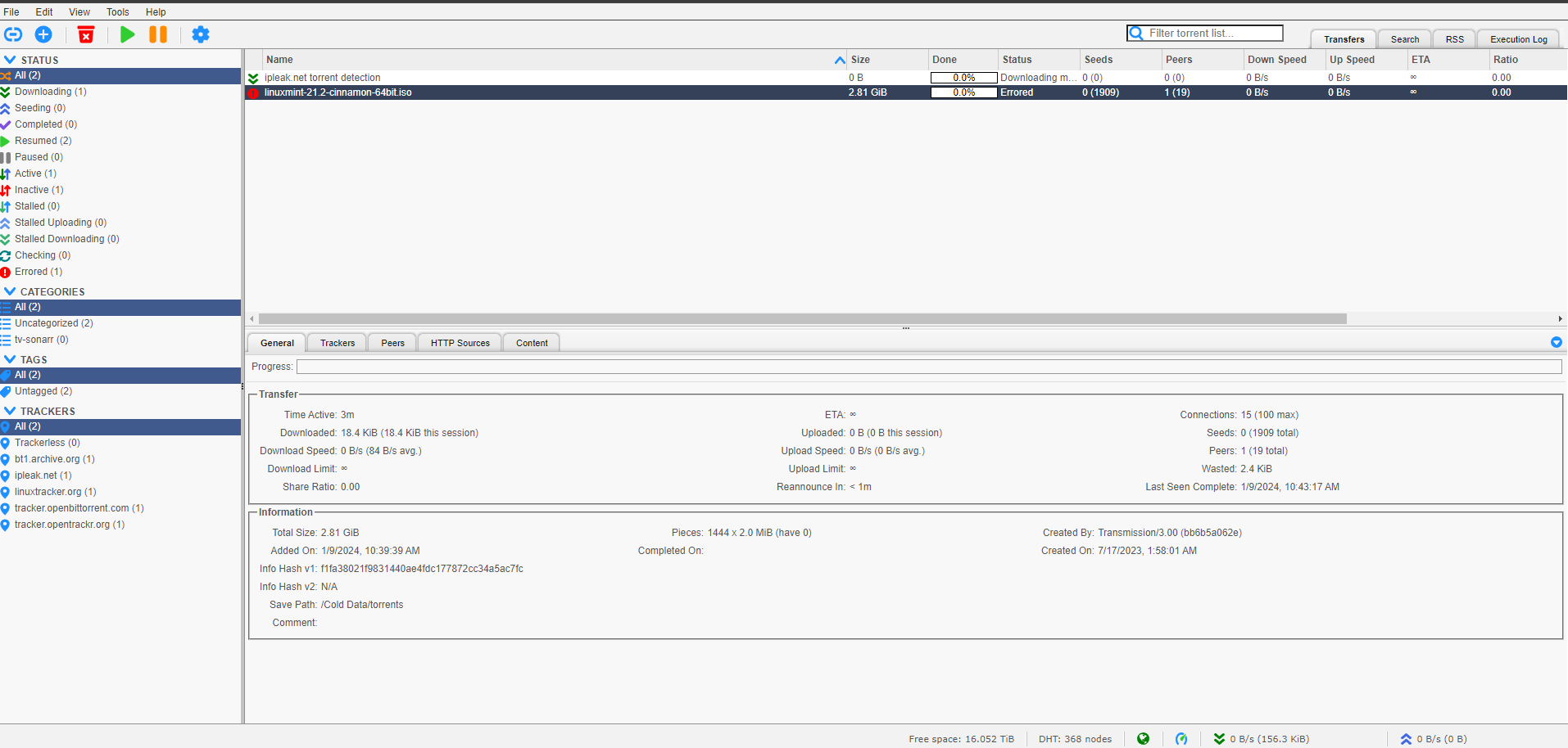

i am currently have  some issues with this container.
All my torrents (except one) are all errored out.
I added the torrent address detection aspect to check if i am getting any form of connection out of the box, and it seems to be working.
Running `curl ifconfig.io` on the terminal for the container also gets the same ip ass the torrent address detection.
I have tried both wireguard and openvpn with my PIA account. Both have the same issue.
Edit Figured it out . I didn't have access to my "incomplete folder" it was outside of the scope of the permissions i gave the container.
