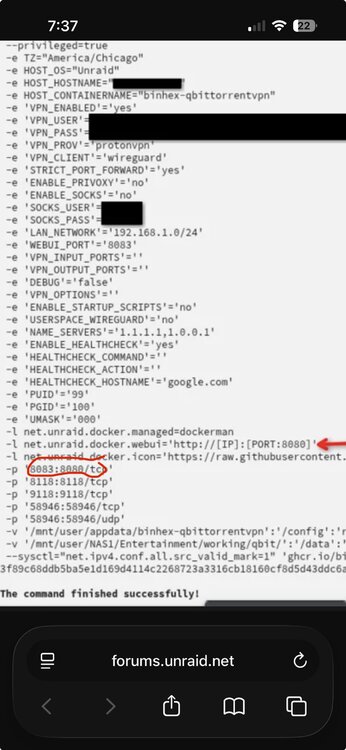

12 minutes ago, TestingUser said:
@wgstarks I don't know if you have any other ideas on what might be going on here or what I might be missing, I have several other binhex containers running and they've all worked without any issue. This is the only one where I can't get the webUI to work. I even changed my container that was using 8080 to use a different port so that I can try to get this qbitVPN running on 8080.
The binhex non VPN version loads up no issue, other versions of qbitvpn work but I can't get this one to work with the webui.
attach your docker run command agian for the container, it sounds like you have changed some settings but i assume you have missed something, Q4 is still relevant:- https://github.com/binhex/documentation/blob/master/docker/faq/qbittorrentvpn.md
Q4 is still relevant, I was referring to answer for it line 3. Find Container Port: 8080 and click on Remove. Unless I am missing something, there is no Container Port: 8080 to click remove on. Even when I click on advanced, there is no listing for container port. Though I may be missing something super obvious?

16 minutes ago, TestingUser said:
  -e 'WEBUI_PORT'='8080'
17 minutes ago, TestingUser said:
  -l net.unraid.docker.webui='http://[IP]:[PORT:8080]'
  -p '8080:8080/tcp'

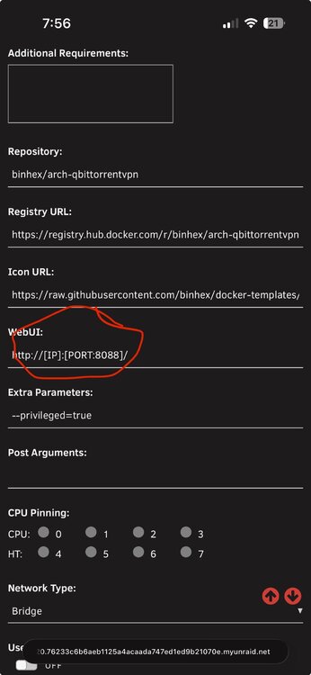

ok so right now all 3 are in sync and set correctly to use port 8080, so if you fire up your browser should be able to access the web ui on port 8080, is this the case?, if not then something else is going on.
To answer your question:
The container used to simply be named as Container Port: 8080 it's now instead named Port: Web Interface:, see screenshot below, this is what you should delete IF you want to change the web ui port from the default of 8080:
So if for example you want to change the port to 8999
  • you would delete the port above, re-add a config type port and set the host AND container ports to 8999
  • then change the value for Variable: WEBUI_PORT:to a value of 8999
  • and lastly if you want the web ui link to work when you left click the container icon then switch to advanced view (top right) and then edit the Web UI: to a value of http://[IP]:[PORT:8999]
  • click apply at the bottom and fire up your web browser and go to http://[server ip]:8999 (or left click the container and select web ui).

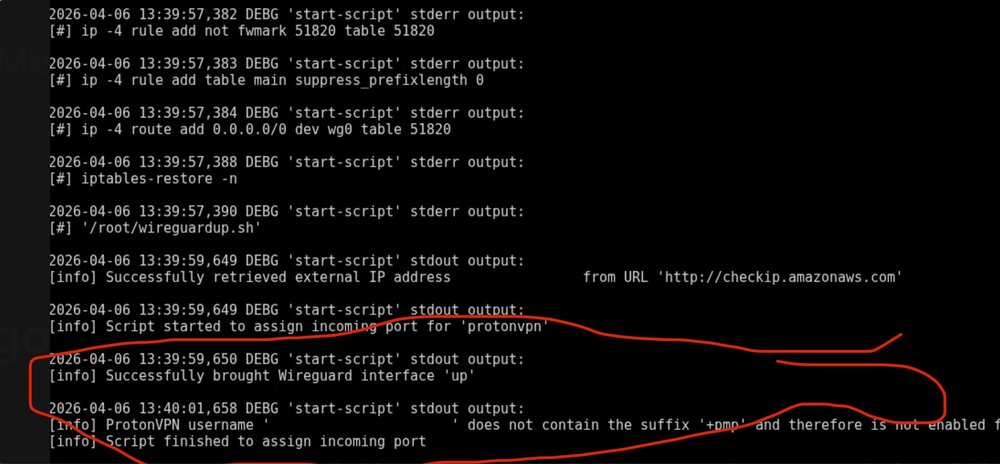

There is one problem in the little log snippet you posted-
You don’t have your user name appended properly to use ProtonVPN. There may be other issues but you’ll need to attach your entire supervisord.log file from appdata to let others review it (not just a screenshot of a snippet).
All references to the old names has been updated to reflect the template name changes, so you should be able to follow this step by step now.
Here is the supervisord.log
supervisord.log
Last lines inthe log file:
[debug] Valid VPN gateway IP address from tunnel acquired '10.2.0.1'
[info] ProtonVPN username 'U_NAME' does not contain the suffix '+pmp' and therefore is not enabled for port forwarding, skipping port forward assignment...
[info] Script finished to assign incoming port
So does your username for proton have a suffix of +pmp?
My username is just an email address and it does not have a suffix of +pmp
add +pmp to your username.
If I and that and start it up, the last few lines change to below and webui still doesn't load.
[warn] ProtonVPN endpoint '95.173.217.187' is not enabled for P2P port forwarding, skipping port forward assignment...
If I disable Variable: STRICT_PORT_FORWARD: by setting it to no, web UI loads and I get this output for the last lines repeating every now and again

you need it if you need an incoming port (which you do for torrenting) to allow you to connect to the maximum number of peers, if you aren't torrenting then feel free to set it to no. if you do need an incoming port then you will need to download the correct wiregurd configuration for a p2p enabled endpoint - see proton's documentation.
