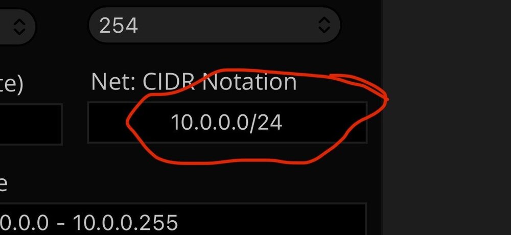

3 hours ago, wgstarks said:
When I enter those values into the calculator I get 10.0.0.0/24 which isn’t what you have set in your previous post.
Sorry, I'd been messing with it to see if that could be the issue, however it wasn't. I've got it as 10.0.0.0/24 now and still no luck
docker run
Looks like you changed your webui port perhaps? I see that you have a port mapping 8080:8081. I’m not sure why you have that unless it’s a mistake.
https://github.com/binhex/documentation/blob/master/docker/faq/qbittorrentvpn.md
In Q4 the process to change the webui port is outlined. Step 5 adds the mapping for the new port. Container and host ports should both be 8081.

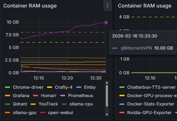

On 2/16/2026 at 3:36 AM, semioniy said:
Howdy, partners.
Just set up Grafana after a couple rounds of OOM and the whole server locking up (48GB RAM, we balling yes) and noticed the constant rise of RAM usage by qBittorrentVPN
Never reported anything like this - what info can I provide to help?
I'm in the same boat as you.
My binhex-qbittorrentvpn has usually used an abnormal amount of RAM. Kind of hovers around 12GB usage. Always starts small, then grows to that and kind of stays there.
Been that way for over a year.
Around the same time you started your issue, I also started getting an issue where mine will just never stop growing, then crash my entire Unraid server.
Now I limit it to 16GB RAM and it still just keep growing and crashing throughout the day. (the container restarts, not that my server is crashing).
I have about 5500 seeds going. Others tell me they have WAAAAAAY more and their RAM usage is around 2GB.
At this point, it's restarting every couple of hours and is causing issues with my private trackers, creating ghost torrents and such.
I've changed all kinds of settings with forum and AI help.
Disabling caching, changing all kinds of numbers, etc.
Nothing is working and I have no idea what else to do unfortunately.
So, I'm right there in the same boat with you.
edit: Welp, today the problem is so bad, qbit won't even load any longer.
Edited by DevanteWeary
