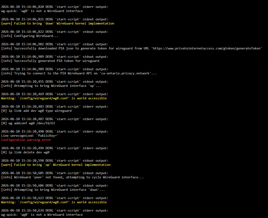

7 minutes ago, wgstarks said:
There was a post a few weeks ago with the same problems as you. No valid WireGuard connection. You should download a new WireGuard configuration file from ProtonVPN and install it.
Confirming this did fix it. Sorry. I have had this exact issue before and it was actually the container's fault, with updating config having no effect. I should have checked
There are many situations that can cause the failure to connect when VPN is enabled. Anything that prevents the VPN tunnel from connecting will stop the qbit app from starting and as a result there is no webUI to connect to. So many issues can cause this symptom.

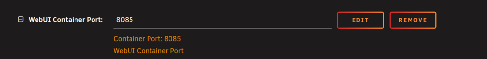

Just installed this on UNRAID 7.3.1. Had to switch to Usermode for Wireguard to work. Also, Web UI never loads. I tried connecting the port 8085, but it never loads. LAN is set to proper LAN in the Vars.
Is this still working on UNRAID 7.3.1 ??
I can run binhex-delugevpn no issues, but wanted to try switching to qbittorrentvpn.
Yes. Not sure it’ll work with WireGuard though. The log snippet you posted shows a successful start. You should be able to connect to the webUI from your local network.
Edited by wgstarks
If you can’t connect attach your supervisord log and docker run command to your next post. Be sure to redact users/passwords.

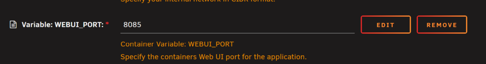

has anyone managed to succesfully remap port 8080 to something else and have webui come up?
