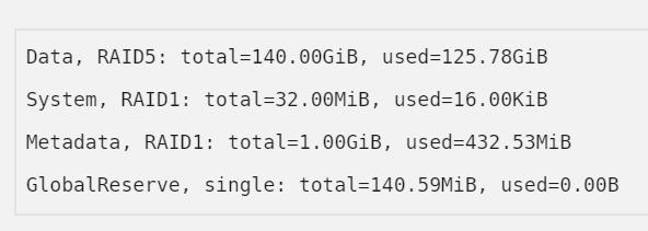

1. I attached a screen of the displayed settings, it seems the data is RAID5, while system and Meta Data are RAID1. Is this correct?
Though better in latest kernels btrfs raid5/6 is not as reliable as raid1/10, I use it myself but make sure you have backups of any important data there.
47 minutes ago, Jaster said:
3. The Cache size is displayed as having 1.9TB; the drives I use are 2x500, 2x250, 2x120, which is about 1.7TB but without any raid level.
That is because of using raid5, it's still not supported by btrfs fi usage, used space will show correctly, free space will show without accounting for parity.

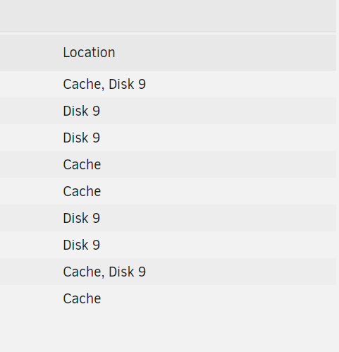

After setting shares to Use cache:yes and prefer, I ran the Mover twice.
The Result is very strange -> some files remained on the array, others where moved to the cache and some remaining are on the cache only!
What is happening?
What is happening?
Your description and that screenshot don't really provide enough details to comment.
Any share you set to prefer should wind up on cache if there is room. Any share you set to yes should wind up on the array. Also, mover can't move open files, so you may have to stop docker/vm services to get some things moved.

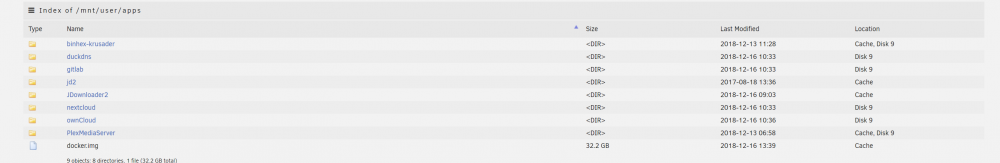

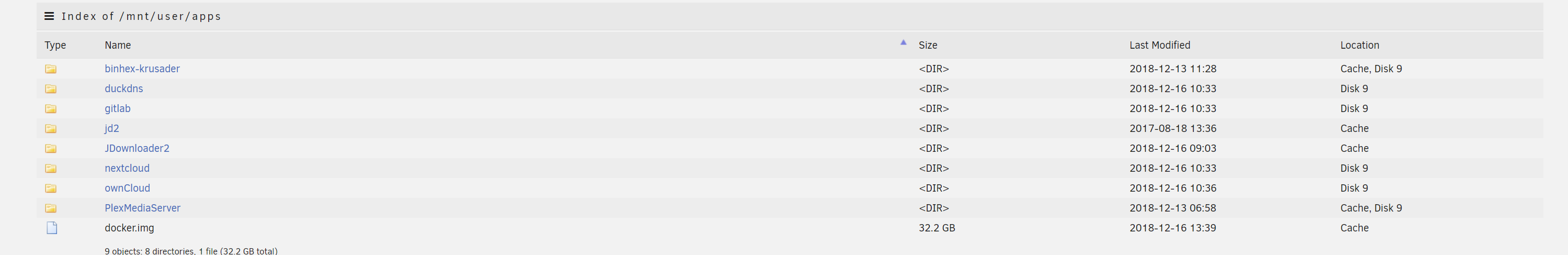

So here is the full /apps share view.
I set it to cache:yes and ran mover.
Then I set it to cache:prefer and ran mover once again.
The screen shot show the result.
While mover was running, all dockers except from krusader have been down.
If I inspect the deeper levels, I do see some files on the cache, others on the array, but barley anything is on both.
That means the docker service was running. The docker service must be stopped, which will remove the docker tab from the GUI. Then all the docker files can be consolidated to either the parity protected array (cache yes) or the cache pool (cache prefer).

Your syslog indicates mover was still working on moving plex so that would explain why some of plex hadn't moved yet. And you already said Krusader was still running. So that pretty much explains the results in your screenshot.
You are right, the dashboard didn't show the mover as running, so I got the diagnostics.
Now it has completed, but ALL data is on the cache now. I would expect it to be on both, cache and array, but it is not.
Also I would assume, I don't have to shutdown the docker engine to have the nightly job sync all the files. Anything in access won't be synced, but that should rule out itself with a couple of runs spread over some days. Or am I getting something wrong? Maybe the docker.img could be lost, but everything else should be good...
Edited by Jaster
Why would you expect that? The 'apps' user share is set to cache-prefer, so everything should be moved to cache.
