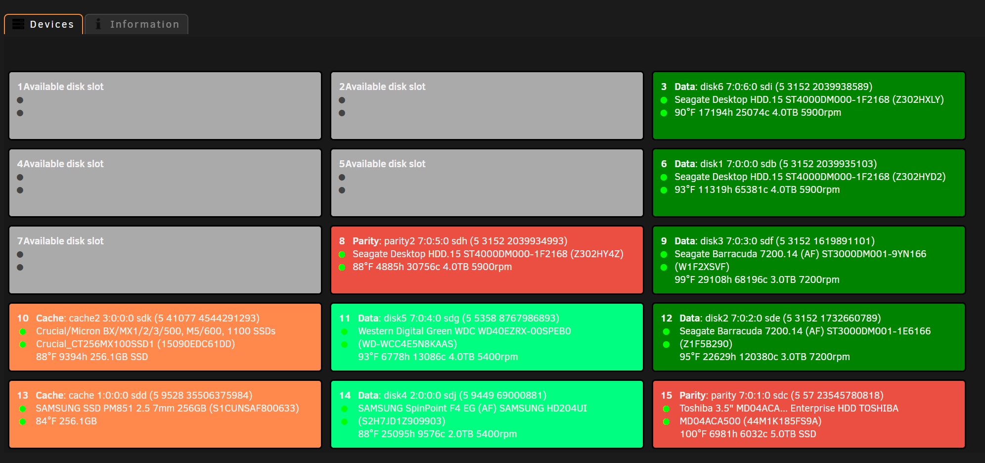

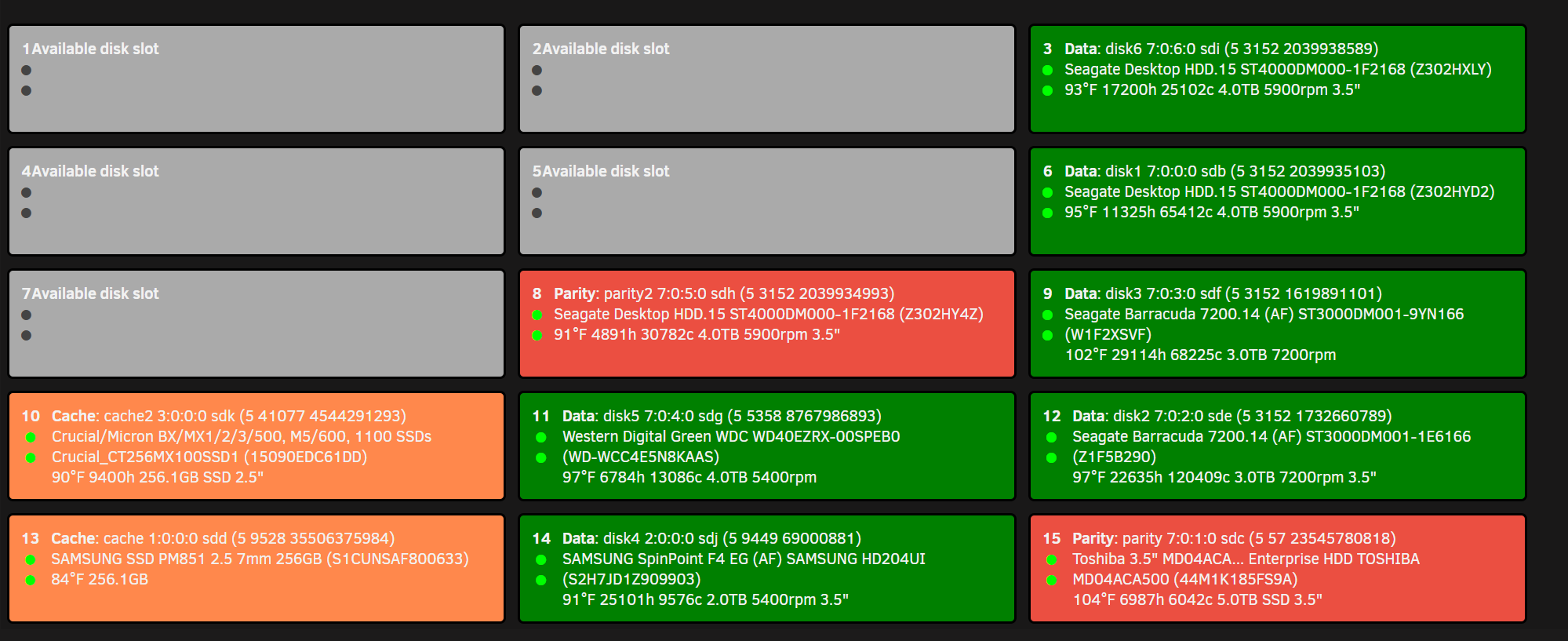

I changed the color of the data disks to a darker green (makes it easier to read the white text).  However, it only changed the data disks colors as shown.  The other 2 in slots 11 and 14 are still the default green.
Edited by JasonK
Did you make sure that:
- You changed the "Data" color under the "Configuration" tab and not the "Custom color" under "Tray Allocations"
- Does not try to use the same color for "Custom color" as for those pre-defined under "Configuration"?
Custom colors works as an override and can not be the same as "Parity" "Cache" "Data" "Empty" or "Unassigned" pre-defined colors. Try to change 11 and 14 to f.eks. #FF0000 to see if it saves and uses those values, to reset to colors, you can use the predefined colors and it will automatically ignore it and use the pre-defined instead.
I changed the colors in the configuration tab
The drives you assign has to be recognized as "Data" drives by Unraid and connected to the device node. There's nothing which can interfere with the main colors, sure you haven't stored some custom colors for disk 11 and 14?
Do you use a different card for these drives, than the other drives - like raid card or something. Maybe lsscsi doesn't pick up the device nodes and then won't find the function it is assigned for. For Unraid/main colors, it uses only device node and not the scsi generic device node. I have no documentation about what Unraid stores if it does not get the device node name.
Nope - the data drives are all connected to the same sata/sas breakout cables connected to the motherboard.  The cache drives are connected to SATA header connections directly on the motherboard.
Then I suggest deleting the database and redo it, if that doesn't help, then I don't know what causes this. It should simply not be possible unless custom colors has been saved.
How would I best do that?  I've had it rescan the drives.  As you see in the image above, the app shows the 2 bright green drives as data drives.
Under "System Files" you can delete the database - you have to set up everything again, but it might help.
Deleting the database and reconfiguring from scratch seems to have fixed the issue
Thanks
