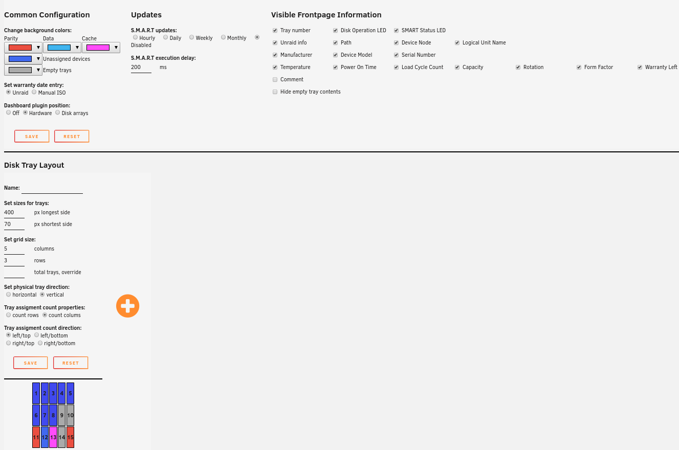

On 2/6/2020 at 9:47 AM, olehj said:
You have the same colour for unassigned and data drives. The colour picker always list the chosen colours first and in this row from the left: parity, data, cache, unassigned, empty. The extra two added ones are the default colours for data and cache (which is replaced by your custom colour). The behavior is expected :)
But my Data drives are shown in a darker blue, and this colour doesn't appear in the picker.
Where? Under "Configuration" you should, under "Tray Allocation" you shouldn't.
The point is that it shouldn't mix up Unraid assigned devices with unassigned, but you can still manually force a custom color. Unless you choose the default colors specified under "Configuration". If you choose any color specified under "Configuration" in "custom color" it will reset like choosing "Gray/Empty" color.

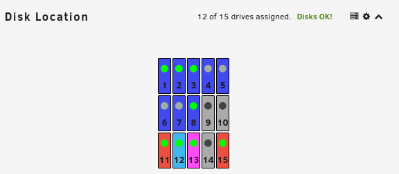

I have been selecting default colours, I have clicked the reset button, and the machine has been rebooted.  What else can I do to gain control over the colours?
See attached screenshot. Disks 1-8 are data drives, Drive 12 is unassigned (used for docker).

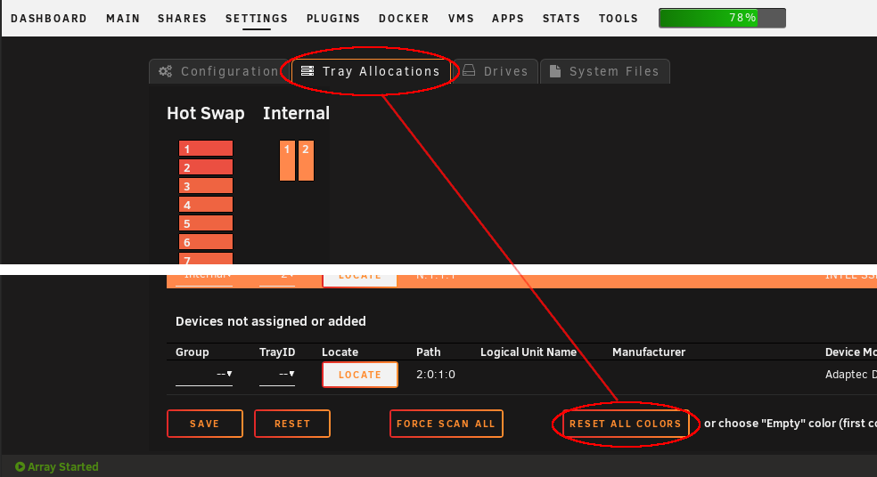

-This- reset button?
Ah, that was just off the bottom of my browser window.  Okay, that has done the trick - thanks.
