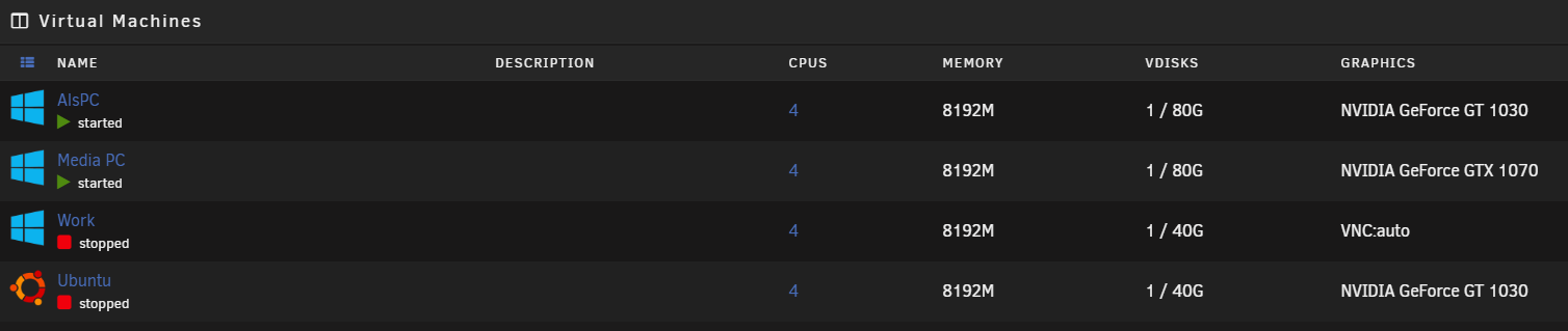

if u want to run simultan, yes, dedicated for unraid (unraid build needed) for dockers ...
and dedicated for each running VM simultan
sample
Intel igpu, GT1030, GTX1070
intel is for unraid (no special build needed, just modprobe i915) and dockers
GT1030 VM (AlsPC OR Ubuntu, not simultan ...) see pic, i couldnt start the ubuntu vm as the GT1030 is in use by VM AlsPC
GTX1070 VM (AlsMedia)
Ok thanks, that's cristal clear :)
