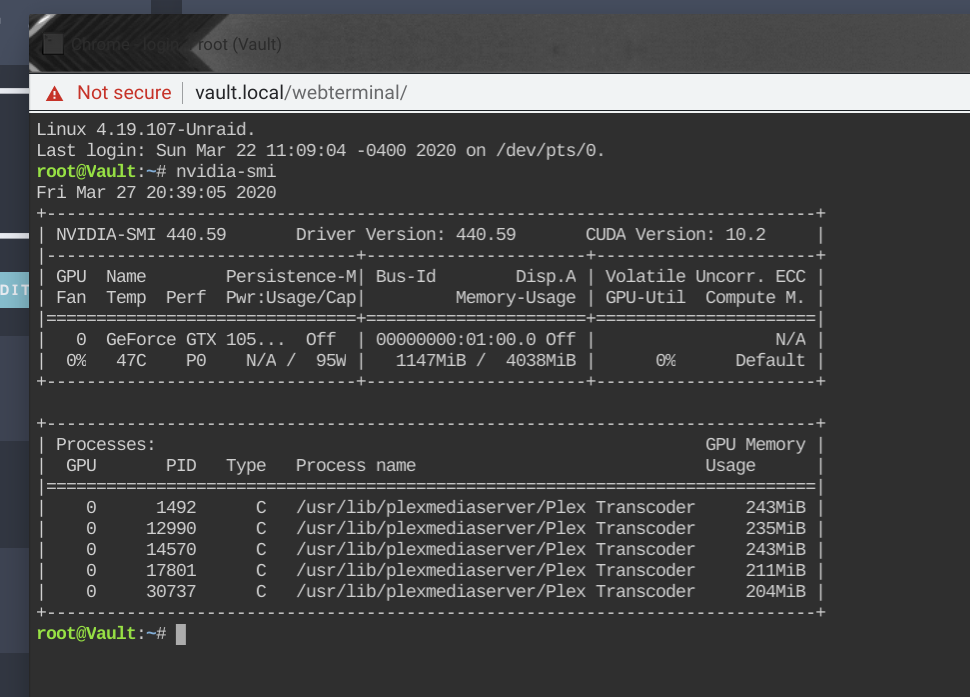

Updated to Nvidia 6.8.3 from previous versions, but it looks like my card is not being used anymore based on the info stating it is power = 0, and my cpu is running very high on 5 streams. Based on the below output, shouldn't I be seeing some use, not just memory?  Plex pas with HW Transcoding on, Tautulli cofirmed HW Transcodes, 1050 Ti installed.  I did try and removed Bionic previously, otherwise at a loss.
Looks like you do have 5 streams going. The CPU useage is probably due to audio transcode. Not sure why your power and other metrics are not reporting properly...

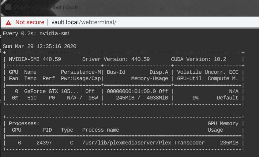

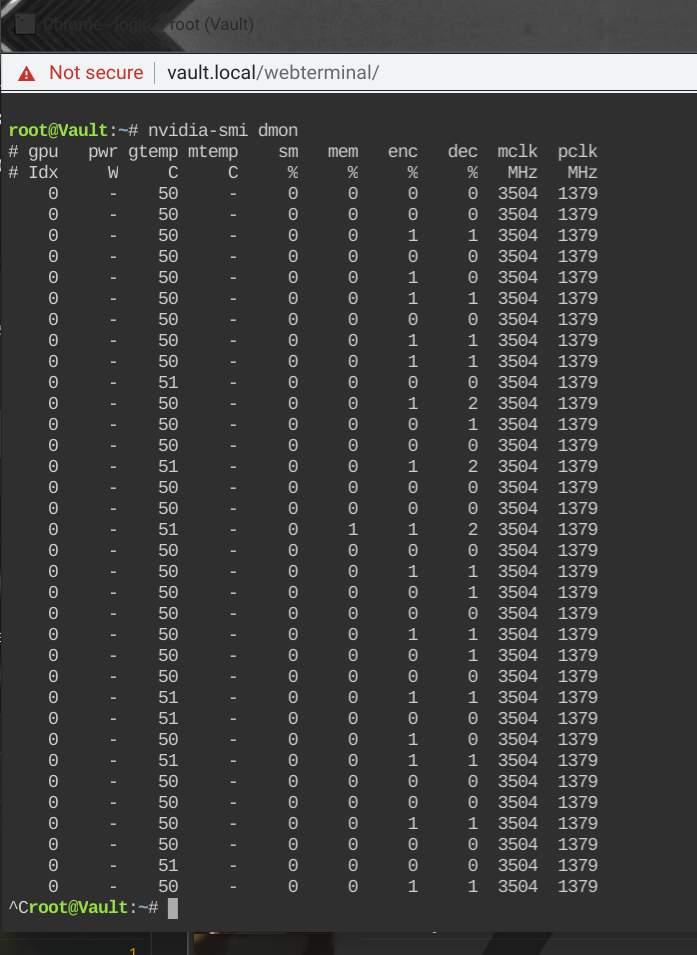

only one transcode happening now, will try to grab when there are more. It almost seems like it is barley transcoding?
Looks OK to me - 'dec' (the decoder) is showing a percent or two of utilization, and 'enc' (the encoder) is showing a percent or two of utilization.
A GTX 1050 4GB has enough horsepower to handle about 14 simultaneous 1080p transcodes though it's software locked to 2 transcodes, so if this was doing just one stream, and it filled Plex's buffer already, only a percent or two would be needed to maintain said buffer.
