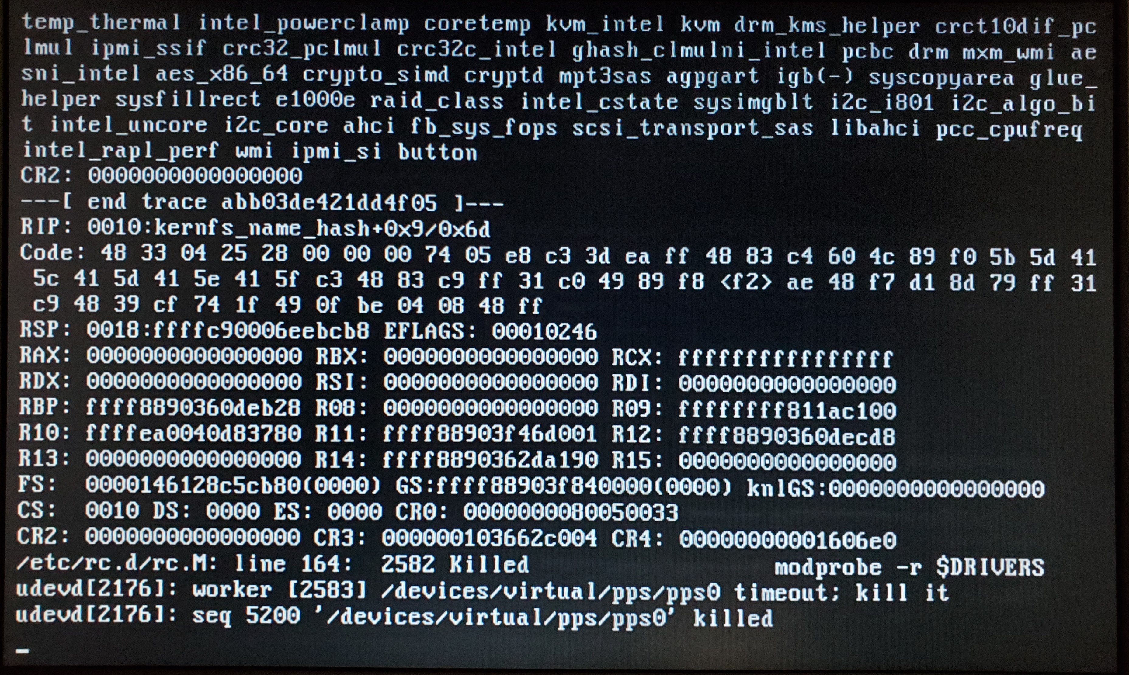

Similarly, I'm running an Xeon E5-2648Lv2 on a Supermicro X9SRH-7F board and no matter what NVIDIA Unraid build I try, it will kernel panic with my Quadro P400 inserted. Also, it will kernel panic MOST times (90%+) on any build when the card is not even inserted. My processor has the VT-d instruction set and by all other metrics it looks like the Unraid Nvidia builds should work, but they won't. I always get one of two kernel panics after unpacking initramfs.
6.8.1 worked flawlessly. Is there a way to downgrade?

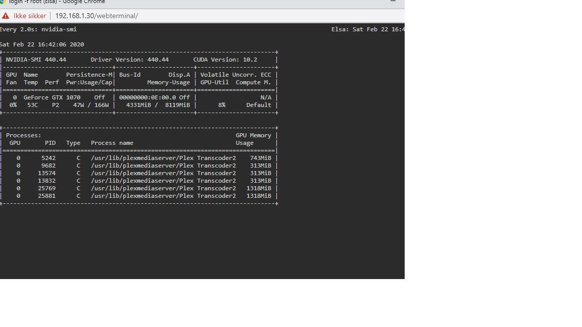

Hello,
I've just installed a quadro p400 and the nvidia buil 6.8.2.
Plex is transcoding fine but it uses almost all the gpu memory with one transcode 4k->1080p
Does that seem normal to you? And it seems to use no gpu.
| NVIDIA-SMI 440.44       Driver Version: 440.44       CUDA Version: 10.2     |
| GPU  Name        Persistence-M| Bus-Id        Disp.A | Volatile Uncorr. ECC |
| Fan  Temp  Perf  Pwr:Usage/Cap|         Memory-Usage | GPU-Util  Compute M. |
|   0  Quadro P400         Off  | 00000000:05:00.0 Off |                  N/A |
| 34%   34C    P0    N/A /  N/A |   1517MiB /  1999MiB |     65%      Default |
| Processes:                                                       GPU Memory |
|  GPU       PID   Type   Process name                             Usage      |
|    0     13018      C   /usr/lib/plexmediaserver/Plex Transcoder    1507MiB |

3 hours ago, caplam said:
Hello,
looks fine for me, sometimes will the transcode use some more ram sometimes less, and btw, the transocder is using the p400 (under "processes" en its using 65% of the gpu power.)
