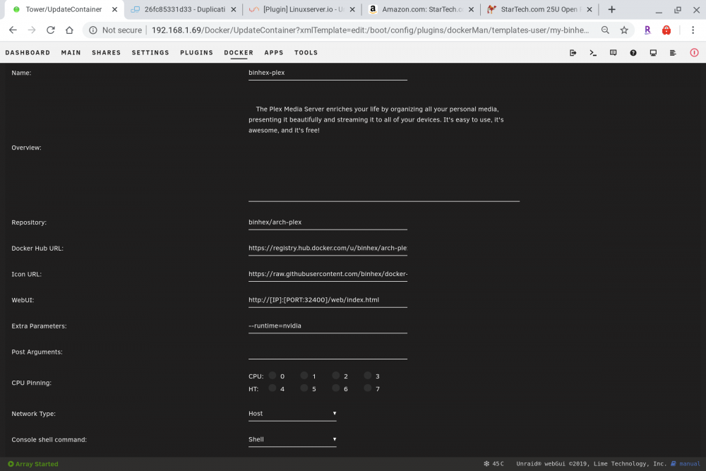

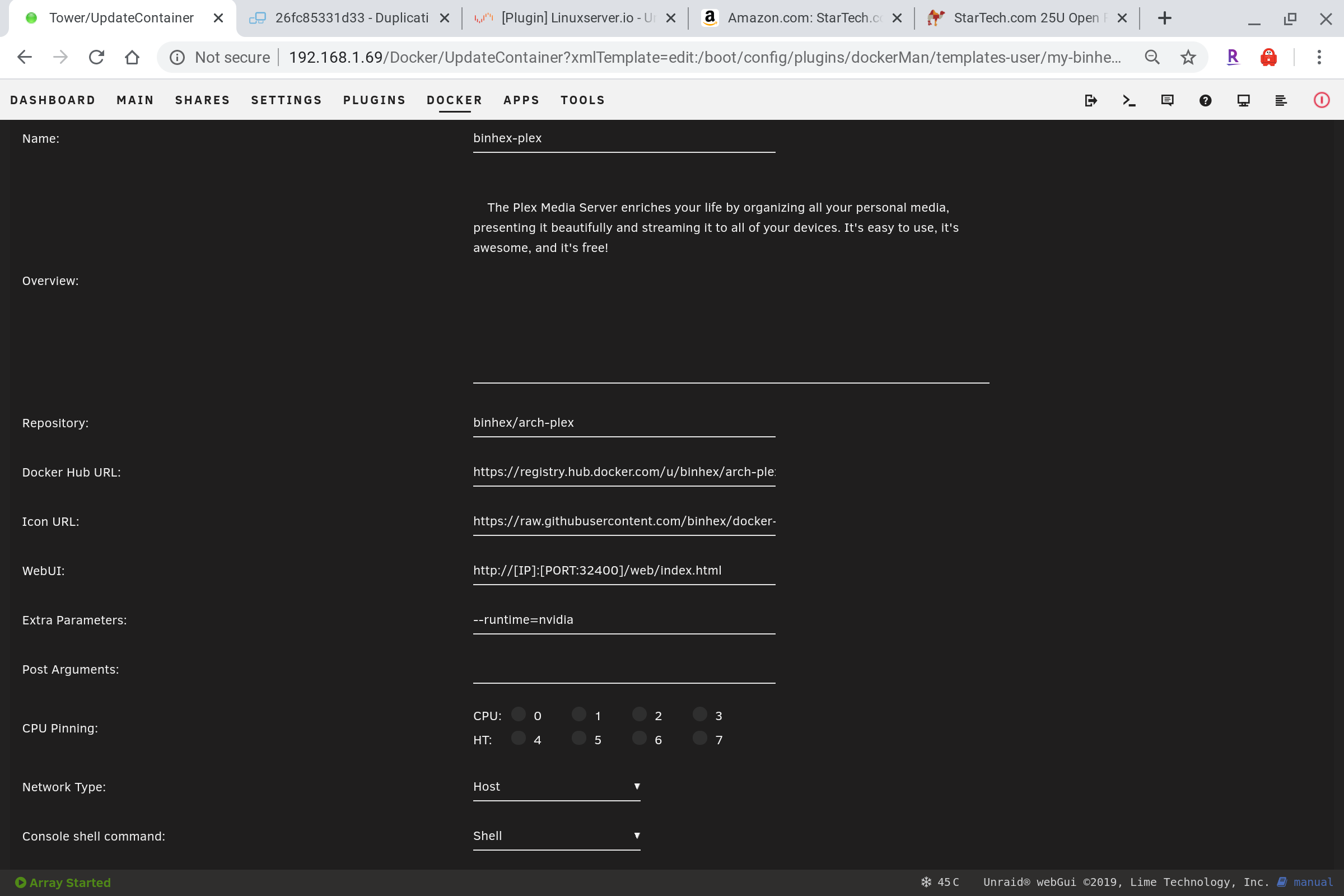

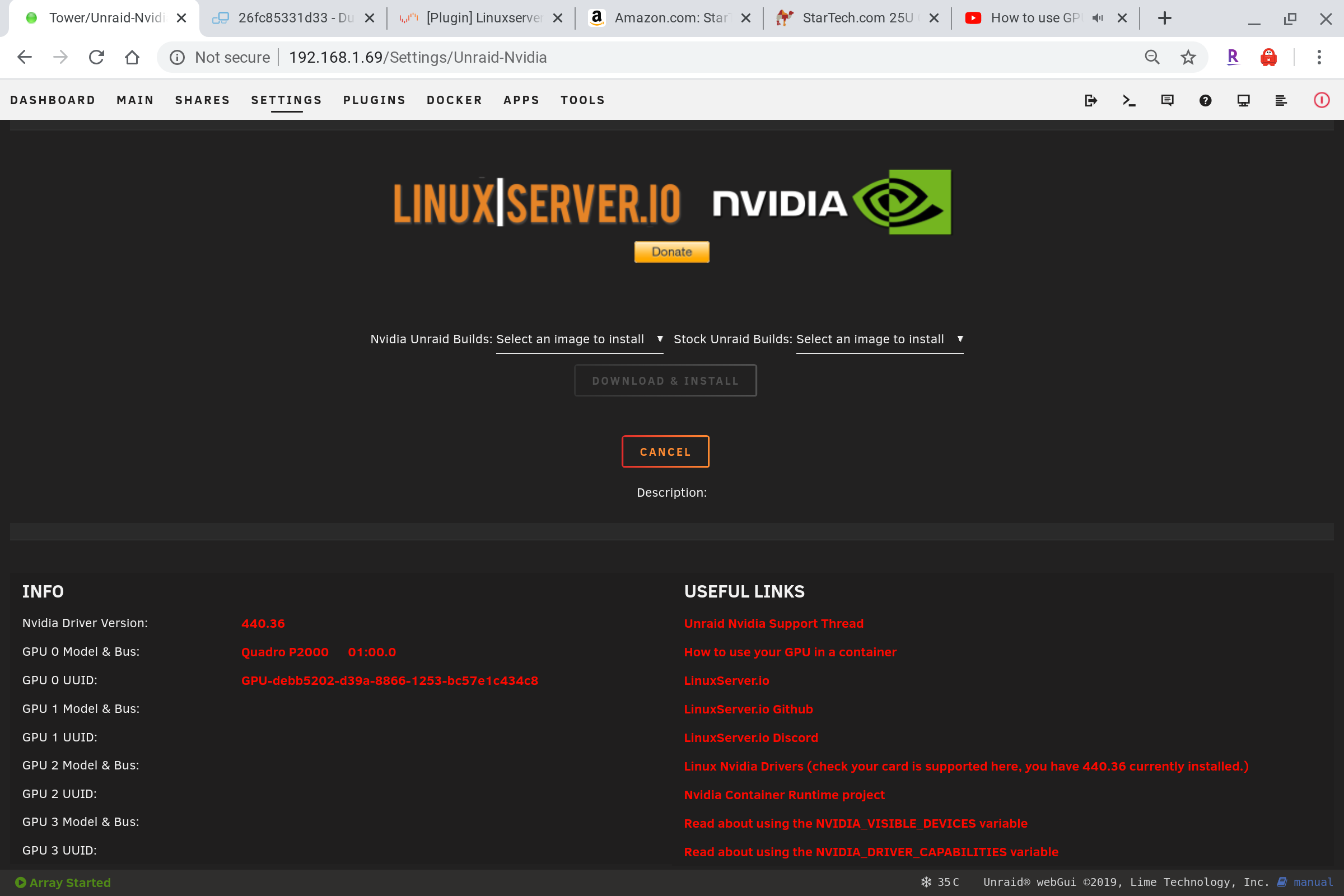

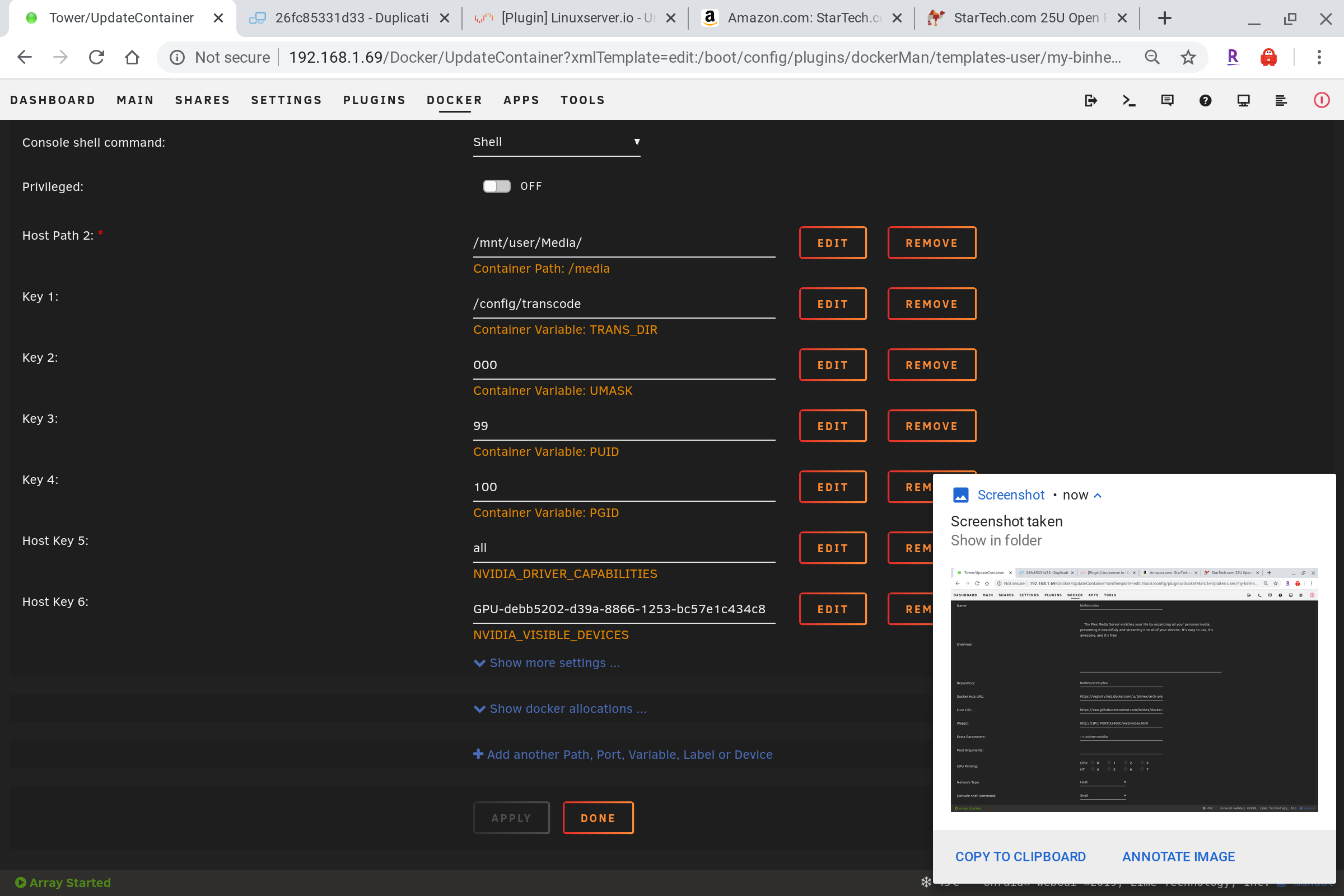

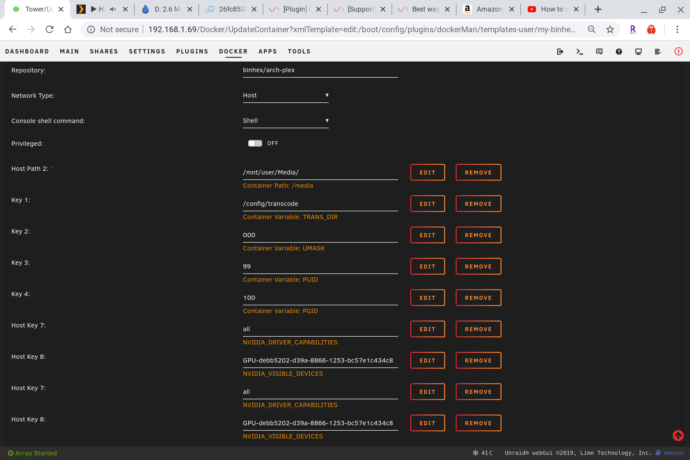

On 1/26/2020 at 8:32 PM, phasetwo said:
Sorry for bringing this up again but this seems to still be an issue.
I'm running 6.8 rc7 with the current binhex plex docker and my P600 does HW transcoding for everything except HEVC 10 bit HDR.
I'm aware that HEVC 10bit 4:4:4 NVDEC is not supported. However, a file with 4:2:0 chroma subsampling should be decoded by the card but is not. Does anyone have a clue as to why that is?
SOLVED: Since updating to 6.8.1 to the P600 transcodes large HEVC 10bit HDR files. I suspect that the driver update from 440.36 to 440.44 might have solved the issue.
