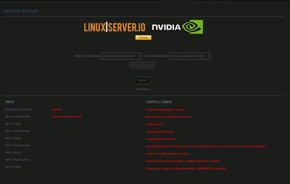

There should be a command somewhere in this thread you could issue to check if the card is working. It was posted by chbmb a few pages back I think. You did download the nvidia build using the plugin? Or did you just install the plugin?
The nvidia-smi one? That says no devices found, same message as web GUI.
Yes, installed following instructions in the OP (install plugin, use plugin to install Nvidia unraid OS).

3 hours ago, d2dyno said:
I read somewhere I need to connect something to the DisplayPort for the GPU to be recognized, but the server is just in a rack with no monitor so that's not ideal (except maybe a fake DisplayPort device). Anyone know the best course of action?
Post a screenshot of the nvidia plugin page

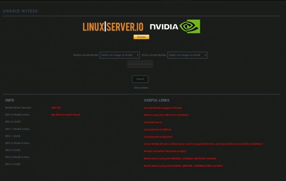

Here you are
EDIT: better quality Screenshot_20200228-042126.thumb.jpg.223817aeac936ecd5f93032eaf64df18.jpg
Edited by d2dyno
Here you are
OK, so this is either...
1. Issue of DP not being connected
2. A race condition where the plugin parses for cards at boot before the drivers have loaded.
3. Hardware failure/incompatibility.
I'm on mobile atm but I've posted (fairly recently) about number 2, and there's an nvidia command you can run to "re-parse" the cards.

Updated my BIOS (On PRIME X399-A went from 0808 -> 1203) and the Quadro now displays. It's very possible the update simply reset settings that needed to be changed too. I kept the 'fake' DP connected just in case. Thanks for all the help!
Edited by d2dyno
Wow, we should really have a disclaimer so people remember to update BIOS'es.  If not latest, maybe one version behind.  Some people still think it's unnecessary!
FYI - I don't need the fake DP on my setup - and it can mean a session is connected when you don't want it to be either...  So maybe true for you too.
