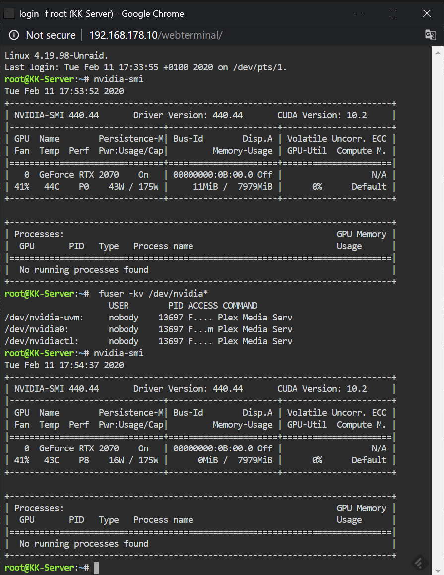

On 7/4/2019 at 9:23 PM, Xaero said:
Edit:
This is not a problem with an easy solution at all.
I can monitor the transcode processes and make sure that everything is killed - but the only solution is to kill Plex:
https://forums.plex.tv/t/stuck-in-p-state-p0-after-transcode-finished-on-nvidia/387685/24
I can user fuser -vk /dev/nvidia* and it will immediately switch to a P8 state. The only process using the card when this is run is "Plex Media Server"
It's not hard to write a script that will only do this if:
There are no processes using the card and the card is in a P0 state. I just don't know if there are any undesirable side-effects of doing it this way.

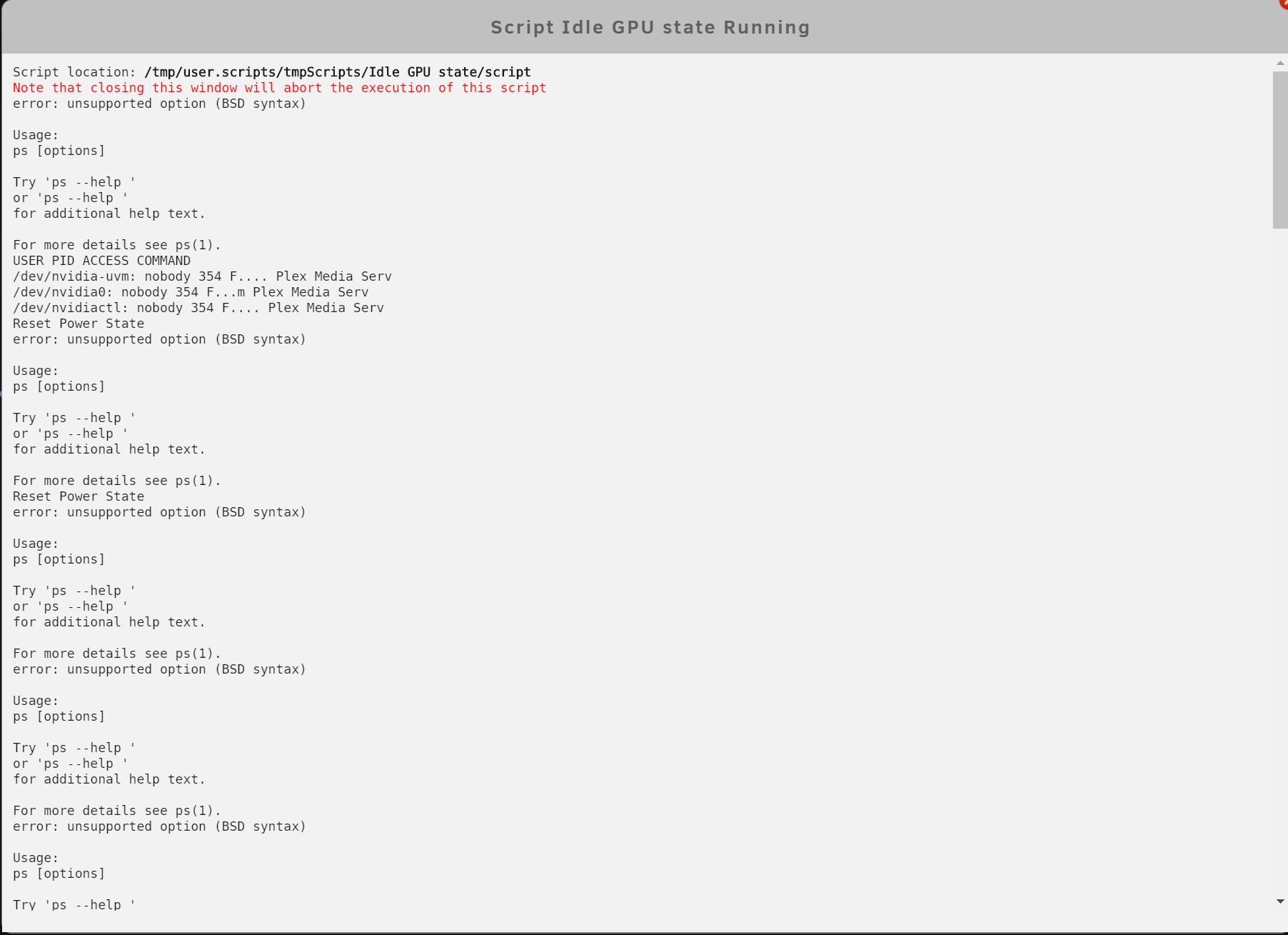

Here is such a script:
#!/bin/bash
while true; do
cur_pstate=$(nvidia-smi --query-gpu=pstate --format=csv,noheader)
running_processes=$(ps --no-headers "$(nvidia-smi |tail -n +16 | head -n -1 | sed 's/\s\s*/ /g' | cut -d' ' -f3)" | wc -l) 2>/dev/null
if [[ $cur_pstate = "P0" && $running_processes -eq 0 ]]; then
# if we got here, the card is only running the Xorg process and is in the P0 state, let's fix that.
    fuser -kv /dev/nvidia*
    echo "Reset Power State"
fi
#sleep so we aren't blocking a thread constantly.
sleep 1
done

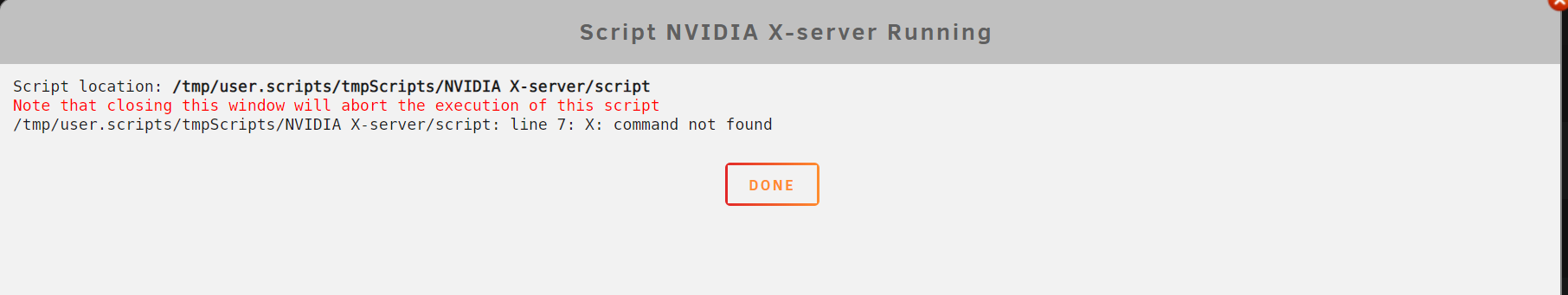

Starting the X server on Unraid does allow one to open nvidia settings; to do this you can use a script like this to start the X server (note, that since chvt and fgconsole aren't available, you will have to switch back to VT7 by pressing Ctrl+Alt+F7):
#!/bin/bash
##This will only work on single GPU systems:
GPUID=$(nvidia-xconfig --query-gpu-info | grep BusID | sed 's/^[^:]*: //')
#Now that we know the PCI BusID of the card we can create the X server with a fake display:
nvidia-xconfig -s -a --allow-empty-initial-configuration --use-display-device=None --virtual=640x480 --busid "$GPUID" -o /dev/stdout | X :99 -config /dev/stdin&
Once you have that server running, you can return to the default unraid GUI and run:
nvidia-settings -c :99
To open nvidia-settings on the card. You could also store an xorg configuration file and use that for the virtual X display, and to set persistent nvidia settings.
The only way I can think of to fix this properly is to figure out why the Plex process is claiming the card and prevent that from happening. I'll look into it some more, but this needs to be fixed properly by Plex/nVidia. The linked thread at the Plex forums has more information.
I may be able to detach the Plex Transcoder process with the wrapper script, making it it's own entity, and then trapping the SIGINT/SIGKILL in the wrapper and using it to kill the transcoder, effectively using the wrapper script to separate the Plex Media Server process from the Plex Transcoder process. It's pretty kludgy, but might work.
Oh Boy:
We're in idle P-State while transcoding territory!
Hi, thanks for your instructions!
If possible can you please provide more help on the scripts running. I have RTX 2070 and have this problem with p0 state stuck. I use both latest versions for Unraid Nvidia and Plex docker. Transcoding works. fuser -kv /dev/nvidia* helps to change to p8 state but only temporary. I tried to run the scrips using the CA User scripos plugin but get errors. Here are the screens. What do I do wrongly?
Nothing - I never got this fully working.
I haven't had much time to look at it lately and I was kind of stuck sicne I couldn't justify using fuser -kv as a solution since it would kill other processes besides just Plex. Ultimately, the permanent solution needs to come from Plex.
EDIT:
This script, should work to kill the processes that need to be killed. You can probably add a call to it in a wrapper for the Plex Transcoder, and it would kill any offending processes as long as no transcodes were already keeping the priority locked.
You could also just run it on a schedule and it would probably curb the issue a little bit:
https://forums.plex.tv/t/stuck-in-p-state-p0-after-transcode-finished-on-nvidia/387685/43
Edited by Xaero
EDIT:
Thanks for explanations! Will look at the Plex forum then. As for the script- I get some BSD syntax error. Cannot find any solution in Google for it. Maybe I lack some module or library that does not let the scrip work?

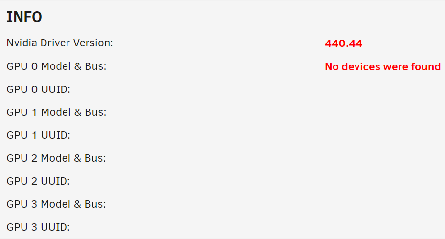

Hello,
I have been using this plugin for a while now, and it's always worked great until unRaid 6.8.0. I want to upgrade to 6.8.2, however when I open the plugin, it just sits at "Updating Available Builds" and never progresses.
unraid-syslog-20200216-2053.zip
Edited by guyonphone
2 hours ago, guyonphone said:
Hello,
piHole on your network?
Not sure if I have been lucky so far but after posting my question about being able to boot headless with my P2000 GPU, I have been lucky 4 times in a row starting last night. I mentioned that I was using unraid 6.8.2  but I didn't say that I just updated to it. since the update I re-installed the plugin and so far it has been working. nock on wood but maybe the update fixed it... last night a parity check kicked off so im waiting for that to finish before I attempt another headless reboot. will update you if it continues to behave.
I do have a piHole, and I did see some others having issues with that, but...
  1. I checked the query log, and refreshed after clicking on the plugin, and don't see the piHole blocking anything from "*digitalopenspaces.com".
