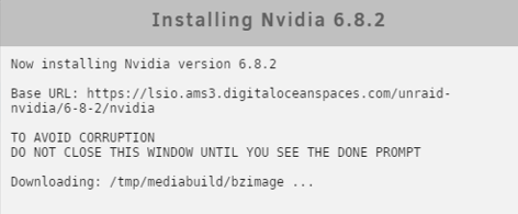

I'm having a problem loading the builds to install.  The last version i was able to install was 6.8.0.  I tried to update to 6.8.2 about 2 weeks ago but it won't even find the builds.  It just hangs on the screen that says updating available builds.

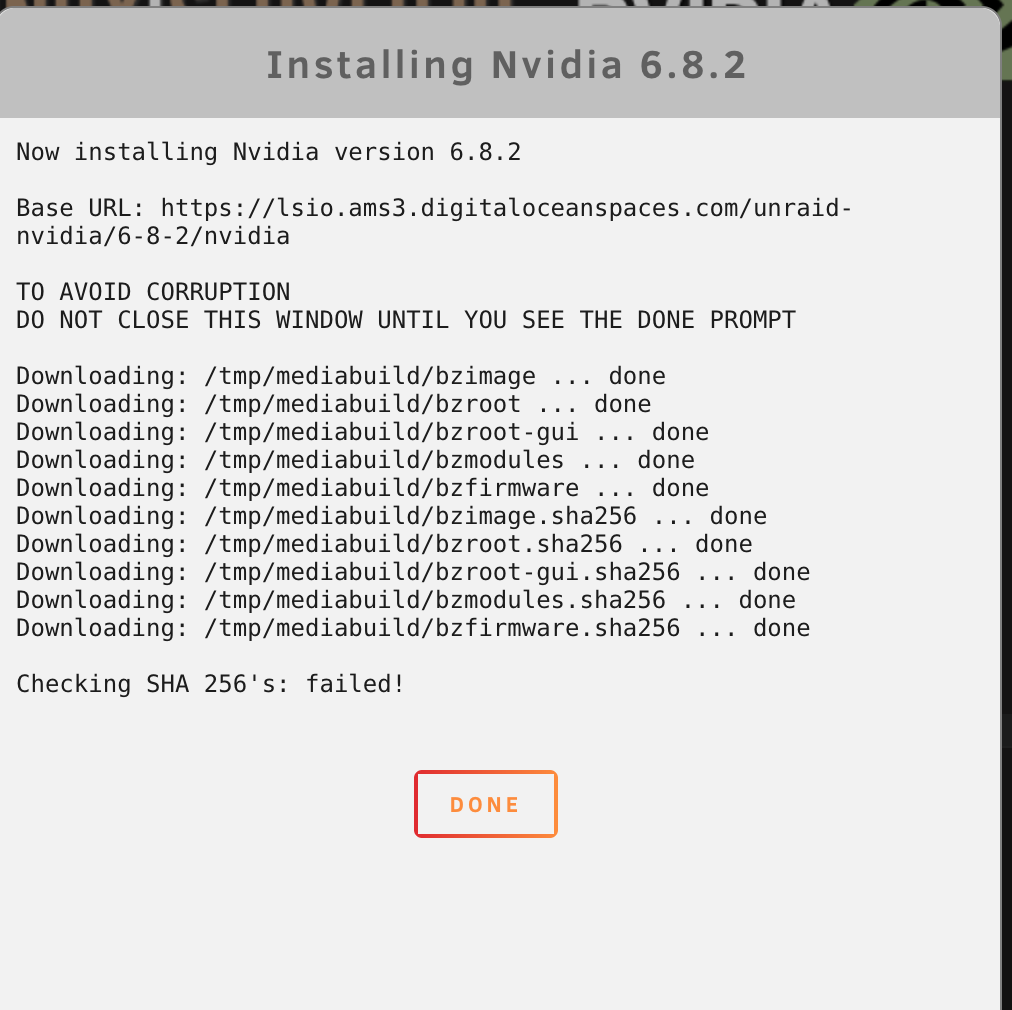

Downloading 6.8.2 right now. Painfully slow.
Failed.
Edited by jcarroll
