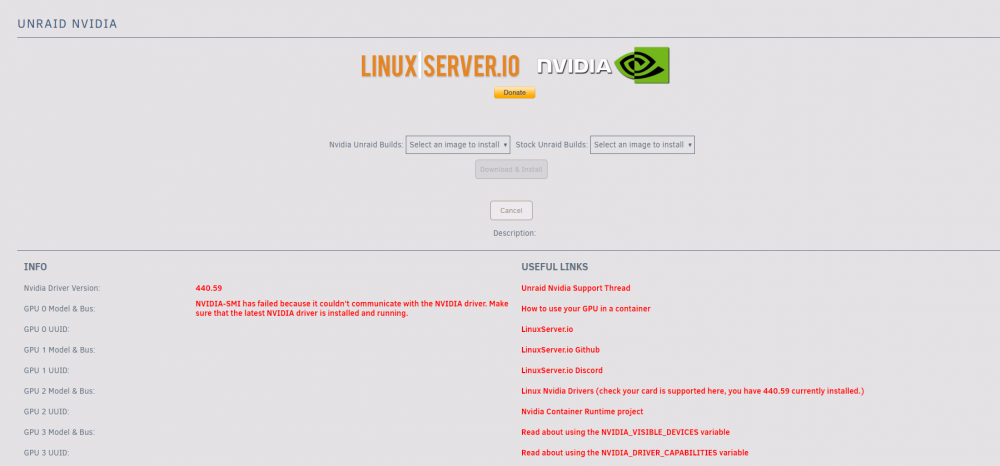

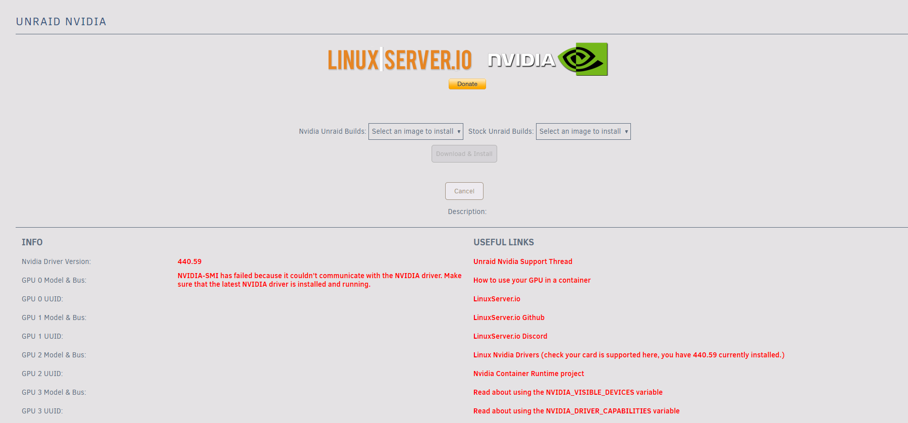

Here is the error i keep getting.  Still can't figure it out.
Have you installed Nvidia unraid already? Not just the plugin but the modified OS?
The plugin is how the modified OS gets installed. The plugin has no other purpose.
Yes I installed the modified OS with nvidia...
