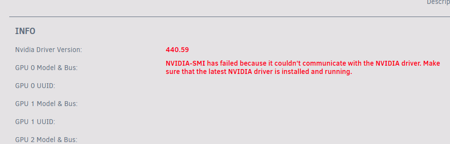

Any ideas how to start debugging an issue I'm having where the GPU just disappears?
Basic Scenario
- LinuxServer.io - Plex using GPU HW Encoding
- Unraid Nvidia Plugin (for 6.8.3)
- Brand new Asus 1660 Super (power led is white indicating all is well)
- GPU Statistics Plugin
Initially I had the GPU setup and encoding in Plex within minutes, having followed all the nice guides on here.
The issue is that every day or so the GPU will just disappear (the webui Dashboard GPU Stats has no numbers, just '/' against each stat).
Running nvidia-smi in a terminal gives me:
"Unable to determine the device handle for GPU 0000:09:00.0: Unknown Error"
The GPU itself has the fans at max as if it's crashed, I have to reboot the system where it then works again for a day or so.
I was checking remotely this morning, and GPU Stats was showing sensible numbers until around 10:30 this morning, but as can be seen in the syslog, it gets spammed before/after this time with:
Apr 27 10:50:10 DIG-NAS-UR001 kernel: resource sanity check: requesting [mem 0x000c0000-0x000fffff], which spans more than PCI Bus 0000:00 [mem 0x000c0000-0x000dffff window]
Apr 27 10:50:10 DIG-NAS-UR001 kernel: caller _nv000908rm+0x1bf/0x1f0 [nvidia] mapping multiple BARs
(hundreds of entries)
and once the card's disappeared, I get a small number of entries:
Apr 27 14:21:17 DIG-NAS-UR001 kernel: NVRM: GPU 0000:09:00.0: request_irq() failed (-22)
I just don't know where to start, I have grabbed the diagnostics just in case it's useful (will upload) but just want to get advice on where to start/if anyone can help.
The GPU with PLEX is working fantastically (when it works) I can transcode my recently ripped UHD movies and HW encode to 1080p/720p with no issues, so would love to get this working 'full time'.. :)
Thanks for any help!
edit - just to confirm, a remote 'restart' of unraid gets it going again.
Edited by Snubbers
I'm kinda seeing a trend here. Most if not all of the people experiencing these issues are also using the gpu stats plugin. Did you try without it?
That's a very good observation, I'll uninstall that plugin, reboot to ensure it's 'clean' and then report back! :)
