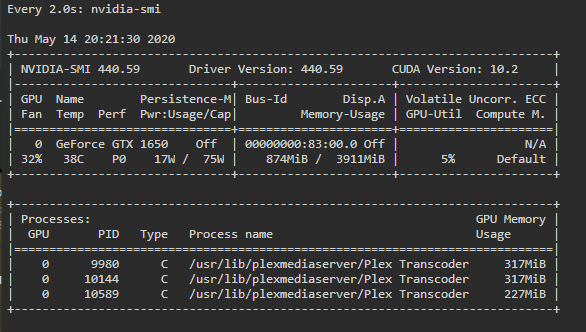

So I installed my new gpu in to my Unraid server (GTX 1650), installed your plugin, and configured Plex to use my gpu. I didn't hack the driver just installed the one your plugin uses but I was still able to go over the 2 stream limit. Did I miss something? I thought you could only have 2 streams.
Nvidia upped the limit to 3 due to Covid-19. Not sure if it's just for a limited time or permanent.
