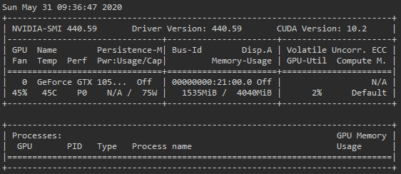

Wondering if anyone has any idea why my transcodes are not showing up under nvidia-smi? It goes from No running processes found to empty. I've verified that I see the GPU utilization increases and Plex is reporting it as hardware transcoding.
Are you checking in the container or unraid?
  • Replies 2.5k
  • Views 661.9k
No matter what I do, when I go to transcoder I am not seeing hardware acceleration option there? Any help would be appreciated.    Using a 750ti
Was looking in the Docker image but I tried in the Unraid console and all good! Thanks!

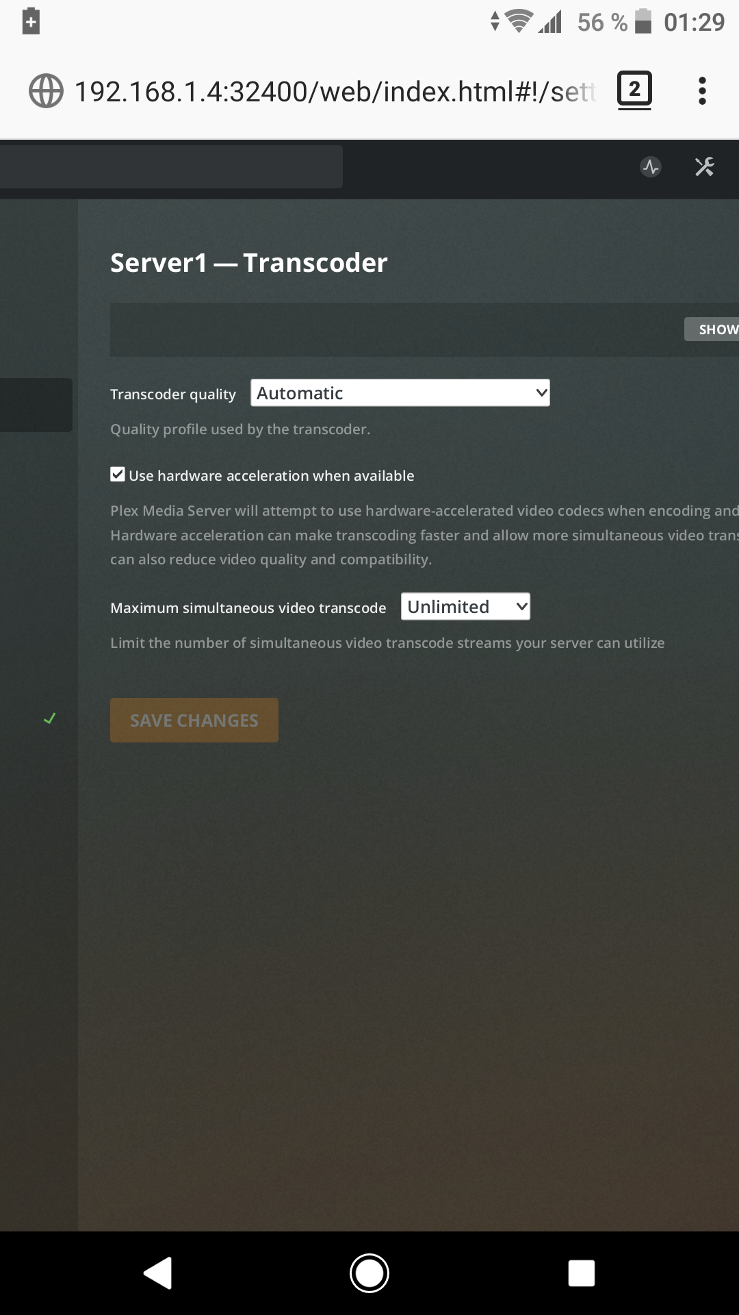

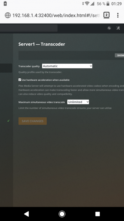

There are no options in this plugin.
You are probably talking about an application, but since you don't mention which, it's hard to help.
Edited by saarg
Sorry. Yes, I meant in Plex itself. I've done whats mentioned in OP, but for some reason the actual option to enable HW decoding/encoding is not showing in Plex transcoder settings
This option is not there? You need plexpass for hardware acceleration.
I didnt have plex pass! That solved it. Thank you!
