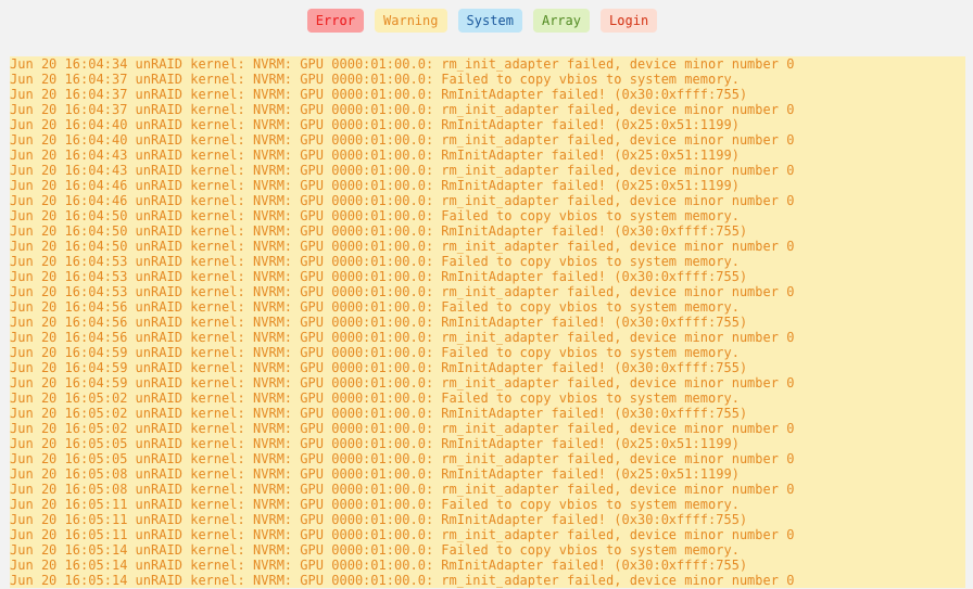

I installed a new GPU recently into my unraid server, and I have been getting hundreds of these errors in the system log:
NVRM: GPU - RmInitAdapter failed!
NVRM: GPU - rm_init_adapter failed, device minor number 0
NVRM: GPU - Failed to copy vbios to system memory
New GPU is a GTX 1660Ti
Running Nvidia UnRaid 6.8.3 with Nvidia 440.59 drivers
I was not having any of these errors with my previous GPU, and I do not have any issues with my new GPU in another two machines when I tested
From what I have been able to see during troubleshooting, is the GPU keeps going online and offline, and as per the video it seems to be when the cached memory in unraid gets all used up, due to file transfers happening. Perhaps there is a tunable of some sort to prevent all the memory from getting used?
I did a screen capture when it was happening, its boring AF but it does show the device going offline and online when the cached memory goes up and down. Keep an eye on the memory usage and the green available sliver at the top.
There seems to be a number of other posts about this, but can't really see that its been resolved.
Any help or suggestions would be appreciated

Jun 30 20:13:21 Tower kernel: ? _raw_spin_unlock_irqrestore+0xd/0xe
Jun 30 20:13:21 Tower kernel: ? _nv000901rm+0x1200/0x1cc0 [nvidia]
Jun 30 20:13:21 Tower kernel: ? rm_init_adapter+0xd5/0xe0 [nvidia]
Jun 30 20:13:21 Tower kernel: ? nv_open_device+0x434/0x648 [nvidia]
Jun 30 20:13:21 Tower kernel: ? nvidia_open+0x2a1/0x41a [nvidia]
Jun 30 20:13:21 Tower kernel: ? nvidia_frontend_open+0x62/0x8d [nvidia]
Jun 30 20:13:21 Tower kernel: ? chrdev_open+0x150/0x187
Jun 30 20:13:21 Tower kernel: ? cdev_put+0x19/0x19
Jun 30 20:13:21 Tower kernel: ? do_dentry_open+0x181/0x296
Jun 30 20:13:21 Tower kernel: ? path_openat+0x85a/0x933
Jun 30 20:13:21 Tower kernel: ? do_filp_open+0x4c/0xa9
Jun 30 20:13:21 Tower kernel: ? up_write+0x17/0x24
Jun 30 20:13:21 Tower kernel: ? chown_common.isra.0+0xec/0x14d
Jun 30 20:13:21 Tower kernel: ? _cond_resched+0x1b/0x1e
Jun 30 20:13:21 Tower kernel: ? slab_pre_alloc_hook+0x2c/0x53
Jun 30 20:13:21 Tower kernel: ? do_sys_openat2+0x6d/0xd9
Jun 30 20:13:21 Tower kernel: ? do_sys_open+0x35/0x4f
Jun 30 20:13:21 Tower kernel: ? do_syscall_64+0x7a/0x87
Jun 30 20:13:21 Tower kernel: ? entry_SYSCALL_64_after_hwframe+0x44/0xa9
Jun 30 20:13:21 Tower kernel: Modules linked in: iptable_nat xt_MASQUERADE nf_nat ip_tables wireguard curve25519_x86_64 libcurve25519_generic libchacha20poly1305 chacha_x86_64 libchacha poly1305_x86_64 ip6_udp_tunnel udp_tunnel libblake2s blake2s_x86_64 libblake2s_generic bonding ixgbe mdio igb i2c_algo_bit nvidia_drm(PO) nvidia_modeset(PO) nvidia(PO) crc32_pclmul intel_rapl_perf intel_uncore aesni_intel glue_helper crypto_simd ghash_clmulni_intel cryptd kvm_intel kvm drm_kms_helper intel_cstate coretemp mxm_wmi drm crct10dif_pclmul intel_powerclamp crc32c_intel sb_edac backlight syscopyarea sysfillrect sysimgblt fb_sys_fops x86_pkg_temp_thermal agpgart ipmi_si ahci input_leds megaraid_sas libahci ipmi_ssif i2c_core led_class wmi acpi_power_meter button acpi_pad [last unloaded: mdio]
Jun 30 20:13:21 Tower kernel: CR2: 0000000000000000
Jun 30 20:13:21 Tower kernel: ---[ end trace 2ead729f5369cb81 ]---
Jun 30 20:13:21 Tower kernel: RIP: 0010:_nv025250rm+0x8/0x40 [nvidia]
Jun 30 20:13:21 Tower kernel: Code: 1f 00 41 8b 4d 08 41 39 0a 4c 89 d6 0f 82 5b fe ff ff e9 69 fe ff ff 90 66 2e 0f 1f 84 00 00 00 00 00 48 83 ec 08 48 8b 42 48 <83> 00 01 c6 42 10 01 e8 5c f4 ff ff 85 c0 74 13 89 c2 be 00 10 57
Jun 30 20:13:21 Tower kernel: RSP: 0018:ffffc90020e97a28 EFLAGS: 00010296
Jun 30 20:13:21 Tower kernel: RAX: 0000000000000000 RBX: 000000000000001c RCX: ffff8893eed22e48
Jun 30 20:13:21 Tower kernel: RDX: ffff8893f6963408 RSI: ffff8893e809e008 RDI: ffff8893eed64008
Jun 30 20:13:21 Tower kernel: RBP: ffff8893eed22e40 R08: ffffffffa0a60930 R09: ffff8893eed229ec
Jun 30 20:13:21 Tower kernel: R10: 0000000000001516 R11: 0000000000000000 R12: ffff8893eed64008
Jun 30 20:13:21 Tower kernel: R13: ffff8893f68d4008 R14: ffff8893eed64008 R15: ffff8893f33e0008
Jun 30 20:13:21 Tower kernel: FS:  000014bad9eb3b80(0000) GS:ffff88942fd00000(0000) knlGS:0000000000000000
Jun 30 20:13:21 Tower kernel: CS:  0010 DS: 0000 ES: 0000 CR0: 0000000080050033
Jun 30 20:13:21 Tower kernel: CR2: 0000000000000000 CR3: 00000013f536c001 CR4: 00000000003606e0
Jun 30 20:13:21 Tower kernel: DR0: 0000000000000000 DR1: 0000000000000000 DR2: 0000000000000000
Jun 30 20:13:21 Tower kernel: DR3: 0000000000000000 DR6: 00000000fffe0ff0 DR7: 0000000000000400
Jun 30 20:13:21 Tower kernel: general protection fault, probably for non-canonical address 0x61ad8614c5ac1b00: 0000 [#2] SMP PTI
Jun 30 20:13:21 Tower kernel: CPU: 20 PID: 5398 Comm: nvidia-smi Tainted: P      D    O      5.7.2-Unraid #1
Jun 30 20:13:21 Tower kernel: Hardware name: Cisco Systems Inc UCSC-C220-M4S/UCSC-C220-M4S, BIOS C220M4.3.0.4g.0.1113190807 11/13/2019
Jun 30 20:13:21 Tower kernel: RIP: 0010:_nv007414rm+0x2c/0x330 [nvidia]
Jun 30 20:13:21 Tower kernel: Code: 48 85 d2 74 07 48 63 47 08 48 01 d0 48 8b 17 48 85 d2 75 16 e9 9d 02 00 00 0f 1f 44 00 00 48 8b 4a 10 48 85 c9 74 17 48 89 ca <48> 39 32 77 ef 0f 83 29 02 00 00 48 8b 4a 18 48 85 c9 75 e9 48 89
Jun 30 20:13:21 Tower kernel: RSP: 0018:ffffc90020e97d40 EFLAGS: 00010006
Jun 30 20:13:21 Tower kernel: RAX: ffffc90020e97dc8 RBX: ffffc90020e97d70 RCX: 61ad8614c5ac1b00
Jun 30 20:13:21 Tower kernel: RDX: 61ad8614c5ac1b00 RSI: 0000000000001516 RDI: ffffffffa177a3d8
Jun 30 20:13:21 Tower kernel: RBP: ffff8893f2c22ff0 R08: 0000000000000001 R09: ffffffffa0588903
Jun 30 20:13:21 Tower kernel: R10: ffff889428430a00 R11: ffff889428430a00 R12: 675f65736e6f7073
Jun 30 20:13:21 Tower kernel: R13: ffff889428433000 R14: ffffffffa1778c20 R15: ffff889428433000
Jun 30 20:13:21 Tower kernel: FS:  0000000000000000(0000) GS:ffff88942fd00000(0000) knlGS:0000000000000000
Jun 30 20:13:21 Tower kernel: CR2: 0000000000000000 CR3: 000000000200a002 CR4: 00000000003606e0
Jun 30 20:13:21 Tower kernel: Call Trace:
Jun 30 20:13:21 Tower kernel: ? _nv036791rm+0xf1/0x1d0 [nvidia]
Jun 30 20:13:21 Tower kernel: ? rm_free_unused_clients+0x41/0xe0 [nvidia]
Jun 30 20:13:21 Tower kernel: ? _raw_spin_lock_irqsave+0x3a/0x66
Jun 30 20:13:21 Tower kernel: ? nvidia_close+0xf3/0x25b [nvidia]
Jun 30 20:13:21 Tower kernel: ? nvidia_frontend_close+0x2c/0x3e [nvidia]
Jun 30 20:13:21 Tower kernel: ? __fput+0x107/0x1d0
Jun 30 20:13:21 Tower kernel: ? task_work_run+0x70/0x81
Jun 30 20:13:21 Tower kernel: ? do_exit+0x3f8/0x8f3
Jun 30 20:13:21 Tower kernel: ? rewind_stack_do_exit+0x17/0x20
Jun 30 20:13:21 Tower kernel: ---[ end trace 2ead729f5369cb82 ]---
Jun 30 20:13:21 Tower kernel: Fixing recursive fault but reboot is needed!
Jun 30 20:13:42 Tower rsyslogd: action 'action-3-builtin:omfwd' resumed (module 'builtin:omfwd') [v8.2002.0 try https://www.rsyslog.com/e/2359 ]
root@Tower:~# lspci -v | grep VGA
07:00.0 VGA compatible controller: NVIDIA Corporation GK106GL [Quadro K4000] (rev a1) (prog-if 00 [VGA controller])
Wondering if anyone has any suggestions on where to start looking for an answer? I have tried my best google-fu and failed before posting here.
Edited by jwiener3
11 minutes ago, jwiener3 said:
unable to log in with ssh, but not through the GUI.
Unable for one way BUT not for the other way. I suspect you meant one of these was working since you said BUT.
Did you mean to say you are able to use ssh?
Yes sorry, typo there. I AM able to login with ssh, not the gui.
