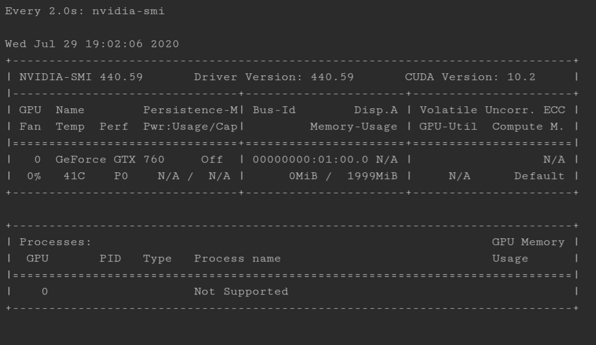

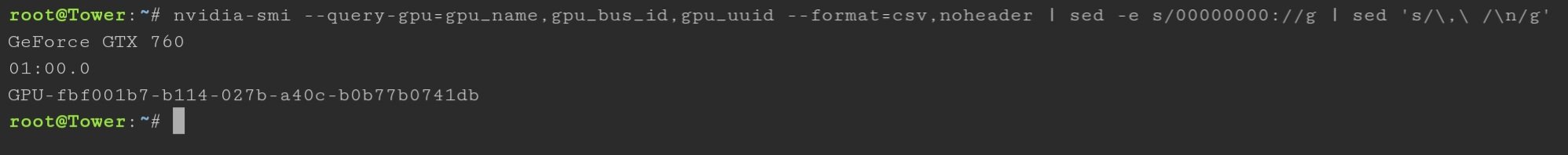

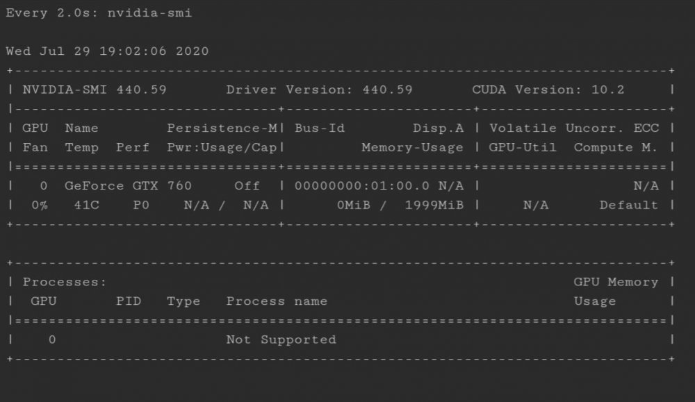

7 hours ago, flamegrilled said:
Card too old or am I doing something wrong?
Do I fall in to the old card category?
According to this chart of compatible cards, yes, the GT 730 is too old.  At least a GTX 1050 is required.
A GT 1030 will support decode only.
Click on the complete list buttons to see all cards.
Edited by Hoopster
  • Replies 2.5k
  • Views 661.9k
@Hoopster is right. If you had a Kepler based 730 instead of a Fermi 730, it would do some NVENC and NVDEC, but your card is a generation too old. Note the GF108 instead of GK208.
Edited by JesterEE

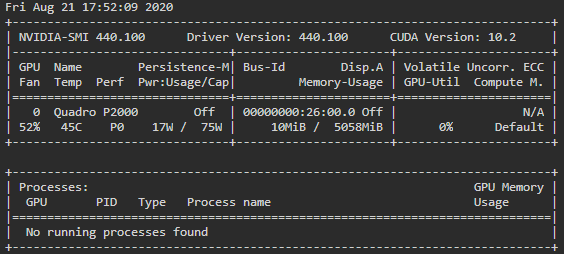

Is anyone able to assist with a P2000 that seems to want to stay in a P0 power state even when no transcoding in occurring?
If I run the command
nvidia-smi --persistence-mode=1
Then restart Plex container, it seems to put the card in P8, then P0 when transcoding but the transcoder crashes after about 5 seconds ending the playback? Therefore I have to put back to
nvidia-smi --persistence-mode=0
and restart Plex container to get transcoding to work stable again. But stuck at P0 always, transcoding or not..
nvidia unRAID6.9.0 b25
It's not a huge issue, but I note I should be able to get idle card usage down from 17W to around 8W.
Edited by SpuddyUK
