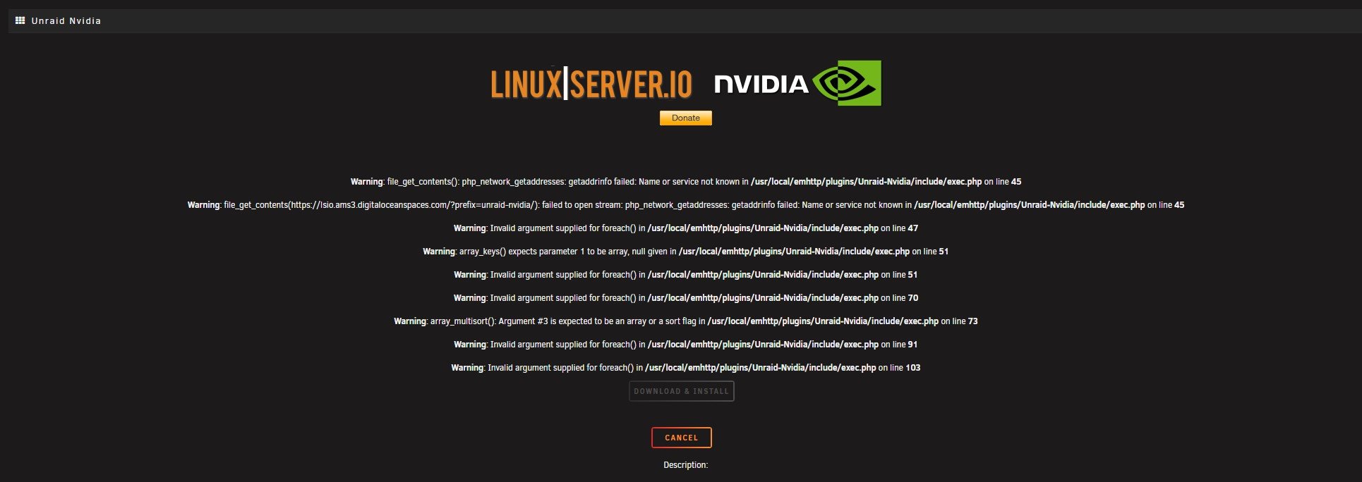

12 hours ago, MadeOfCard said:
OK, I know this has been posted a ton. I've read the past 60+ pages in here.
I've deleted my network.cfg & network-rules.cfg, totally fresh settings. No Pi-Hole or dns filter. I even put my server on the DMZ for a moment to be sure.
Has anyone run into these conditions before?
It resolved itself in the morning. IDK

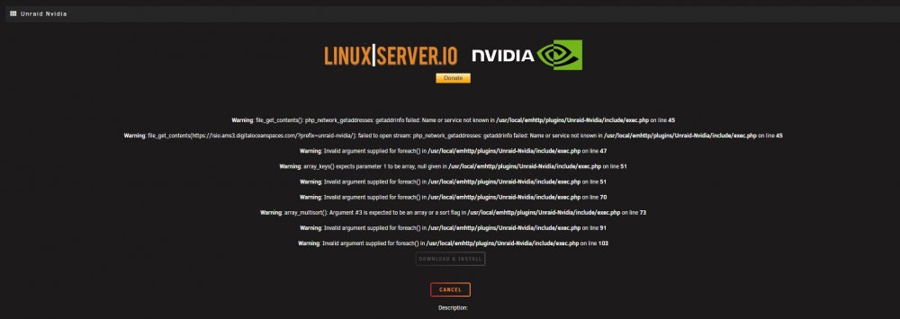

Never, ever. Not even for a moment.
It was a vanilla build that got reformatted again and again. Of course don’t expose your person server to DMZ. I was was just trying to nail down the issue.
It's not only that server. You open up your whole network if the attackers breach your unraid server.
True but in this case it was on its own VLAN. Again, just trying to help debug.

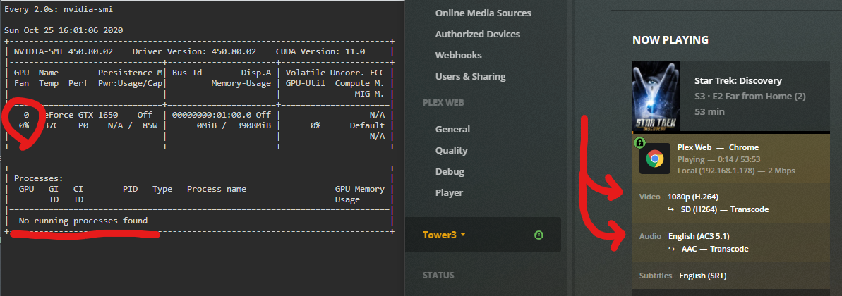

Hi Everyone,
I've recently purchased and installed a Geforce GTX 1650 (after initially setting up the plugin on the existing GeForce GT 1030 - which doesn't 'do' transcoding I found out afterwards).  I've changed the UUID (to the new card), rebooted/powered-off a few times, changed from the Nvidia 6.8.3 to Nvidia 6.9.0 beta 30 builds - all in an effort to get it working (as evidenced by seeing the 'running process' and percentage load changed via nvidia-smi engage when I watched a video that is 'transcoding' in PLEX).  All to no avail - nothing I seem to do is getting the GPU to engage (constantly at 0%).
Is it because I'm running the plexinc/pms-docker rather than the LinuxServer.io version?  If so - that would seem strange but can someone provide a HowTo in switching a PLEX setup (with a few external users) from one to the other?
Is there something I can share (logs, etc) that might help?
Thanks in advance - just trying to get it to work and at wits end.

Did you activate hardware transcoding in plex and do you have plex pass?
Did you follow the first posts for setting up the plex container?
Post your docker run command.
Check box within PLEX Settings --> Transcoder (Disable video stream trancoding - unchechecked, Use hardware acceleration when available - checked, Use hardware-accelerated video encoding - checked))
Yes, PLEX Lifetime pass
Setting up PLEX Container --> added the 'Extra Parameters:  --runtime=nvidia, and two variables (with 'all' and UUID)
docker run command:
root@localhost:# /usr/local/emhttp/plugins/dynamix.docker.manager/scripts/docker run -d --name='PlexMediaServer' --net='host' --privileged=true -e TZ="America/Chicago" -e HOST_OS="Unraid" -e 'PLEX_CLAIM'='Insert Token from https://plex.tv/claim' -e 'PLEX_UID'='99' -e 'PLEX_GID'='100' -e 'VERSION'='latest' -v '/mnt/user/appdata/PlexMediaServer/Library/Application Support/Plex Media Server/Cache/Transcode/':'/transcode':'rw' -v '/mnt/user/appdata/PlexMediaServer/':'/data':'rw' -v '/mnt/user/Recorded_TV-Archive2/Kindle_Movies/':'/media/Kindle_Movies':'rw,slave' -v '/mnt/user/Recorded_TV-Archive2/':'/media/TV_Shows-Tower3':'rw,slave' -v '/mnt/user/Music-Library/':'/media/music_redo':'rw,slave' -v '/mnt/user/Pictures/':'/media/Photos':'rw,slave' -v '/mnt/user/appdata/PlexMediaServer':'/config':'rw' --runtime=nvidia 'plexinc/pms-docker'
8201a247e5df38516ddff953b83e577e35e2391d02d50adf2f4203eaa35b0c3e
Which was the procedure describes by Space Invader via:
If I understand it right...when transcoding the audio & video - it should be activating the GPU?
docker run command:
You have not added the GPU to the container. There are no env variables for the UUID and the compute options. So no wonder it's not working.
Also, why do you volume mount the transcode folder of the appdata to /transcode? It's already in the appdata volume mount.
So strange...I have it listed as a PLEX variable entry?!  I've been also setting up LinuxServer.io and noticed that is was present in the docker run command there....so, progress!
when you say 'compute options' - do you mean the NVIDIA_DRIVER_CAPABILITIES = 'all'  ?  or something else?
the transcode info must be part of PlexInc's setup....should I remove?
Thanks again - this really helps!
Just a FYI and update...after thinking variables weren't being adding/initialized - it was a dumb mistake of not supplying the key value (just naming it the variable name).  duh!
Thanks again for the kindness to hunt down the bug/issue!

19 hours ago, Jarsky said:
I know but just pointing out there may be a larger Linux kernel issue thats affecting Scroopy, given that mine recently stopped working with the same issue.
Mines been working in that setup for a year, and it just stopped working for no reason in the last week...only thing i'd changed up to that point was regular UnRAID and Ubuntu upgrades. The only thing that I can find that appears relevant is entries that say 'tainted kernel'
e.g
Given that it is a tainted kernel, I'm thinking that my next step is to replace the unraid nvidia installation of beta 30 with the stock OS and see if the plugin registers the GPU (which I don't expect it to) and then re-install the unraid nvidia kernel and see if that works.
