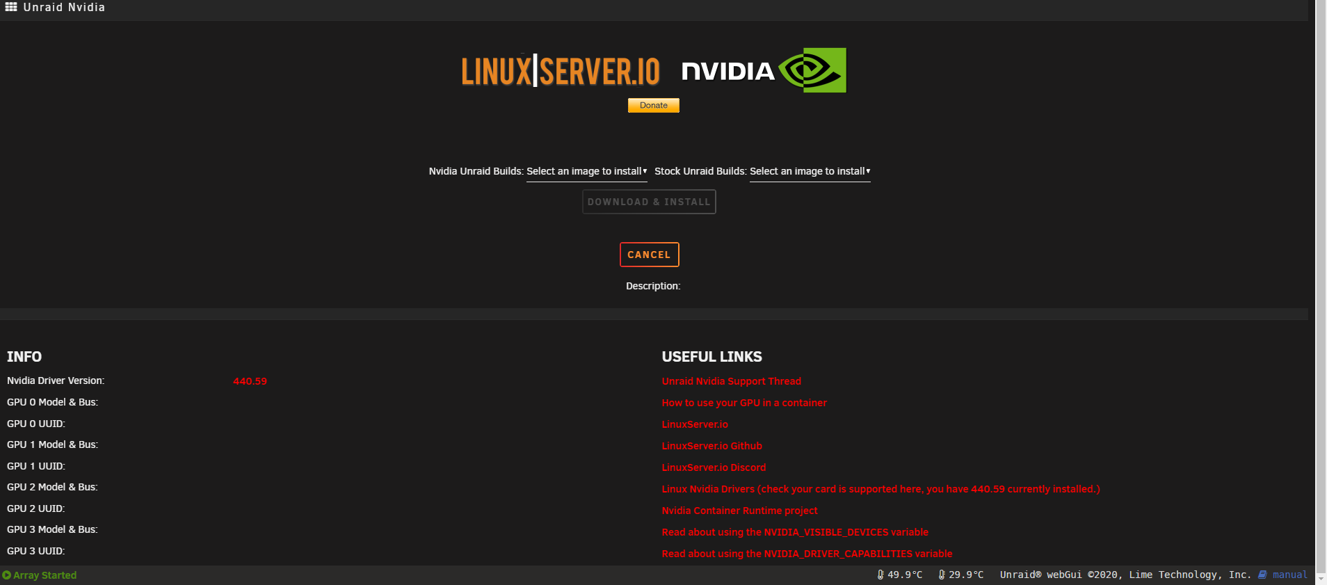

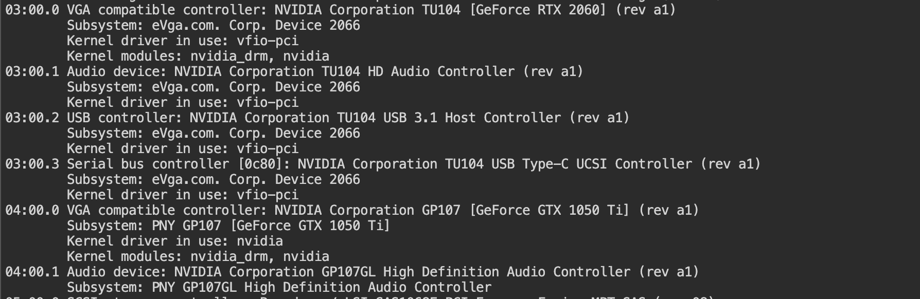

5 hours ago, NullZeroNobody said:
436104700_ScreenShot2020-09-03at12_10_59PM.thumb.png.23f9f692ac9bf4e38e2c21ed60ea3657.png
Thanks Saarg, you are correct. How do I fix this? And if I make any changes, will it affect the VM I have it passed through to? I would shut off the VM when using the GPU for Handbrake Docker encoding, and vice versa.
I'm not sure if the card is released from vfio-pci automatically or you have to force it somehow. You might have to remove it from the VM template and reboot.
I haven't playes around with this, but maybe someone else have and can chime in.
Went into Settings -> VFIO-PCI Config, unchecked the bind for the 2060, and was able to assign it to the handbrake docker and run successfully. If i stop the docker, then the VM with the 2060 attached booted without issue, which was what I was looking for.
Thanks for your help!

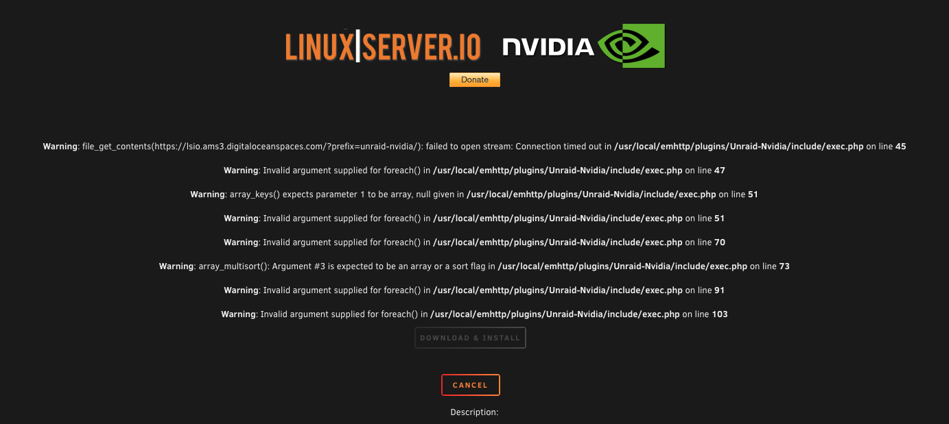

Hi all!  I'm getting this set of errors when going to the Nvida plugin page.  Not sure what has happened, but something is up, as I've never received this set of errors before.
<a href="https://ibb.co/KznBzBb"><img src="https://i.ibb.co/sJ7cJcb/Screen-Shot-2020-09-11-at-7-30-20-AM.png" alt="Screen-Shot-2020-09-11-at-7-30-20-AM" border="0"></a>
Your link didn't work. We prefer attachments instead of links to external sites anyway. Now that you have been approved you should be able to attach the image to your NEXT post.
Sorry about that.  Here's the screen cap of the errors.
Is this something someone else has encountered before, or is this something that is going to have to take a full reset of unRAID to fix?
