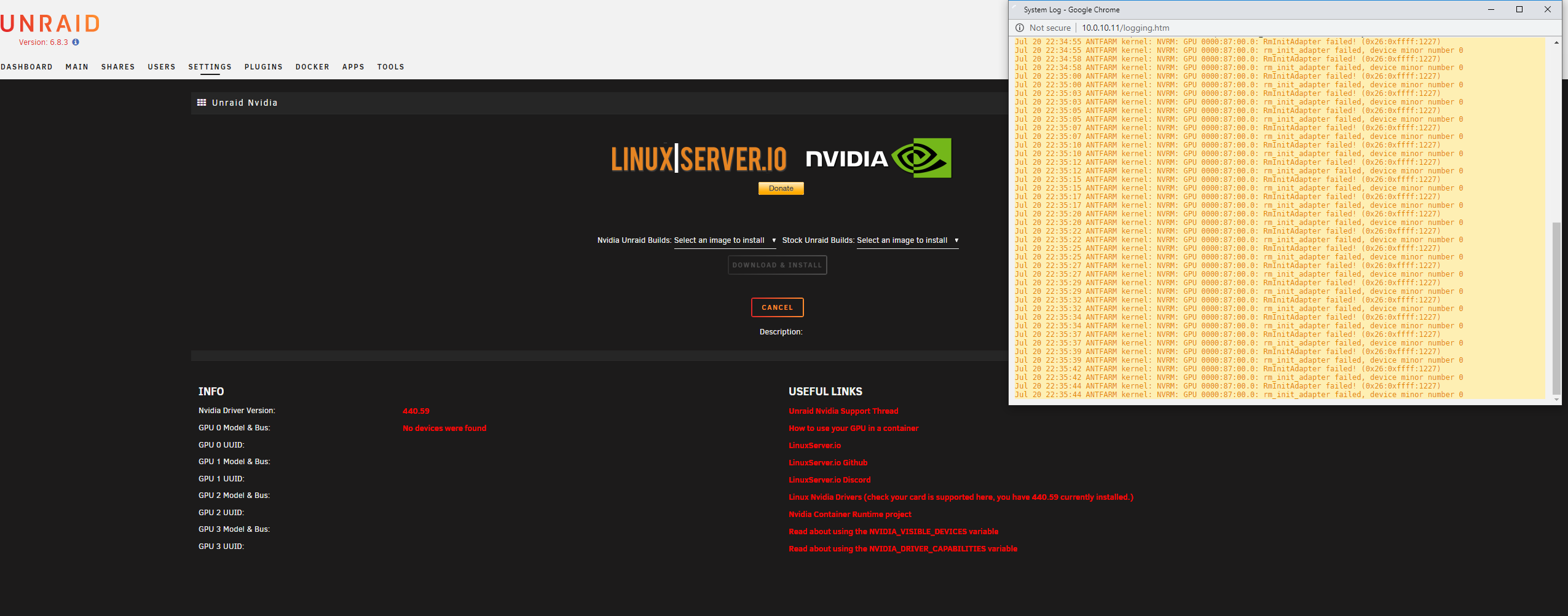

I also have installed a GPU and am receiving these errors, but my issue is only on boot for the PlexInc Docker. Typically I can manually restart the docker and it will boot fine, but it seems CA Backup/Restore might be causing some issue for me or it just makes the issue more prevalent.
Hello,
Hoping I can find some help / guidance after reading through this thread and many others.
I've installed a GTX 1050 Ti in my unRaid server.
Version: 6.8.3
Nvidia Driver Version 440.59
However, I keep receiving the error that "No devices were found", despite seeing that unRaid seems to recognize the device.
"watch nvidia-smi" output is also "No devices were found".
Here is the output of lspci -k:
87:00.0 VGA compatible controller: NVIDIA Corporation GP107 [GeForce GTX 1050 Ti] (rev a1)
        Subsystem: eVga.com. Corp. GP107 [GeForce GTX 1050 Ti]
        Kernel driver in use: nvidia
        Kernel modules: nvidia_drm, nvidia
87:00.1 Audio device: NVIDIA Corporation GP107GL High Definition Audio Controller (rev a1)
        Subsystem: eVga.com. Corp. GP107GL High Definition Audio Controller
And also here are some of the logs that I've been noticing but I can't seem to determine the cause of them.
Any help would be greatly appreciated.
Thanks!
