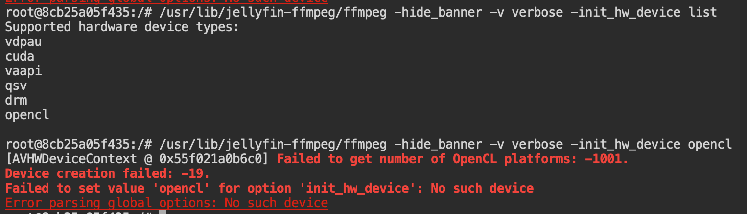

Looking for a little help, I am seeing this within my Jellyfin container. I am passing through the gpu properly, but I enabled a new tone mapping feature that requires OpenCL. This should work right?
[AVHWDeviceContext @ 0x561dcd631340] Failed to get number of OpenCL platforms: -1001.
Device creation failed: -19. Failed to set value 'opencl=ocl:0.0' for option 'init_hw_device': No such device
Error parsing global options: No such device
I don't think the image supports opencl. What feature is that?
This is brand new tone mapping during transcode feature that will be released in the upcoming 10.7.0 release of jellyfin. See PR#3442 . I have been running Jellyfin:unstable and have been waiting to test this out but I guess the image doesn't support OpenCL :(
We'll look into it. It probably just needs some opencl packages added. We have other images that do that.
Can you exec into the container and install the package "ocl-icd-opencl-dev", restart and see if it works?
I installed "ocl-icd-opencl-dev" into the jellyfin container and restarted. Still seeing the same issue.
Ok I got it working, I added the below repo and used aptitude to install "nvidia-opencl-icd"
deb http://deb.debian.org/debian buster-backports main contrib non-free
It's better to use an ubuntu package since we are using an ubuntu base image.

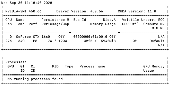

If you have the GPU Plugin installed can you verify that your GPU returns to the lowest P-State (P8) after a transcode?
 See attached screenshot - I believe this confirms P8 state after Transcoding.

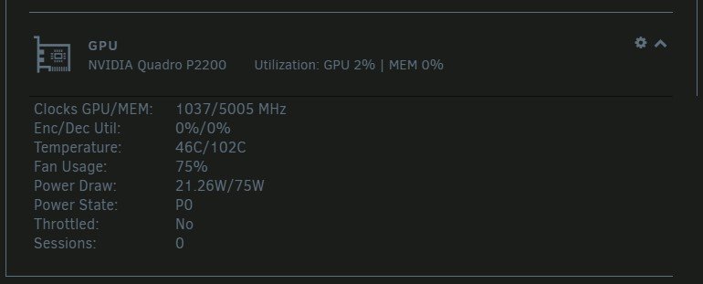

I just installed 6.9.0-beta29 [haven't run any encode / decode yet] and it looks like my card is in the P0 state after booting. I've attached a screen shot from the GPU plugin.
Sorry, really new to this. Is this expected?
UPDATE: Just did a HW transcode w/in Plex. As soon as the transcode stopped, the GPU went to P8. Is there a way I can get the GPU to P8 w/o having to run a transcode?
Edited by tkenn1s
Apparently this is expected whenever you're running headless. You can force your GPU into P8 by:
  1. Enabling a dummy X-server
  2. Installing and running Nvidia's persistenced daemon
  3. Toggling persistence mode using nvidia-smi from /boot/config/go
I opted for #3 since I didn't want to have a bunch of stuff running just to get to a lower power mode. I added the following to the go file and it now boots into power state P8.
# enable nvidia persistence mode
if [ -x /usr/bin/nvidia-smi ]; then
  /usr/bin/nvidia-smi -pm 1
fi

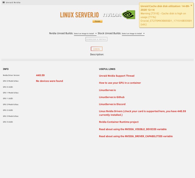

I have some issues getting the Installation to Work on 6.8.3. The installation runs fine but after the Reboot i get a Kernel Panic
kernel panic -not syncing VFS: unable to mount root fs on unknown block(0,0)
the normal Installation runs fine.
Did some research and it got suggested that the RAM could be an Issue, Replaced the Ram but with the same Result.
Ordered now a new Flash Drive that will arrive Tuesday i guess.
--Edit: Fixed the Issue by running the make bootable script after the Installation again. (thanks Stranger on Reddit)
