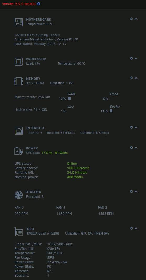

On 10/7/2020 at 11:51 AM, CHBMB said:
v6.9.0 beta30 uploaded
Great version, work very well with the latest Plex server available (v 1.20.2.3402-0fec14d92), good job !
Works perfectly with the Quadro P2200 : gpu is used for both transcoding and decoding...
My Ryzen 2700X also benefits with this upgrade, cooler than with Unraid 6.8.3, and now the idle temp is 10°C less...
Here are the stats from my tiny itx low consumption Ryzen : i've downgraded the bios of the Asus B450 Gaming-ITX/ac to version 1.70 to enable Gpu-passthrough effortlessly and set the TDP of the CPU to 35 in bios.
(note for other users : this bios is just buggy, to modify values you must press F10 to enter boot selection menu then click on enter Setup, directly enter in bios won't work).
Now the power consumption while plex is transcoding is always below 110 Watts (with less than 10 viewers simultaneously), and is about 60 Watts while idle.
Edited by doobyns

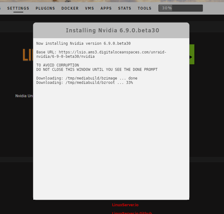

Trying to download the latest drivers after 6.9.0 beta 30 update and the download is frozen at 33%. Any suggestions on how to proceed?
EDIT: Eventually it downloaded and worked.

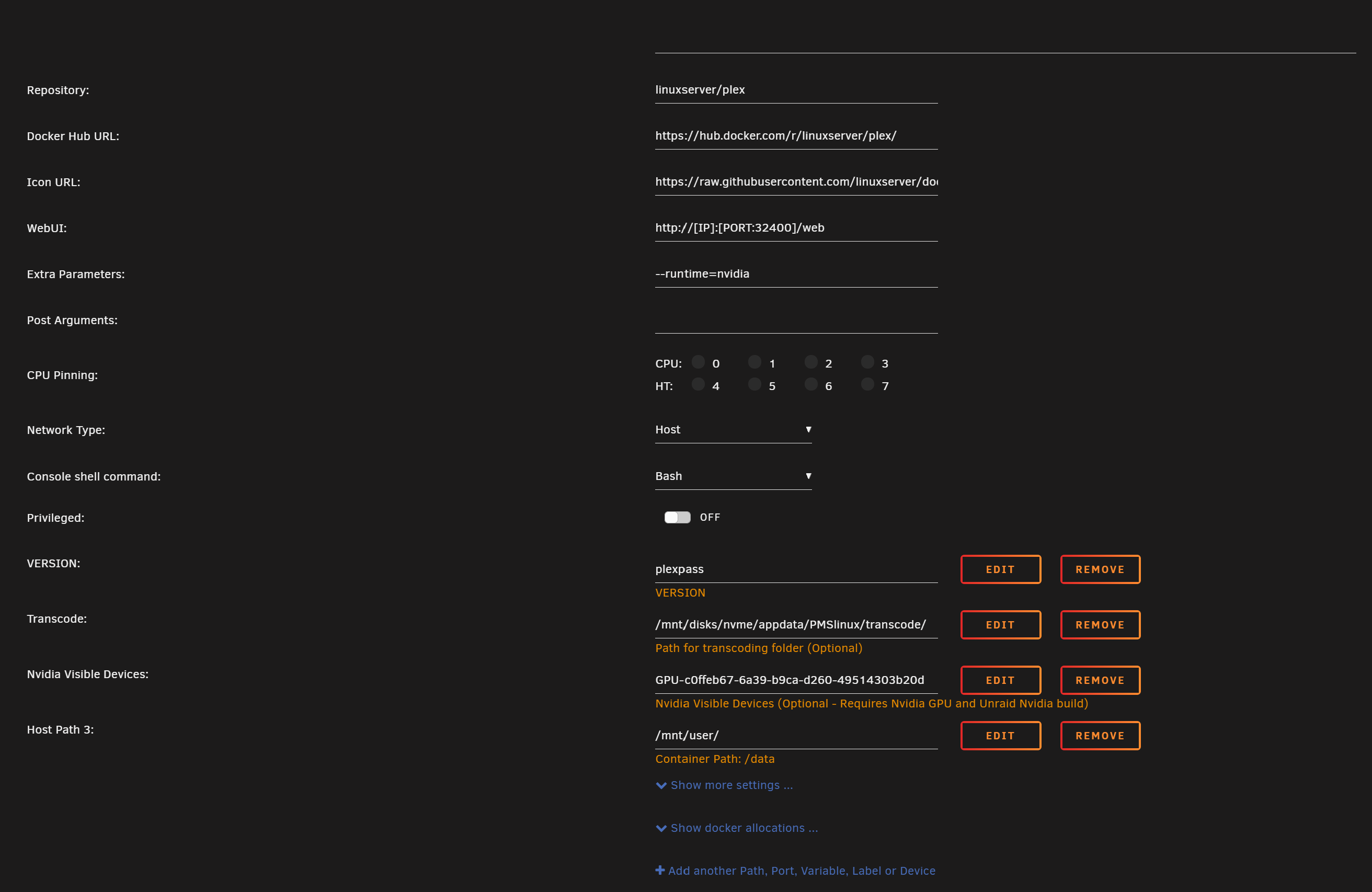

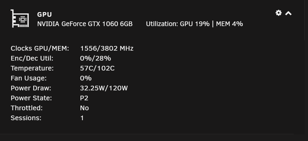

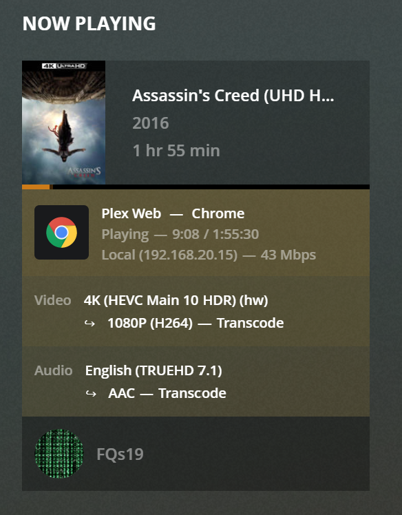

I'm hoping someone could help me get my GTX 1060 to both Encode and Decode with hardware acceleration.
I'm using some left over pc parts just to get started, but they've been working fine.
I have an intel 4790K cpu with a Gigabyte Z97X-UD5H-BK motherboard.
My appdata folder is on an nvme drive under Unassigned Devices.
My transcoding folder is under appdata/PMSlinux folder on that nvme.
I installed the Unraid Nvidia plugin.
Installed the 6.8.3 image.
Switched to the linux server plex docker. I was using the official plexinc docker.
Added the --runtime=nvidia to extra parameters in the Advanced section.
Added my guid to the Nvidia Visible Devices parameter.
I started a movie and transcoded down in resolution, but gpustats and Plex shows only that Decoding is taking place. My cpu is still doing the Encode.
This is much better than no hardware acceleration only, but since Plex finally got around to allowing both Decode and Encode to take place, I would like to take advantage of it.
The GTX1060 does have both decode and encode chips per the matrix.
Hopefully I just missed something silly and it's an easy fix that someone here could spot.
Any help is much appreciated.

I think you should ask this kind of question in the topic for the support for the Linuxserver.io plex server : https://forums.unraid.net/topic/40463-support-linuxserverio-plex-media-server/
I'm using the legacy Plex Media Server docker image from plexinc, i can't help for your version...
try to use plex server from plexinc (latest version) and Nvidia unraid v6.9.0 beta30, i think it will solve all your problems... (i tried differents plex docker images and the less problematic was the plexinc image).
last advice, if you have at least than 16Gb ram and you are mainly using your server for plex, you should set your /transcode path to /tmp.
I will not talk anymore about that...
I'll try that forum.
I first tried using the official PlexInc docker. It did the same thing which is why I switched to the linux plex version.
Thanks for the help.

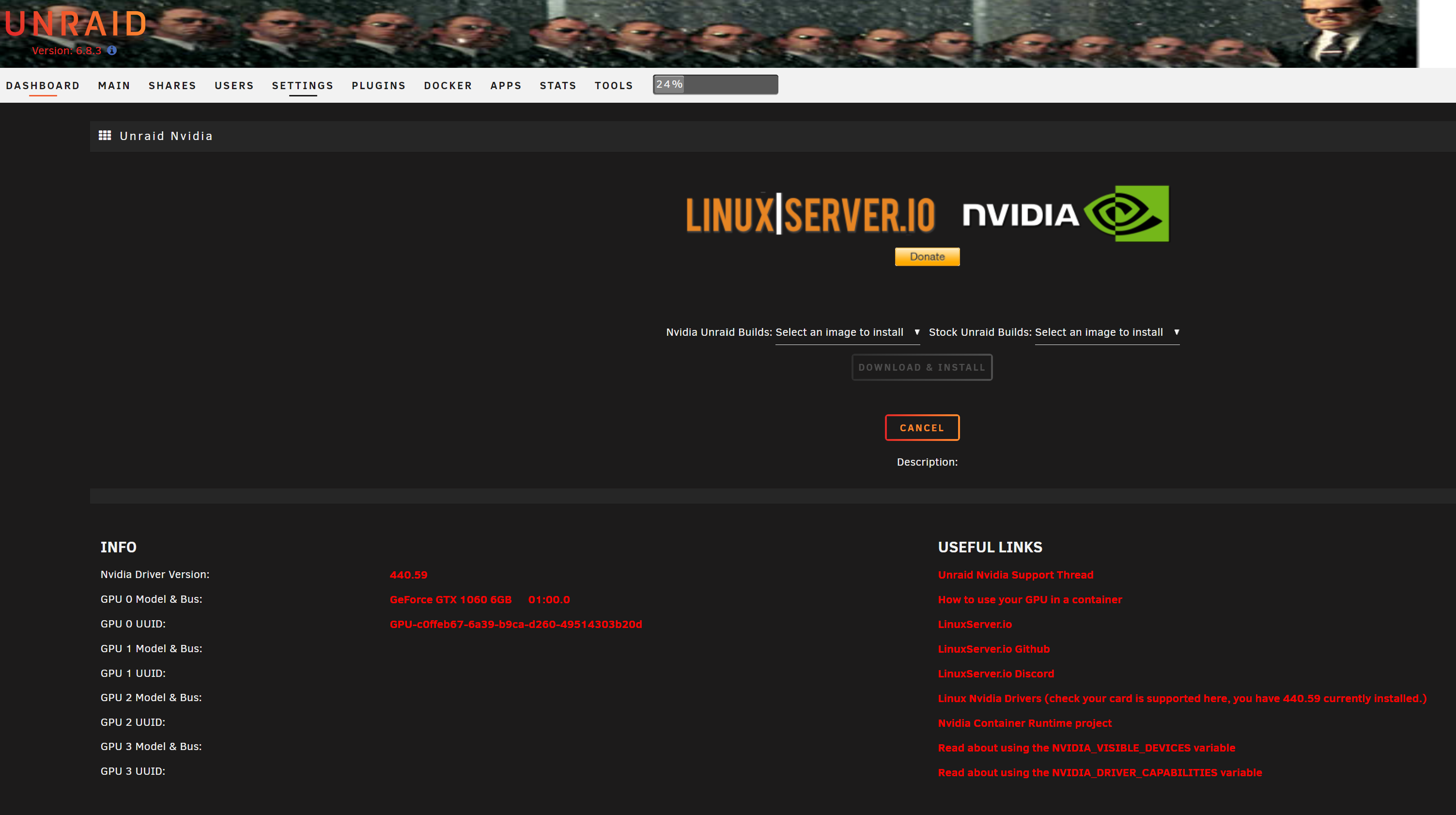

Any chance of getting the driver for unRAID stable (6.8.3) updated from 440 to 450?
[FFMPEG] - Driver does not support the required nvenc API version. Required: 10.0 Found: 9.1
Seems like the latest version of nvenc API requires >450 version of driver:
https://forum.manjaro.org/t/nvidia-nvenc-not-working-with-applications/2202/39
edit: VVV thanks, I was hoping to avoid using a beta, but apart from one plugin being incompatible, it went remarkably smoothly.
Edited by ConnectivIT
My question and yours is answered here :
you can grab the drivers yourself and copy them over to the flash drive or upgrade to the beta.

It's having problems downloading the sha256 files for unraid 6.8.3
Now installing Nvidia version 6.8.3
Base URL: https://lsio.ams3.digitaloceanspaces.com/unraid-nvidia/6-8-3/nvidia
TO AVOID CORRUPTION
DO NOT CLOSE THIS WINDOW UNTIL YOU SEE THE DONE PROMPT
Downloading: /tmp/mediabuild/bzimage ... done
Downloading: /tmp/mediabuild/bzroot ... done
Downloading: /tmp/mediabuild/bzroot-gui ... done
Downloading: /tmp/mediabuild/bzmodules ... done
Downloading: /tmp/mediabuild/bzfirmware ... done
Downloading: /tmp/mediabuild/bzimage.sha256 ...
I left it there for tens of minutes and it doesn't pass this step.
