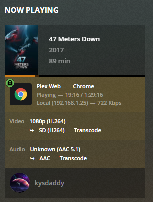

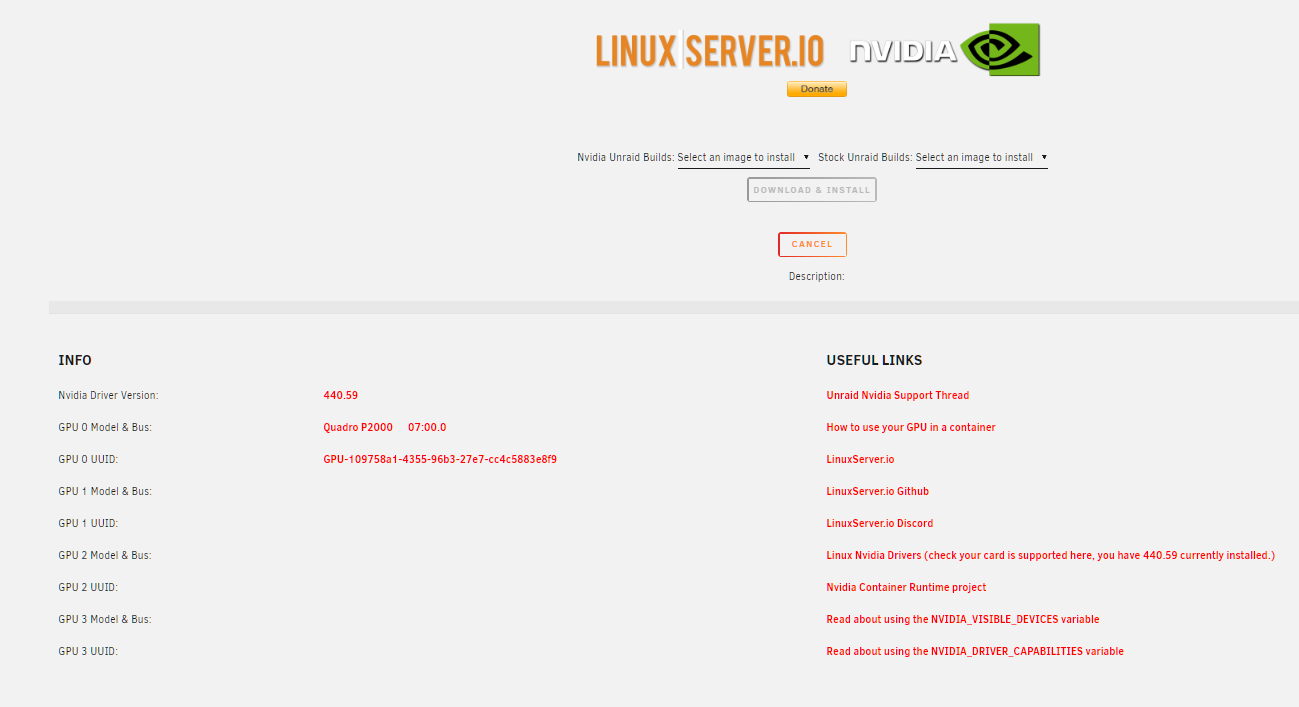

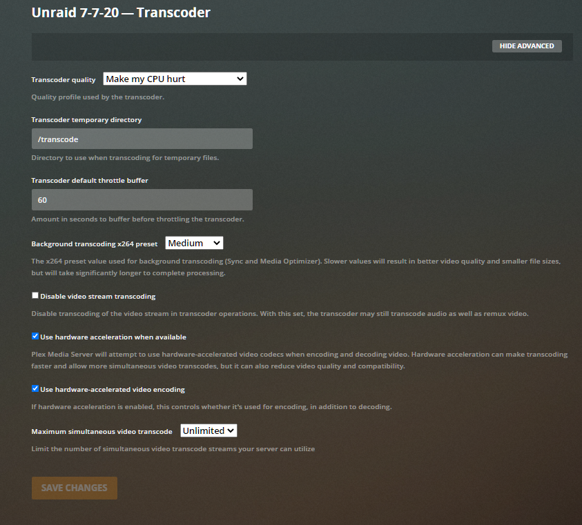

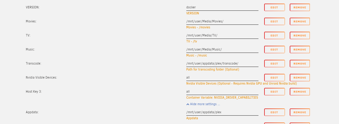

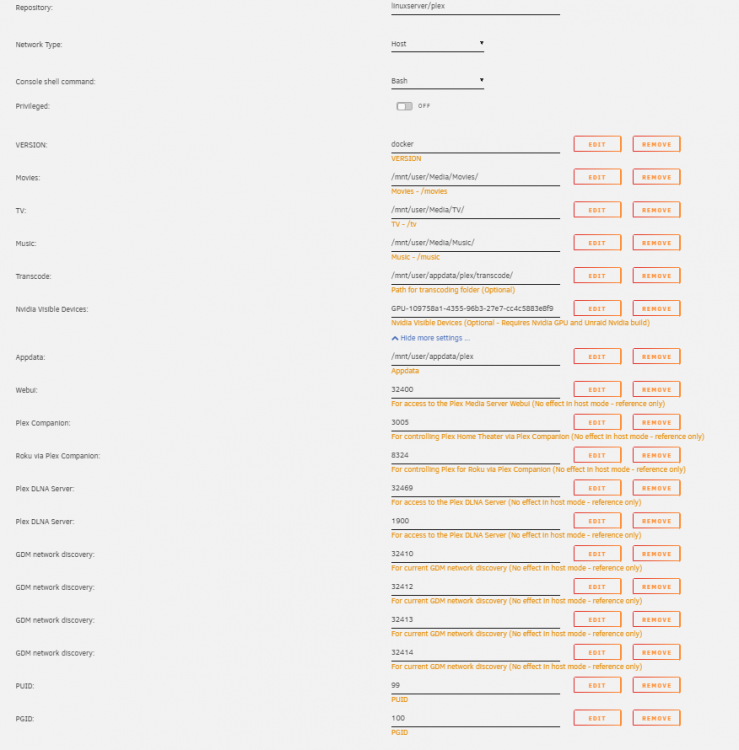

9 hours ago, saarg said:
You do have Plex pass? You didn't answer that question in your last post.
You can try to set Nvidia visible devices to all, and see if it works then.
Which version of unraid are you using?

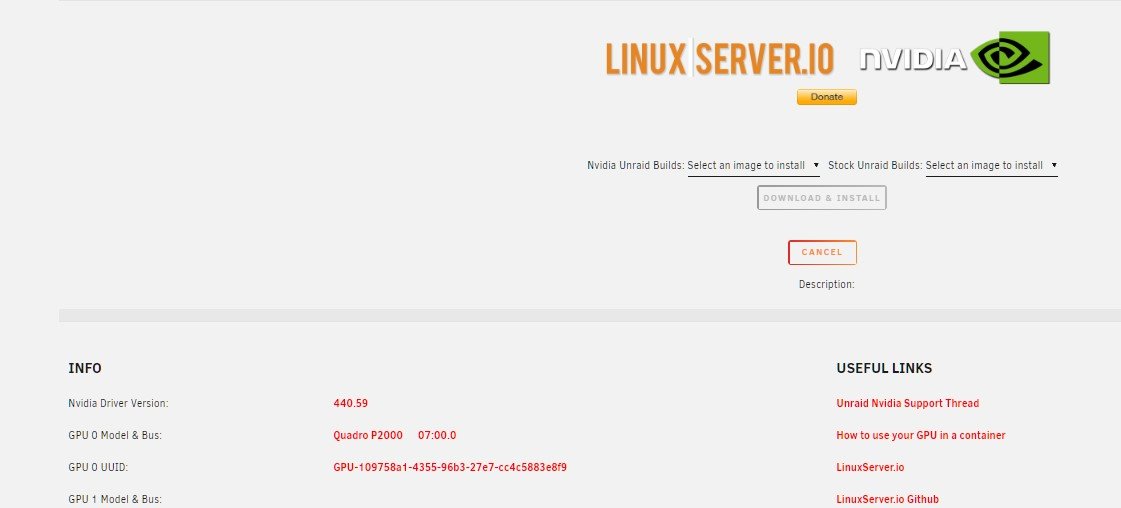

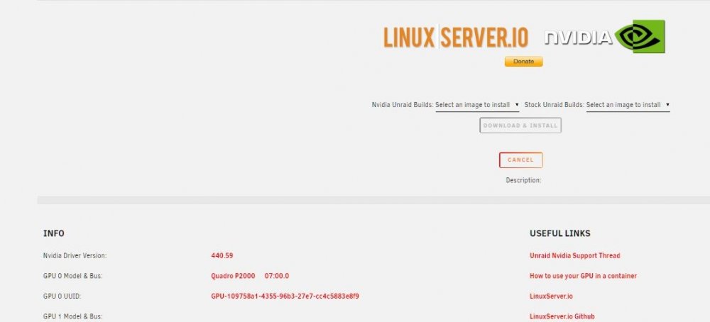

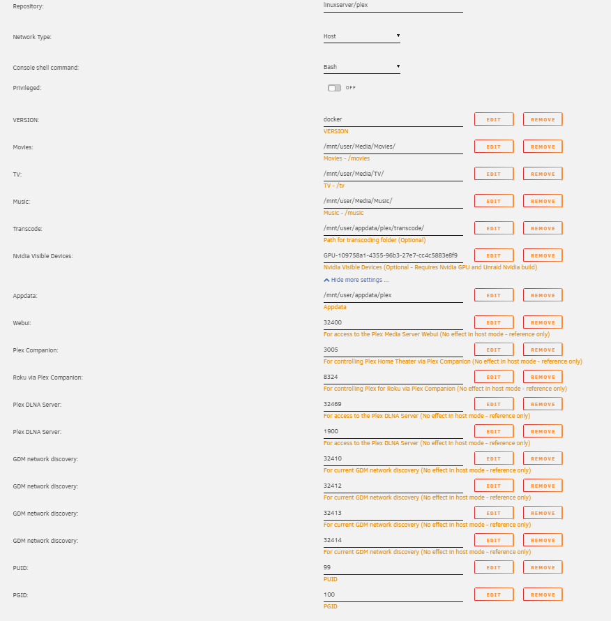

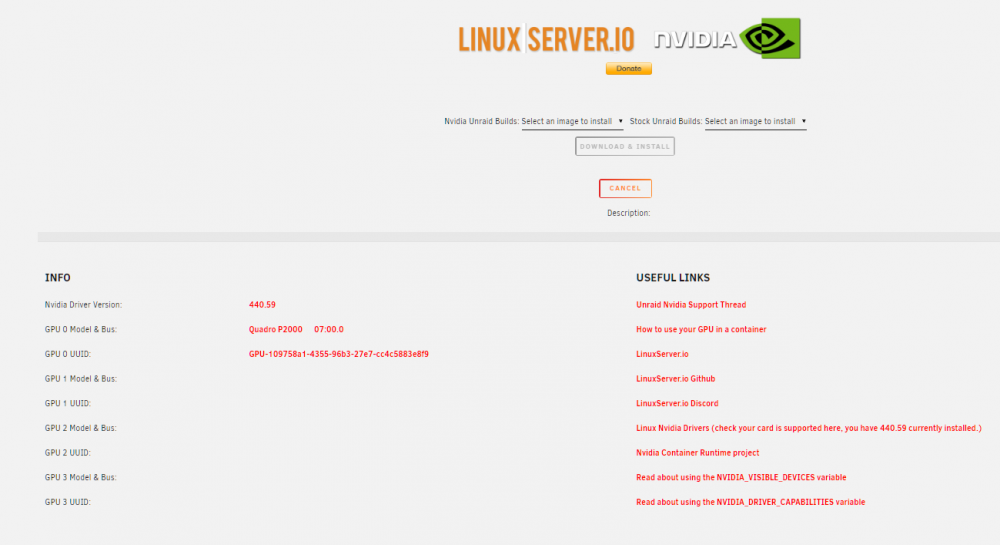

Yes I have plex pass.
I am running 6.8.3 nvidia version
I changed the visible devices from the UUID to all and still does not show Transcode HW
Thanks
image.thumb.png.34fb38ffc3e181e196860f86b8c11d99.pngimage.png.512e16635dab37db60f5b17bfbb71a77.png

Post your diagnostics.
Just double checking that you added the following in the docker setup
--runtime=nvidia
I looked at all your screenshots and I do not see this setting in any of them.
Switch the template to advanced mode and make sure --runtime=nvidia is in the extra parameters
If you could post the docker run command that could also help
Thank you Scottc.
That was it. I set it up the first time when I did Binhex plexpass but neglected to add that veritable in the linuxserver plex docker.
As always with me it was a case of operator malfunction.
Thanks again to all who assisted.
Chas
