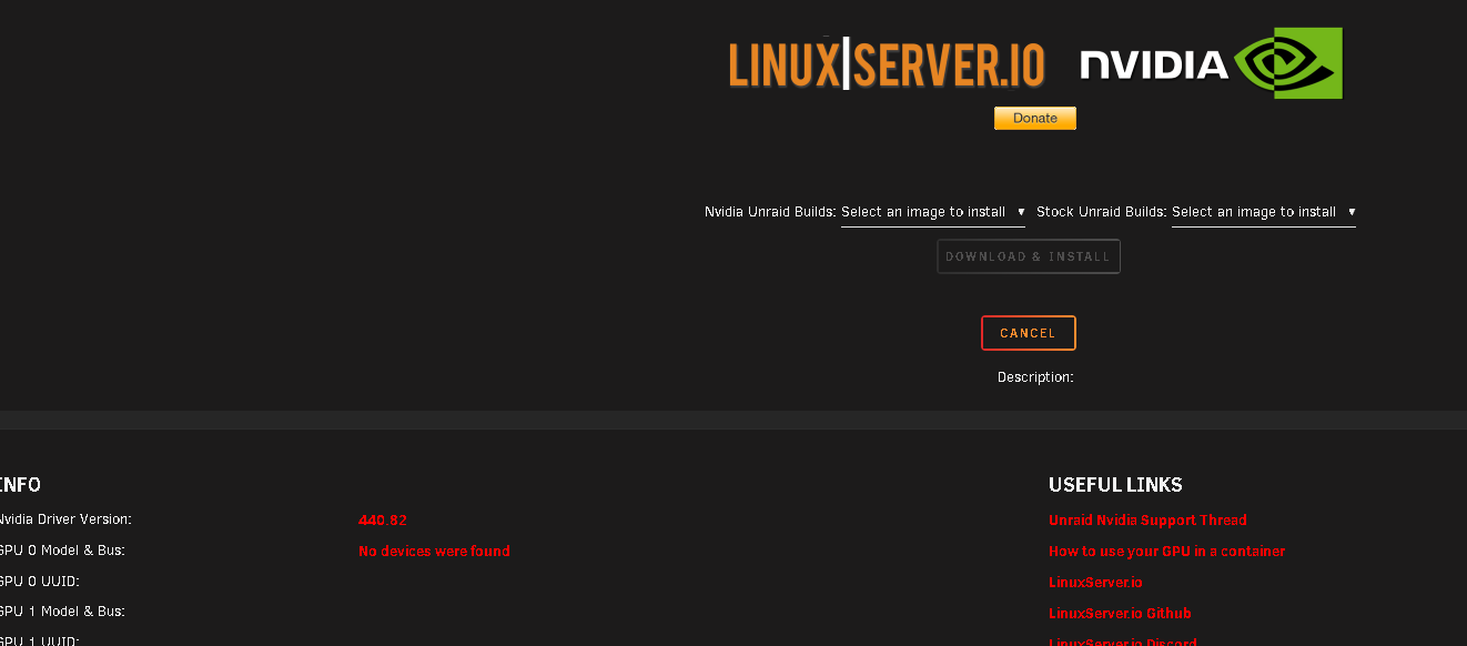

You need to remove the stubbing from the m2000 as the Nvidia drivers are not loaded when you are stubbing the GPU.
How would I do that?
The same way you added it.
If you have chosen the GPU in a VM you have to choose another GPU to remove the stubbing. Then reboot.

I have no vms, I’ve never used it for anything other than only gpu, It’s a used card, do I need to boot a windows system and remove all drivers from it? I only want it for plex transcode.
You have done something to stub the card. Either by editing the syslinux.cfg or using the vfio plugin. You said in an earlier post that you put it in vfio, so reverse what you did.

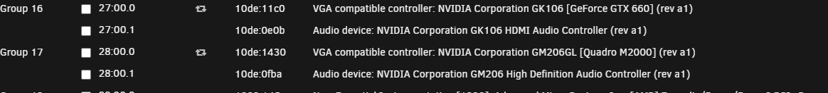

image.thumb.png.c23d2f3e0ac9ab2048ecaa6f89f38447.pngnothing is set, i only downloaded it to try it. but still didnt work.. the 660 shows up just fine.. and i can set it up for plex.. but the m2000 is what i want to use
What did you download?
Kernel driver in use: vfio
The above means that the device have loaded the dummy driver. This prevents the nvidia driver to be loaded. If you don't use any VM's, the vfio module is not loaded. So there is something you have done.
Post the syslinux.cfg file (You can find it when you click the Flash on the Main page), vfio-pci.cfg (In /boot/config/).

4 hours ago, saarg said:
You have the card stubbed there, so remove it and reboot unraid.
Should I remove that entire file?

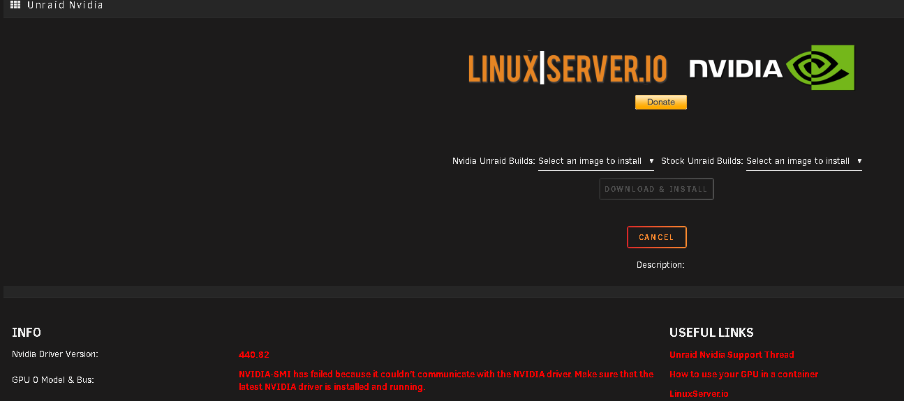

After removing file no change.i rebooted, and used nvidia pluging to reinstall...still only see one card
Edited by cjjermont
You only need to remove the number in the file.
Post the output of lspci -k

1 minute ago, cjjermont said:
The driver is loaded now. Have you tried to remove the othe Nvidia are physically and see if hardware transcoding works in Plex and if it shows up in the plugin? You can probably achieve the same using all instead of the UUID in the variable.
when i set it to all it only gets to 3 transcodes before using the cpu, m2000 can handle way more than that..the 660 not so much...
and removed 660 from system and m2000 still does not show up under nvidia
Edited by cjjermont
What does nvidia-smi show if you run that command from command line? Without the 660 in the computer.
image.png.663f6376c27270f778af9d45e78d7781.pngimage.png.8046f6a72cd868c276e75950a3dac54e.png
