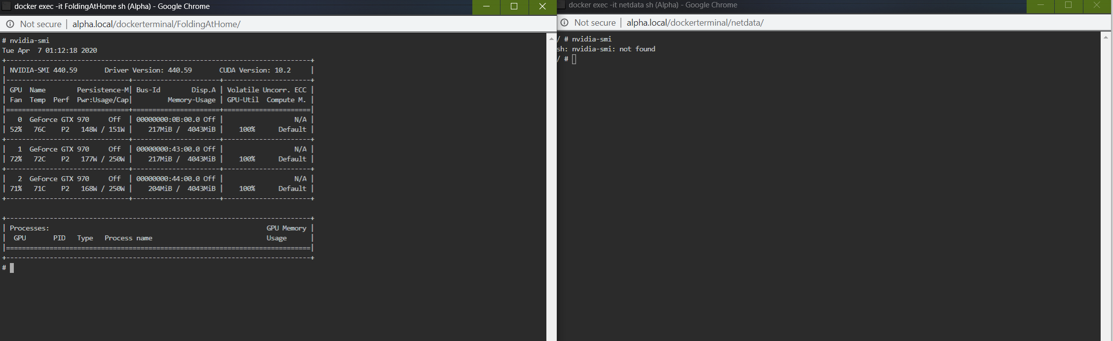

But even with that I cant see nvidia-smi in the docker from the console. I have a folding at home docker and that can see nvidia-smi with no issues but I cant seem to get it to work with the netdata docker. Others have also had this issue with the docker. Are we doing something wrong?
Steps I have tried:
Just one gpu
Uninstalling and reinstalling apps, dockers, plugins,
Passing through individual UUIDs of cards rather than just "all"
Running scrips mentioned by others to make sure the correct config is edited
I even went as far as installing random dockers and putting in the above variable and parameters and nvidia-smi worked in them....

nvidia-smi is provided by the nvidia docker runtime. On your netdata docker are you using --runtime=nvidia in the additional parameters? If not it won't have nvidia-smi.
I did add the --runtime=nvidia and it didnt work. I was able to get it to work with another container the has a glib added.
On 4/7/2020 at 8:44 PM, Markland said:
Guys I posted this on Reddit and got it to work by using a different docker. Linked is the Reddit thread. And what I did:
"I took D34DC3N73R's docker and shoved it in Data-monkey aka roland's template from the CA Hub and tada it works. :D All of my gpus that support nvidia-smi showed up! Now onto custom configs and things. Muahahaha!"
I dont know if everything works but it seems to be!
D34DC3N73R's docker: https://hub.docker.com/r/d34dc3n73r/netdata-glibc
Interesting, admittedly I don't use the docker myself, the glibc dependency must have either changed or been removed so it doesn't work anymore. Good that you got it working!

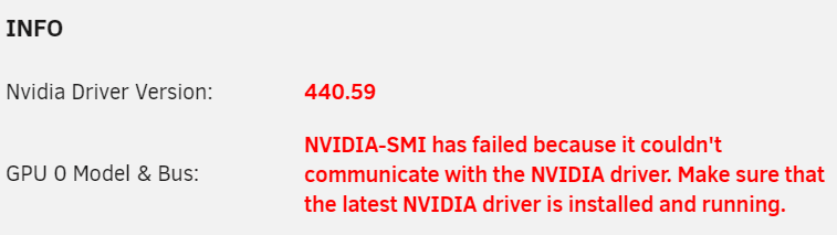

On 4/2/2020 at 11:37 PM, soloandy said:
I'm trying to install nVidia Unraid Builds 6.8.3.
But I got this message after the installation: NVIDIA-SMI has failed because it couldn't communicate with the NVIDIA driver. Make sure that the latest NVIDIA driver is installed and running.

I have a nVidia GT710 installed (should be supported), and it has been recognized by the system.
1674624195_2020-04-0221_34_21-login-froot(MediaServer).png.3ba32c47ba6c12412a2aec26a00e9932.png
Does anyone have the same issue, how to solve this problem? Thanks!
I'm having the same issue with nVidia Unraid 6.8.3, driver version 440.59. I'm using a gtx 1050 super, however.
It worked ok immediately after installing the build, however I have since passed it through to a VM. Upon stopping the VM, nvidia-smi failed. Rebooting Unraid still sees nvidia-smi fail, even before passing through to VM.
If you are passing the card through to a VM why do you need the Nvidia build in the first place as it is the drivers in the VM that control the card.   I thought the main use case for the Nvidia build was to be able to use hardware transcoding in docker containers?   Your description of your symptoms suggest that the card is not properly resetting when closing down the VM and it takes a power cycle to achieve that.
Hi itimpi,
The intent is to use a secondary gpu for transcoding in emby, however the 1050 super is just for game streaming. Whilst not running a VM, the nvidia drivers allow for the card to enter a low power state. Is this not correct?
I have power cycled the machine and still received the nvidia-smi failed message prior to starting VM.
Hi itimpi,
Just had a look at VFIO-PCI Config, looked like the GPU was being bound to the vfio-pci driver. Unbound, restarted, and everything seems to be working fine again.
That makes sense as the binding would hide the card from the Unraid Linux level  It does sound as if might affect your ability to use the card in a VM :(
