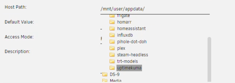

Hi Yes when I said by default, you will have to know the path location. Clicking in the web gui will go to the folder. But you must maintain file name and path.
The container path must be: /docker-entrypoint-initdb.d/init-mongo.js
and the 1 for 1 file path must be
/mnt/user/appdata/unifi-controler/mongodb/init-mongo.js
^ Except it's where your init-mongo.js file is located.
But default unraid if i click the prompts will only do folders.
So I would get /mnt/user/appdata/unifi-controler/mongodb/
When I need to specify the file name. to complete the 1 for 1 file passing

@wgstarks & @bmartino1,
Thanks for your detailed answers!
So, if I understand correctly: First create the mongo-init.js file in a location of my choosing and fil it whit the correct content as stated in the github page, After this deploy the MongoDB container with the correct path configured & manually adding the file name to the host path parameter?
I do not need to set certain access rights? The defaults from Unraid are sufficient?
Add the full path. I posted a screenshot of mine just a couple of posts back.

Thanks for your help guys!
Creating the path & mongo-init.js file first & then deploying the MongoDB container with added path did the trick!
The new Unifi controller is up and running here now. (Restoring from backup was also no issue)

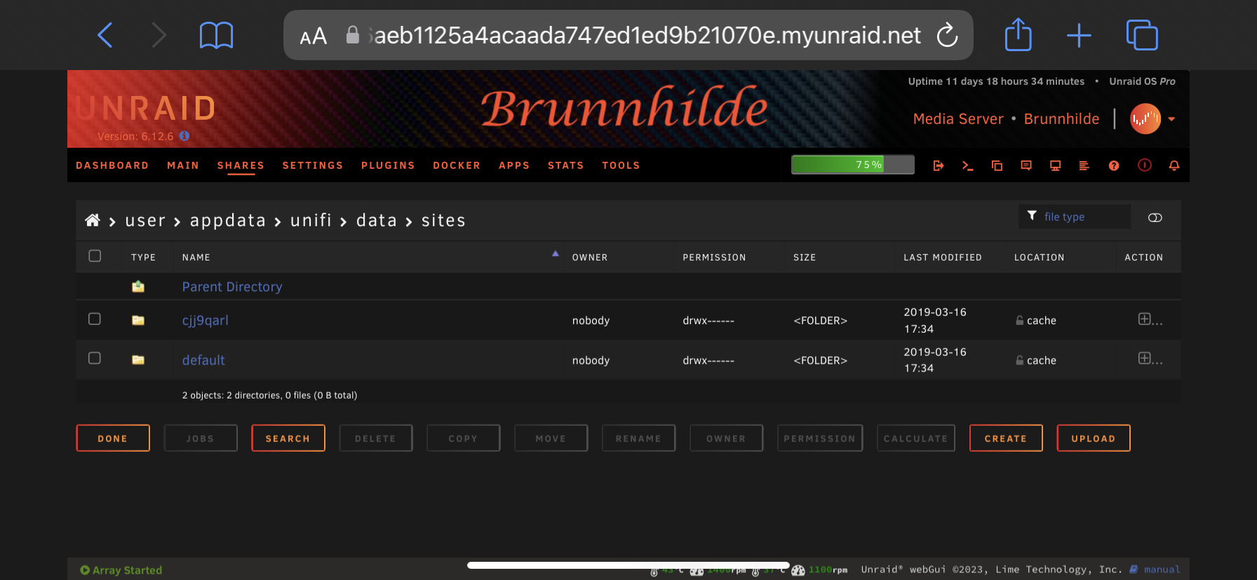

I need to upload config.gateway.json to the controller. This needs to be placed in: <unifi_base>/data/sites/site_ID, according to https://help.ui.com/hc/en-us/articles/215458888-UniFi-USG-Advanced-Configuration
This means I would upload the json file to user/appdata/unifi-controller/data/sites/default/
However, there is no /sites/default/ path. Do I just make the sites/default folders myself within user/appdata/unifi-controller/data/?
This should already exist. At least it does on mine.

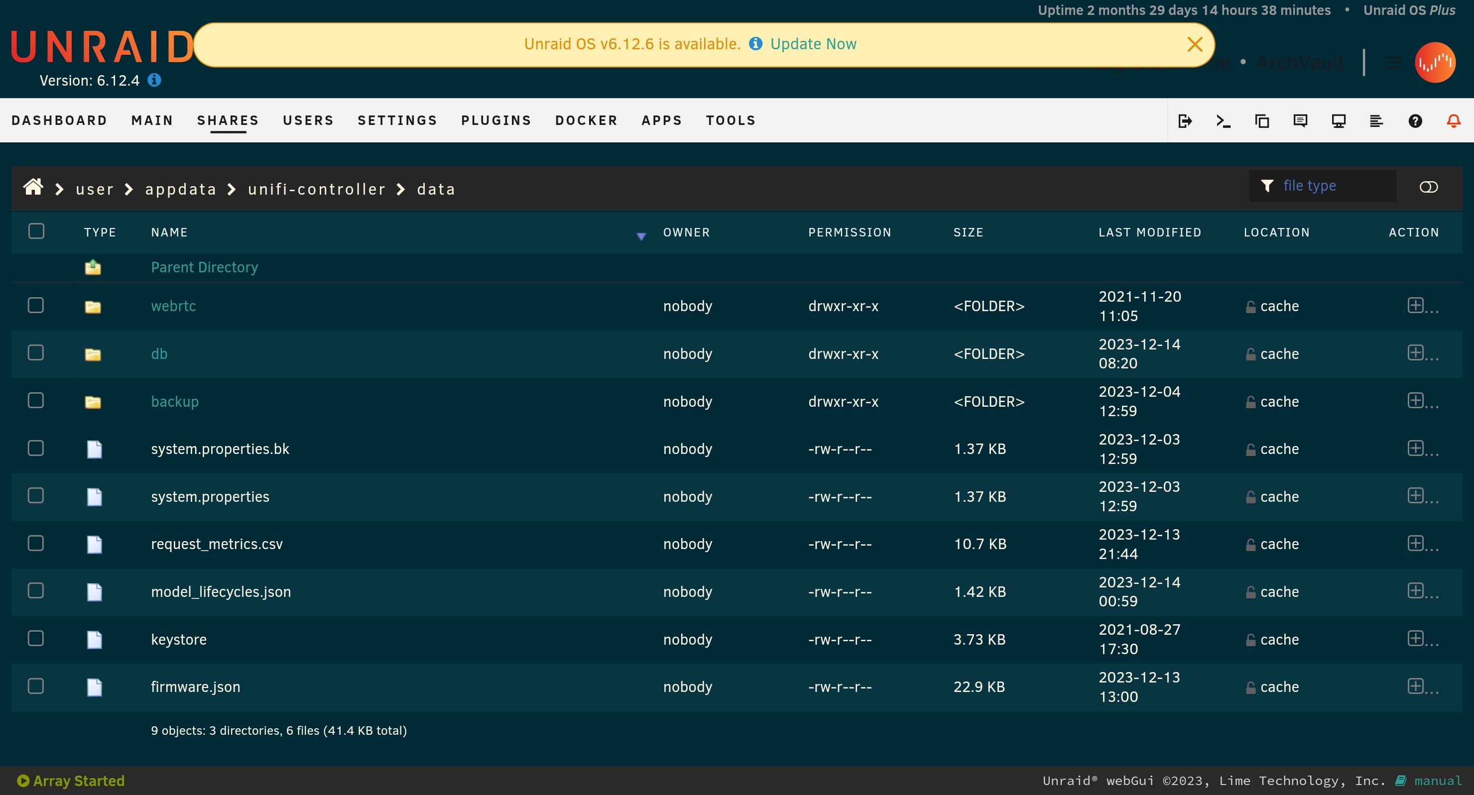

That is weird. I have no such path. Also, notice that I have appdata/unifi-controller instead of your appdata/unifi
Edit: Solved! The folders do show up when you upload an image for a floor plan (in the topology section). You have to enable legacy UI for this. I could have created the folders myself but I didn't want the hassle of setting the right folder permissions.
