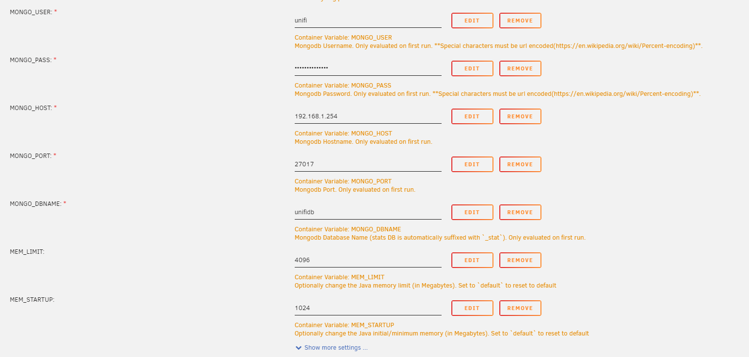

I didn't have to create a custom unifi bridge network to have unifi container see the database container, just use the IP address of the unraid server instead of a host name, much easier.
MONGO_HOST: <ip-address>

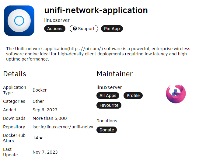

Unifi Docker Application Setup:
Following the LinuxServer.IO group and to keep with package maintainer:
Following there GitHub for setup…
See: https://github.com/linuxserver/docker-unifi-network-application

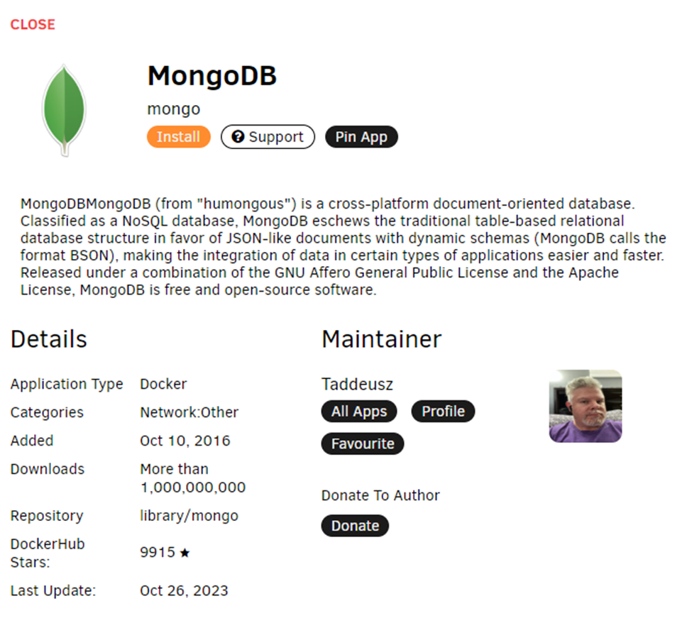

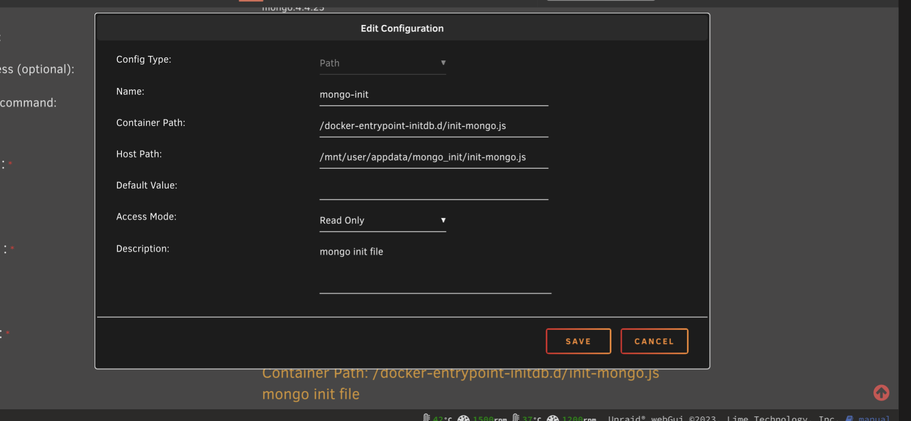

Lets start by Setting Up Your External Database Unraid Community App page: Mongo DB
Maintainer Notes This is meant for mongodb 3.6 through 4.4 that are supported… but docker template works for Official mongo db image: https://hub.docker.com/layers/library/mongo/7.0-rc/images/sha256-5227c4e82658359049d86d9b87039b989e2b4e42908d93fcb6f042b8846a4cdb?context=explore
Docker Hub Repository: mongo:7.0-rc
The new Unifi Docker Application requires mongodb version 6 or higher…. YOU MUST SET A MONGO TAG! Don’t use latest! Mongdb doesn’t support in place upgrades between dockers and this will break you setup!
We will also be making a  init-mongo.js file for this docker to make our database, user, and access.
THANK YOU wgstarks for you assistance on this:

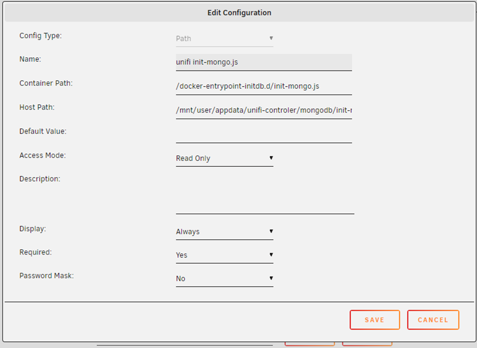

So a template change edit would look something like this:
Install Official Mongo DB and at the template make the necessary changes:
*Advance toggle at the top to view and make changes
We will be adding a path, changing the network type and setting a mongo DB tag
Change the following:

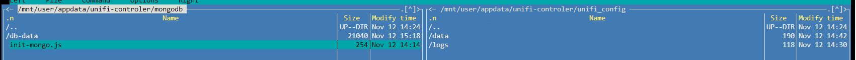

*Unraid by default will go to folders you will need to go to where your init-mongo.js file you make is and type in the path to do a docker 1 for 1 file replacement and run.
The init-mongo.js via GitHub Docker Maintainer should look something like this
example init-mongo.js per github
db.getSiblingDB("unifidb").createUser({user: "unifi", pwd: "Change_ME_password", roles: [{role: "dbOwner", db: "unifidb"}]});
db.getSiblingDB("unifidb_stat").createUser({user: "unifi", pwd: " Change_ME_password ", roles: [{role: "dbOwner", db: "unifidb_stat"}]});
With these edits you now have a working mongo 7 DB with a known database, user an password. Using the Host network now means that the ip address of you unraid or hostname of you unraid will now reach the MongDB.

  -v '/mnt/user/appdata/unifi-controler/mongodb/db-data/':'/data/db':'rw'
  -v '/mnt/user/appdata/unifi-controler/mongodb/init-mongo.js':'/docker-entrypoint-initdb.d/init-mongo.js':'ro' 'mongo:7.0-rc'

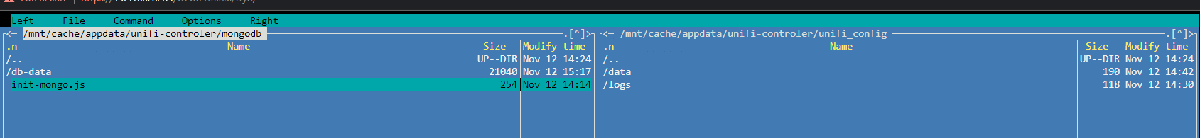

I Have made folders and changed where docker will save the docker appdata and file paths...

lets make some tempalte edits:
add https://[IP]:[PORT:8443] so we can use the webui to open the container
add the username you used in the init-mongo.js
atm the above database name is unifidb, user unifi, password Change_Me_password
and the host is the ip/hostname of unraid...
fill in the necessary option in their correct places in the template.
as they are optional, remove the bottom 2 options about the auth method and tls option.
I have also increased the mem limit to 4 GB of ram
this will now connect to the mongo db 7 on the unraid IP. and give you a https web connect to the controller.

Thanks @bmartino1 & @wgstarks for this detailed info about the Mongo & new unifi container in unraid.
Unfortunately I'm not getting the init-mongo.js file to work. Every time I try to deploy mongo with the settings you provided above, it will just create some test database. Not the unifi one.
Could you elaborate a bit more about this: "*Unraid by default will go to folders you will need to go to where your init-mongo.js file you make is and type in the path to do a docker 1 for 1 file replacement and run."
What do you mean exactly? I know that default a init-mongo.js folder is created, do I just remove this folder & replace it with the .js file? Or do i need do do something else?
I think it is in this step that something is going wrong for me...
Thanks again!
This isn’t true. Or at least it wasn’t for me. I manually created the folder and the file and the added the path to the file in the container configuration.
In my case this was-
