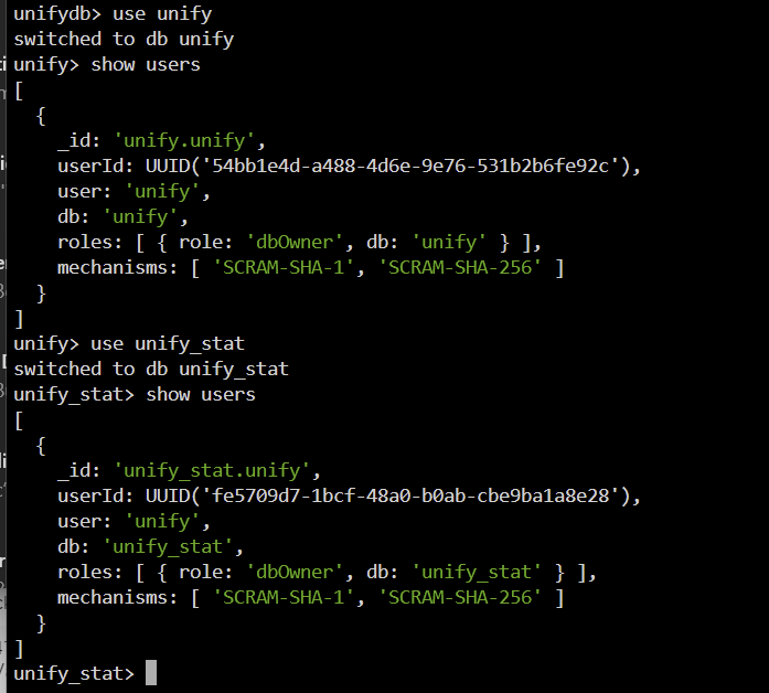

for anyone that is having issues with the init-mongo.js file/path (it was giving me issues that I was too lazy to troubleshoot), I opted to instead create the mongodb container and then manually create the two dbs and users within and then it worked for me.
Once you're within the console of the mongodb container you can type mongosh and then:
test> use unifi
switched to db unifi
unifi> db.createUser({
user: "unifi",
pwd: "enter-your-pw",
roles: [
{ role: "dbOwner", db: "unifi" }
{ ok: 1 }
test> use unifi_stat
switched to db unifi_stat
user: "unifi",
roles: [
{ role: "dbOwner", db: "unifi_stat" }
{ ok: 1 }
Edited by nate1749

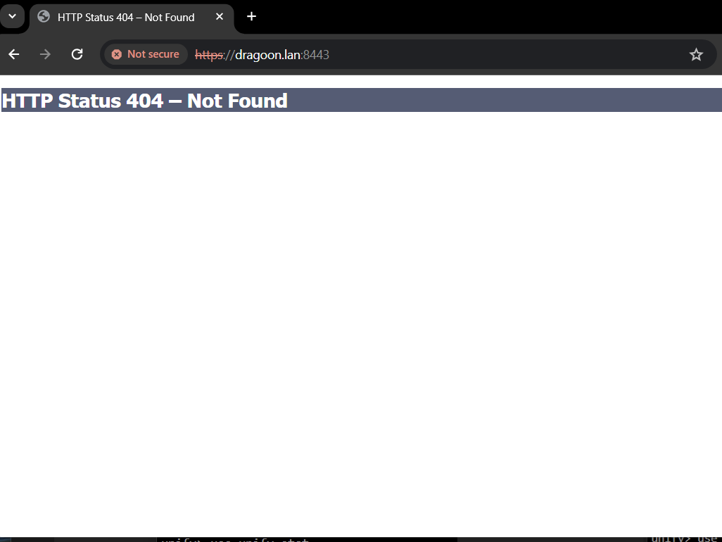

I am getting the same problem as TekDRu reported here. When I try to load up the web portal I get 404 not found, on both HTTPS and HTTP paths.
Users are created properly in mongo (Currently using 7.0.5-rc0):

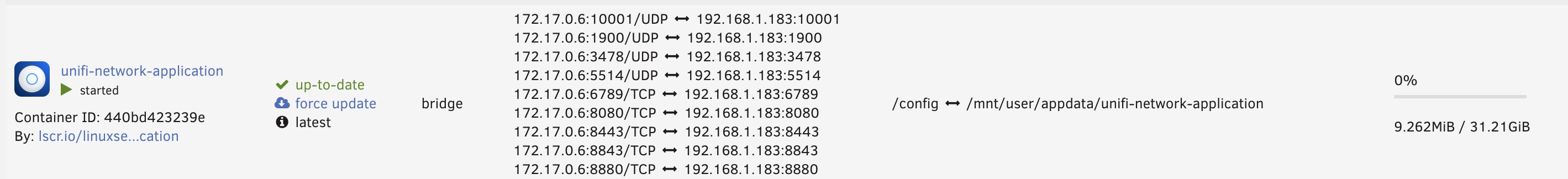

Re:  404 error.  @Archonite @TekDRu
your mileage may vary but...I ran into this (a lot) and after some google-fu, found it to be an '@' symbol in my password, and some 'legacy' config from adjusting and moving things around.
Connection to the DB must be successful (beyond the unifi-network-application 'logs' no longer showing connection errors to the DB' ; that appears to just be network connection test versus authentication test
1) the image will 'stick' the database/username/password' in the config as a one time go/only evaluated on first run.  You have one shot to input it correctly.  if you change the username/pass, you *may* need to recreate the docker container.
1a) I was able to validate this by going to unifi-network-application console, and viewing the file logs/server.log.  After changing my password, I could still see the old password in the logs.  Same with the change of the mongo_host, post change, was still the first instance/IP I tried.
2) If your password contains an '@' symbol, or something that doesn't URL encode properly, you'll need to submit the pwd in URL encode format (as it notes in the community app)
I ran into this and changing the pw from one with an @ , and recreating the container to a NEW appdata path (unifinetworkapplication versus unifi-network-application) resolved for me

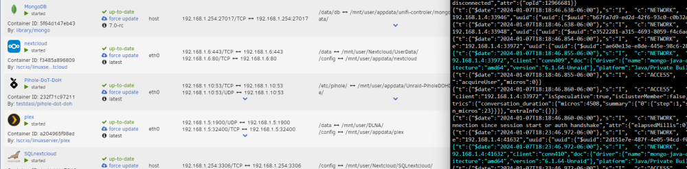

Just moved over to the two-container solution using a combination of the instructions from LS.IO and in this thread.
Everything seems to be working fine now, except that my mongodb log is constantly being written to with entries like the following:
{"t":{"$date":"2024-01-05T15:59:22.000+00:00"},"s":"I",  "c":"NETWORK",  "id":51800,   "ctx":"conn12","msg":"client metadata","attr":{"remote":"172.19.0.3:50624","client":"conn12","doc":{"driver":{"name":"mongo-java-driver|sync","version":"4.6.1"},"os":{"type":"Linux","name":"Linux","architecture":"amd64","version":"6.1.64-Unraid"},"platform":"Java/Private Build/17.0.9+9-Ubuntu-122.04"}}}
{"t":{"$date":"2024-01-05T15:59:22.052+00:00"},"s":"I",  "c":"ACCESS",   "id":20250,   "ctx":"conn12","msg":"Authentication succeeded","attr":{"mechanism":"SCRAM-SHA-256","speculative":true,"principalName":"unifi","authenticationDatabase":"unifi","remote":"172.19.0.3:50624","extraInfo":{}}}
{"t":{"$date":"2024-01-05T15:59:23.293+00:00"},"s":"I",  "c":"STORAGE",  "id":22430,   "ctx":"WTCheckpointThread","msg":"WiredTiger message","attr":{"message":"[1704470363:293326][1:0x15273f73d700], WT_SESSION.checkpoint: [WT_VERB_CHECKPOINT_PROGRESS] saving checkpoint snapshot min: 6840, snapshot max: 6840 snapshot count: 0, oldest timestamp: (0, 0) , meta checkpoint timestamp: (0, 0) base write gen: 660"}}
{"t":{"$date":"2024-01-05T16:00:23.344+00:00"},"s":"I",  "c":"STORAGE",  "id":22430,   "ctx":"WTCheckpointThread","msg":"WiredTiger message","attr":{"message":"[1704470423:344527][1:0x15273f73d700], WT_SESSION.checkpoint: [WT_VERB_CHECKPOINT_PROGRESS] saving checkpoint snapshot min: 6918, snapshot max: 6918 snapshot count: 0, oldest timestamp: (0, 0) , meta checkpoint timestamp: (0, 0) base write gen: 660"}}
{"t":{"$date":"2024-01-05T16:01:23.377+00:00"},"s":"I",  "c":"STORAGE",  "id":22430,   "ctx":"WTCheckpointThread","msg":"WiredTiger message","attr":{"message":"[1704470483:377873][1:0x15273f73d700], WT_SESSION.checkpoint: [WT_VERB_CHECKPOINT_PROGRESS] saving checkpoint snapshot min: 6921, snapshot max: 6921 snapshot count: 0, oldest timestamp: (0, 0) , meta checkpoint timestamp: (0, 0) base write gen: 660"}}
{"t":{"$date":"2024-01-05T16:02:23.398+00:00"},"s":"I",  "c":"STORAGE",  "id":22430,   "ctx":"WTCheckpointThread","msg":"WiredTiger message","attr":{"message":"[1704470543:398781][1:0x15273f73d700], WT_SESSION.checkpoint: [WT_VERB_CHECKPOINT_PROGRESS] saving checkpoint snapshot min: 6969, snapshot max: 6969 snapshot count: 0, oldest timestamp: (0, 0) , meta checkpoint timestamp: (0, 0) base write gen: 660"}}
{"t":{"$date":"2024-01-05T16:03:23.425+00:00"},"s":"I",  "c":"STORAGE",  "id":22430,   "ctx":"WTCheckpointThread","msg":"WiredTiger message","attr":{"message":"[1704470603:425199][1:0x15273f73d700], WT_SESSION.checkpoint: [WT_VERB_CHECKPOINT_PROGRESS] saving checkpoint snapshot min: 6974, snapshot max: 6974 snapshot count: 0, oldest timestamp: (0, 0) , meta checkpoint timestamp: (0, 0) base write gen: 660"}}
Is anyone else running the Mongo container getting this?
Any idea what it means? Is the log by default set to verbose? This will eat up space really quickly.
Thanks for this suggestion. Following your steps got me past the 404.
That seems to be the default yes. From what I can tell, the logging is set to verbose by default. While I don't see a data space hit, that doesn't mean constant read writes are wanted. The data here is what's used in the unifi controller for adaption and statistical data for access and connections.
You are correct the unifi application is a 1 time pass so make sure the password in the unifi template is correct the first time and you stick with it for the MongoDB password. If you wish to change it is recommended you back up your controller and remove image of both mongo db and unifi. Change the password int eh file first and click add container to re-add the dockers to continue on the new password. (This is why lsio didn't want to maintain this in the docker.

I speak too soon: it did not stop the logging...
My weekly backup ran this morning, so it shut all my Dockers down at 5am. However, now mongodb is refusing to start. I have no idea why.
{"t":{"$date":"2024-01-10T05:00:39.718+00:00"},"s":"I",  "c":"CONTROL",  "id":23377,   "ctx":"SignalHandler","msg":"Received signal","attr":{"signal":15,"error":"Terminated"}}

I did remove the .js file, as well as the Docker's path to it. But that's only used the first time it runs, right?
I can't think of any other changes I have made. Any idea what's going on? Why would there be a permission error in the tmp dir?
Really tempted to move over to PeteA's all in one Docker now...

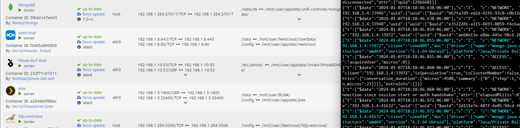

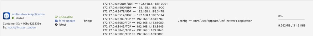

Hello!
I followed the instructions here: https://old.reddit.com/r/unRAID/comments/1abxn3i/upgrading_to_linuxserverio/
I cannot access the webui for the new unifi-network-application container (there is no option to enter a webui and going to it manually results nothing) and mongodb doesn't have any data going to it. There is no data in the databases.
Help?
1081307086_Screenshot2024-01-26at7_10_36PM.thumb.jpg.5106049c60c32ece92aa626489c11547.jpg
EDIT1: I have a http error code 404 on port 8443/manage
Log shows: *** Waiting for MONGO_HOST 192.168.1.183 to be reachable. ***
EDIT: I am getting authentication errors in mongodb for user "unifi." I literally copied this exactly from the post I mentioned above:
db.getSiblingDB("unifidb").createUser({user: "unifi", pwd: "password123", roles: [{role: "dbOwner", db: "unifidb"}]});
db.getSiblingDB("unifidb_stat").createUser({user: "unifi", pwd: "password123", roles: [{role: "dbOwner", db: "unifidb_stat"}]});
Logs show "could not find user unifi for db unifi"
Where do I go from here?
More logging below from mongodb.
>{"t":{"$date":"2024-01-26T20:26:40.305-06:00"},"s":"I",  "c":"ACCESS",   "id":20249,   "ctx":"conn4734","msg":"Authentication failed","attr":{"mechanism":"SCRAM-SHA-1","speculative":false,"principalName":"unifi","authenticationDatabase":"unifi","remote":"172.17.0.6:49358","extraInfo":{},"error":"UserNotFound: Could not find user \"unifi\" for db \"unifi\""}}
FINAL EDIT: I tried some stuff and it worked.
Edited by urbanracer34
fixed
