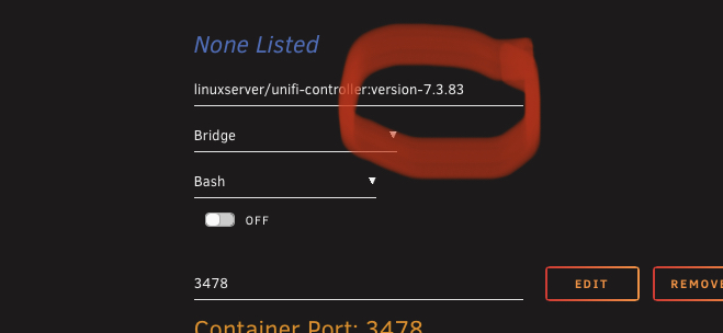

How do you check / change the tag you're using without uninstalling / reinstalling from CA?  Or is that the recommended method?
You can check what tag you are using by going to the docker tab and clicking on the name of the docker. The tag will be shown on the repository field.
If you change the tag the associated version will install when you click “apply”.
