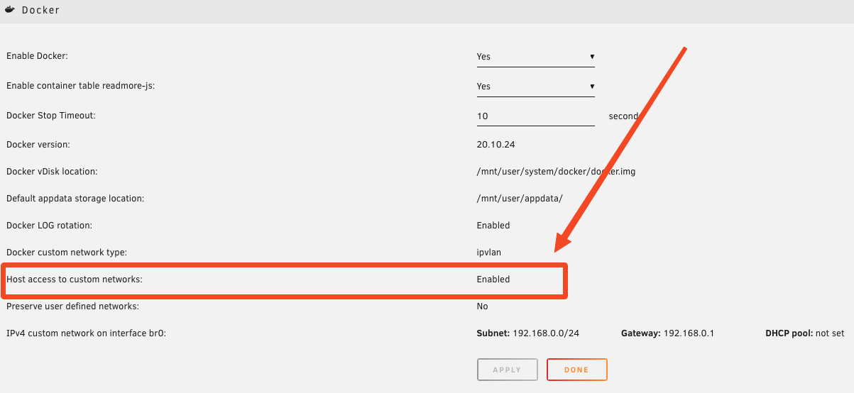

I just get this in the UniFi logs:
*** Waiting for MONGO_HOST 192.168.0.25 to be reachable. ***
*** Defined MONGO_HOST 192.168.0.25 is not reachable, cannot proceed. ***
Any help would be much appreciated.
EDIT:
Got it working, I had to go to Settings > Docker and make sure 'Host access to custom networks' was set to Enabled.
Edited by MattFaz
Resolved

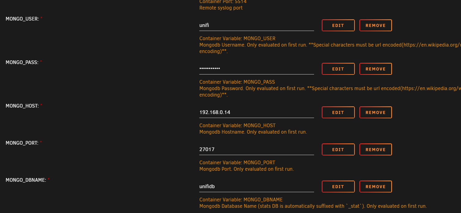

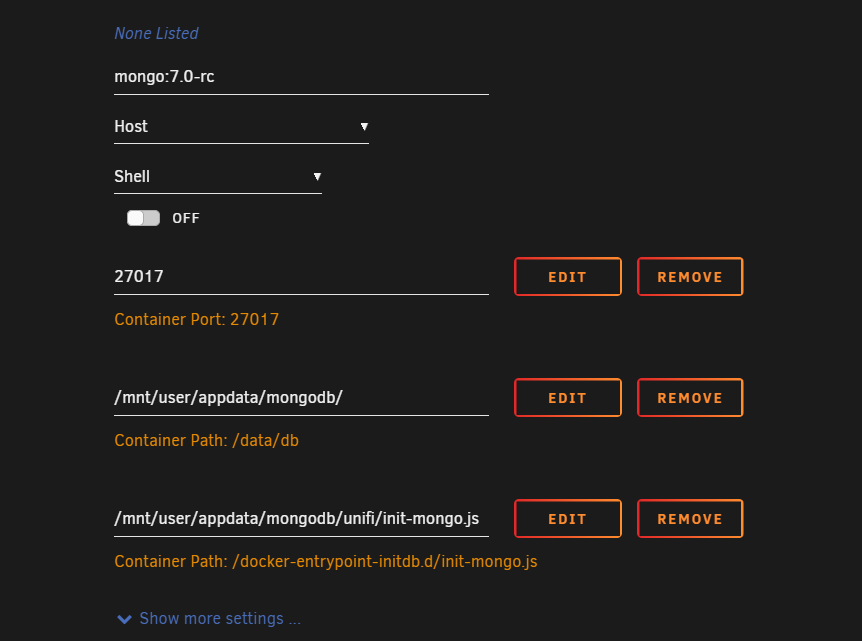

I'm looking for some help and guidance with getting the new unifi container working with MongoDB.
I have followed the instructions to the tee but I'm getting no success at all.
I have created my init-mongo.js file and put it in the following path //mnt/user/appdata/mongodb/unifi
db.getSiblingDB("unifidb").createUser({user: "unifi", pwd: "Hidden", roles: [{role: "dbOwner", db: "unifidb"}]});
db.getSiblingDB("unifidb_stat").createUser({user: "unifi", pwd: "Hidden", roles: [{role: "dbOwner", db: "unifidb_stat"}]});
Within MongoDB i have changed the repository to install version - mongo:7.0-rc, I have changed the network to Host and i have created the path to the .js file. Then started the container within unraid.
Installed the new version of the unifi controller and matched the details from my .js file to the variables within the unifi container installing wizard. Applied and started the container. Within the few seconds i see the .js file being read in the logs on mongoDB but its just full of errors. Which i have attached a picture of within this thread.
i did see someone else within this thread have the same issue as me and he resolved by enabling allow host network to see custom networks. I have enabled this and i still have the same issue.
Any help would be greatly appreciated

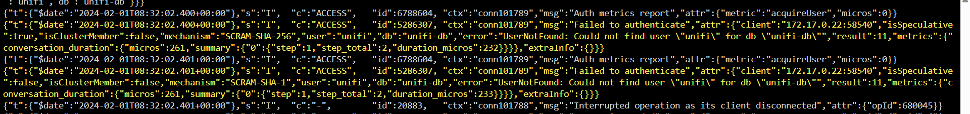

here's what i found out. i had same issuse with the authentiction problems. nothings works. i did everthing as describe in the post earlier. I setup the init script, setup the username and password in the docker variables etc
then i had a hunch. in the container unifi-network-application there this file "system.properties" at "/usr/lib/unifi/data". You can access this via console and read the content via cat command.
in there, it seems is the mongodb connection string
"db.mongo.uri=mongodb\://unifi\:<PW>@<IP>\:27017/unifi?tls\=false"
And it seems that not all variables from the docker config in unraid get passthrough to the contianer. Especially: dbname and password. Because in there is the default password: 12345678 and DB-Name: unifi
So no wonder, there is autentication errors. my authentication data which i setup up in the init script and dbname, which i also set in the docker config, got never used.
Dont know what else is not getting through. But i set the values in my initscript to these from the system.properties and it works!
I guess the problem is somewhere in the process where the variable should be set in the container, what do you guys thinks?
Hope this helps somebody.
Edited by ekim.w
I already knew thses post, but thank you.
For me it looks like it does not take over the values which I set for DB name and Mongo user PW in the MongoDB (via init script) and in the Docker Config.  Only when I took the default values from the container and transferred them to the DB did it work.
