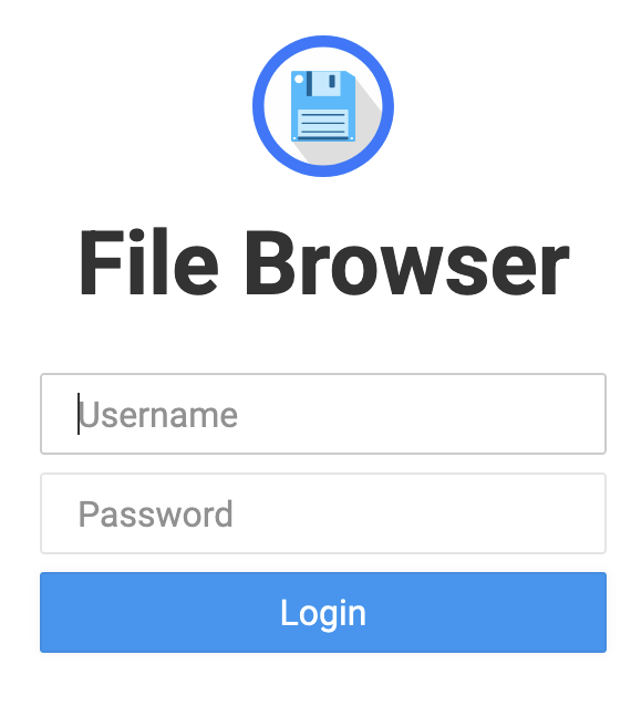

Hey everyone!
Confused about the custom branding thing.
Should I be able to change the file icon right above the login username field and should I be able to change the file icon to the upper-left of the page once logged in?
If so, what files are those?
I have /branding/ set as my branding folder.
I have /branding/img/logo.svg and /branding/img/icons/favicon.ico
My favicon works but if those other two logos are supposed to be changed, they aren't on my setup.
Thank you!

Is there a way to increase the size of the icon on the login page? Is this in browserconfig.xml? (Im a complete newb)
this is not a docker related question. Maybe someone can answare it but better ask this to the developer on github
