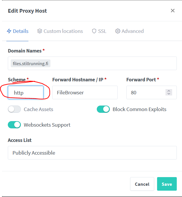

Just dropping a message here, in case someone needs to see it.
I recently lost access to FileBrowser through the net. This was because of an expired SSL certificate.
I wasn't able to renew the certificate within Nginx Proxy Manager either.
To fix this, I changed the scheme within Nginx Proxy Manager to HTTP instead of HTTPS (which previously worked fine, for whatever reason)
Maybe this'll save a few hours of hair pulling from someone :)

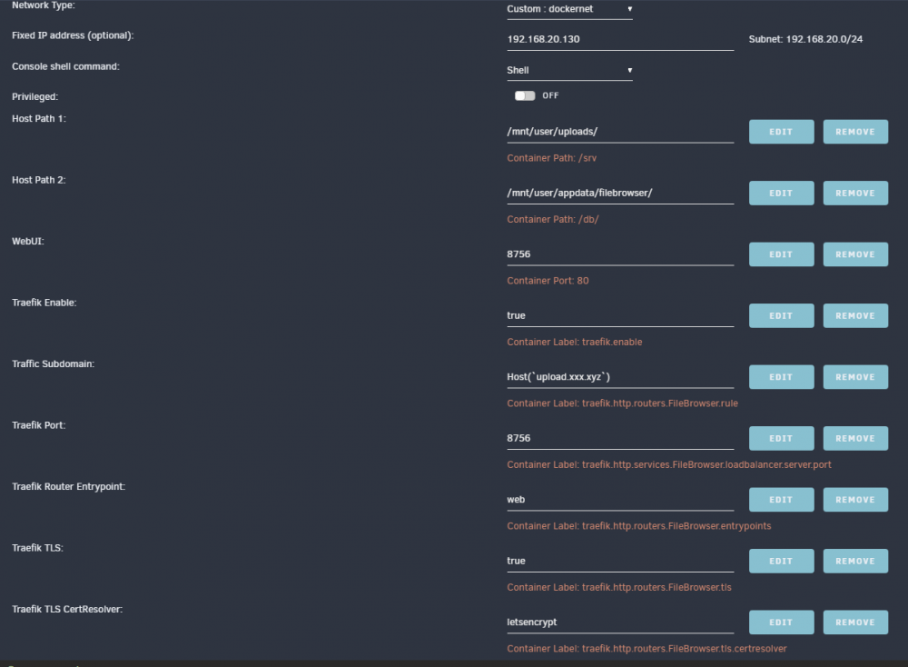

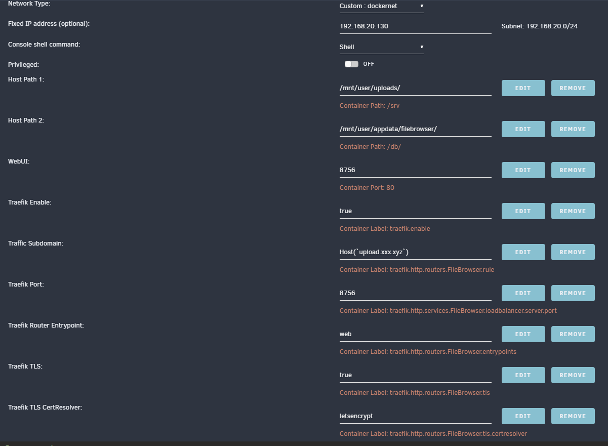

Is anyone able to run this behind Traefik?
These are my labels in FileBrowser:
If I set entrypoint to web (http), I get a 404.
If I set entrypoint to websecure (https) I get a 502.
Any idea what I'm doing wrong? Got a bunch of other containers working great via Traefik.
Thanks!

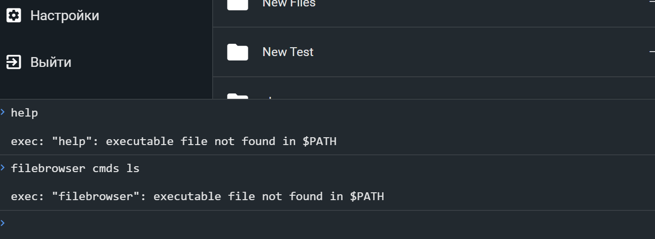

how we can use command line ? its not working for me ...

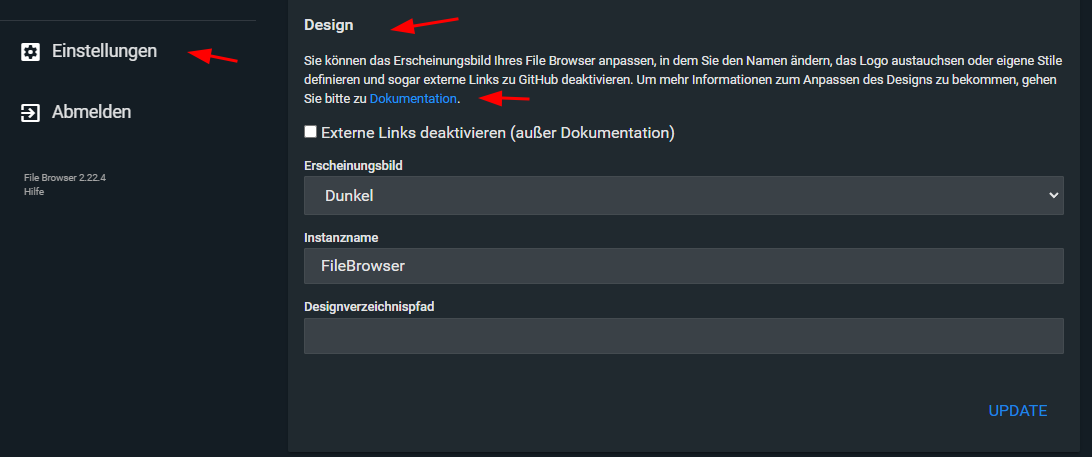

Could someone tell me if there is a tutorial somewhere to change the original skin ?

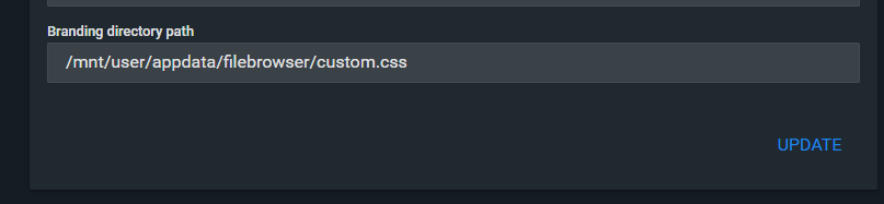

when you look into your filebrowsers settings there is even a link to the documentation howto ...
as sample when i used a custom style (before FB had a dark mode)
OK thanks Alturismo !
I will try to understand this CSS !!! haha !

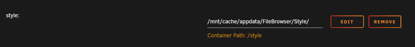

Thanks again for your help, but I don't understand how write in the preferences.
This doesn't work :
3 hours ago, PicPoc said:
This doesn't work :
always docker point of view ... like in any other docker(s)
in this sample, while my files are sitting in /mn/cache/appdata/..... from docker point of view its /style
may start with reading some basics before running into issues later ;)
Thanks again.
In the documentation nothing clearly explains where to put this file.
I tried several options, seen from the docker and as you showed me, but I don't see.
I am not an expert in docker and I have realized that the documentations are succinct each time. I don't really understand why!
I'm going to test other things but it's too random like this to succeed in moving forward.

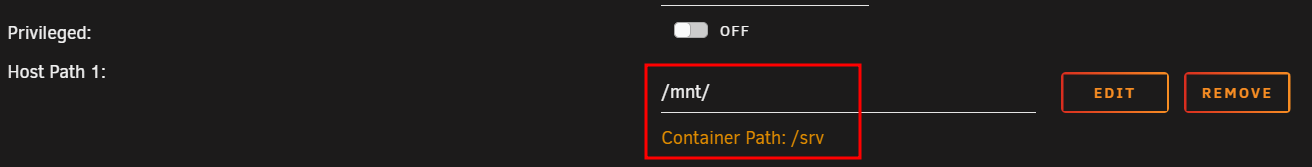

Hello Sir,
I have installed filebrowser apps in my unraid backup server. but I have faced a problem
Problem is : when I open file browser  with Admin/Admin then show one TEST folder (setting > user manager > Scope: blank)
but when I open another user test for folder share (setting > user manager > Scope: /mnt/user/share) then always show error message "This location can't be reached".
Please help me how to solve this problem

How to mount another folder with Host Path 2, Host Path 3, Host Path 4 with share folder, doc folder, test folder etc.

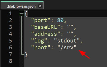

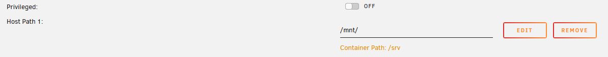

while /mnt <> /srv is mounted, dockers point of view to your filesystem is /srv/user/share as sample instead /mnt/user/share

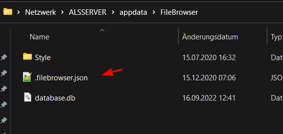

now, when you look into your filebrowser's .json config file

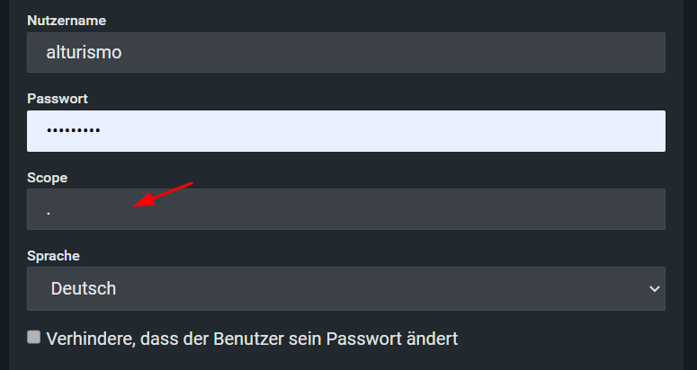

you see another root set, so for filebrowser now its even without /srv, means, ./user/share/... instead /srv/user/share
so basically this will end in /mnt on the host system (empty .)
and this will end in (mnt/user/ on the host system

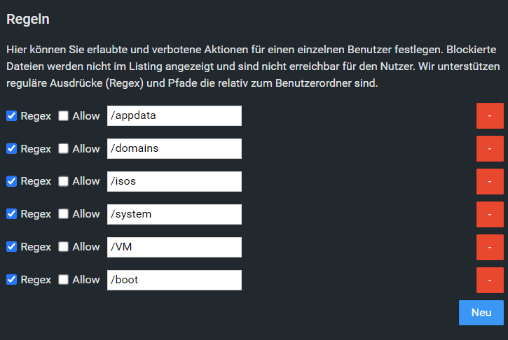

while this will exclude folders from the host system then from a user in /mnt/user/...
so in this case, you see the user "sandra" has access to /mnt/user/ on the host WITHOUT access to /mnt/user/appdata as sample
i hope this clear's it up now, for the rest, i would suggest to 1. read docker's basics and 2. look at filebrowsers doc's and/or git, so you understand what you mount and do ... before you give access to files you dont want to ;)
