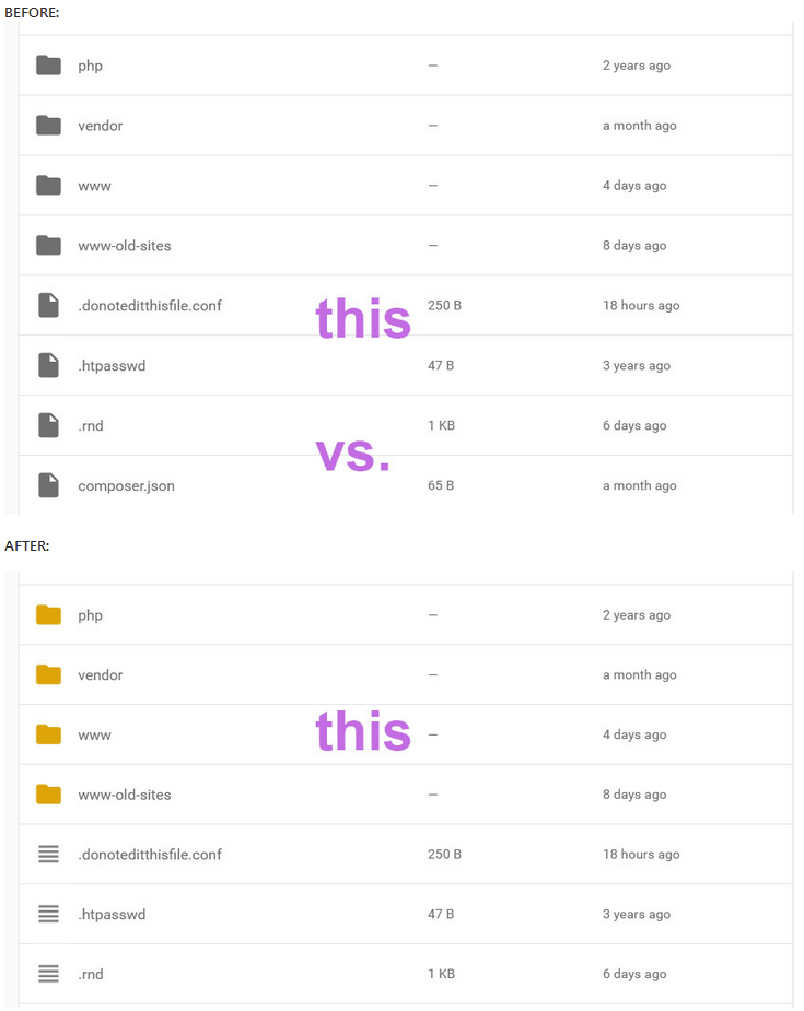

Hi Guys,
I love this Docker... but I have a big pet peeve with it.
I have a hard time dealing with how the icons for files and folders are so similar to each other. I created a feature request on their Github asking for a slight modification. I am not sure if it will be picked up. I created the below in Photoshop.
I think if I were to study the code, I could figure out how to edit to get something similar to the above.
My challenge is two-fold.
One, from his Github, I need to identify the file that has the code that specifies this. With a little time, I can identify where it is and how to edit.
Two (and most important) is that somehow his code gets compiled into a single file (called filebrowser) which is what runs in the Docker. Does anyone know how I can take the slightly modified code, and compile it into the one single file?
I would really appreciate guidance on this.

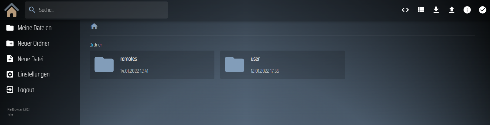

Is it possible to add a network folder ?
If it is possible do you have a example of the syntax please ?
Thank you.
i added my network shares with UAD and then you should have access to ../remotes/
It is working thank you.

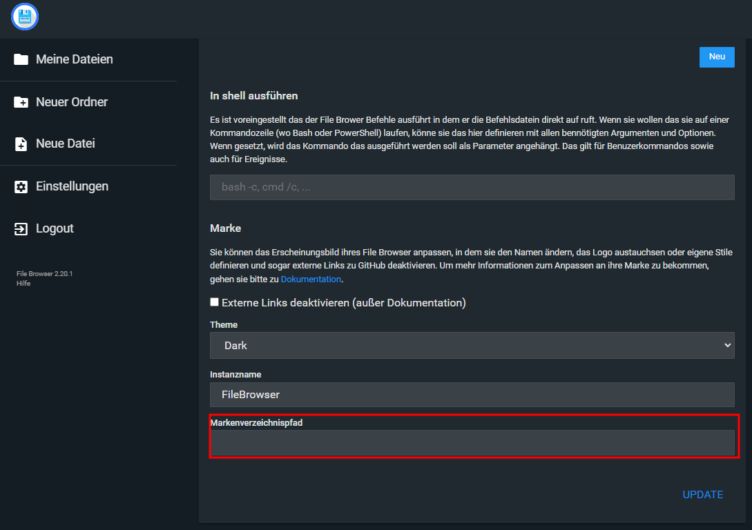

Is there any explanation or hint why a custom.css and img do not work although a path on the server was entered in the Global Settings?
(Example : /mnt/user/appdata/filebrowser/custom/)
The rights for this folder are users/nobody
There is the custom.css with your own code.
Also a folder /img with your logo.svg. Has anyone with current DockerVers 20.1 already got a custom CSS to work?

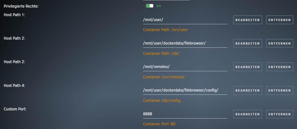

Mount to Docker:
Host: /mnt/user/dockerdata/filebrowser/config
custom.css with:

how do you add the path inside filebrowser now ?
as you now use your config path (which is not the best idea, but nevermind) and you mounted like
you should use now /db/config/blackberry-abyss.css or /db/config/custom/blackberry-abyss.css when you made a subdir ...

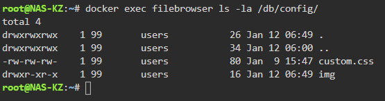

you can check when you use your unraid docker terminal and do (CoRrEcT name of your filebrowser docker)
docker exec filebrowser ls -la /db/config/
to see whats there (from filebrowser docker point of view)
and the path you describe up there /mnt/user/... is /mnt/srv/... from filebrowser's point of view as you see in your mount points.
so basically, /mnt/srv/dockerdata/filebrowser/config/.... would also work.
may read a little about mounts in general about docker's to understand the path's from docker side.
Terminal UnRaid:
So should work or am I still missing something?

Terminal UnRaid:
The instant name is taken over, but the IMG and the CSS are not. Browser cache already cleared hard several times.
I'll try to define a different branding path.
The path has to be
/db/config/ for Markenverzeichnis
Cheers
Gesendet von meinem Redmi Note 8 Pro mit Tapatalk
Thank you very much, that was it. 👍
