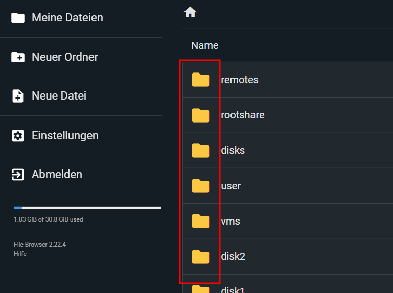

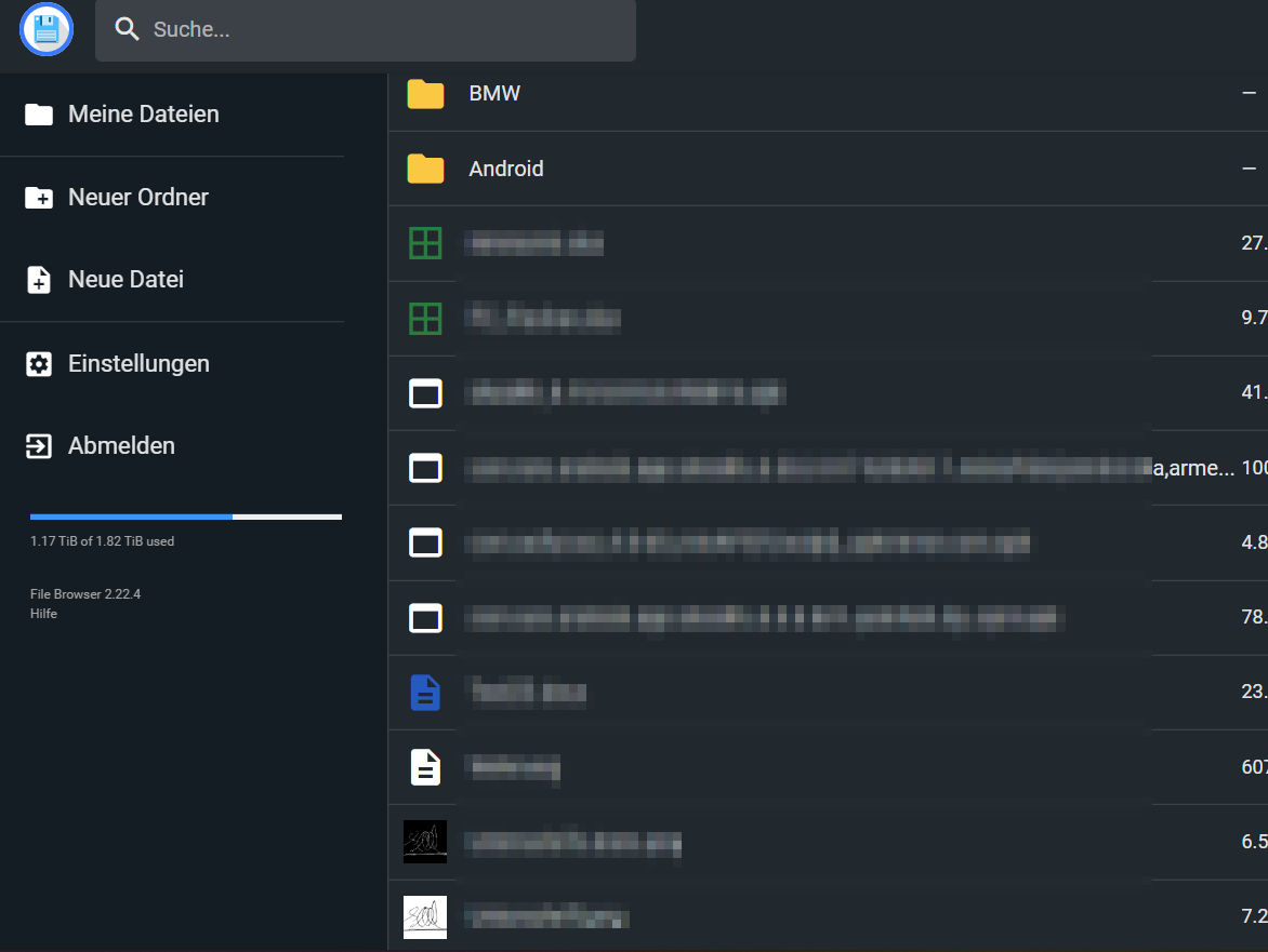

OK, custom.css works with this add:
Copy "custom.css" in "/appdata/filebrowser/" folder ("/database/custom.css" in the docker)

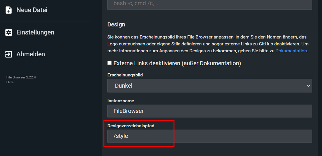

Add in preferences of FileBrowser
Branding directory path :
/database
And this docker use ccs file "/database/custom.css"
BUT, this file (custom.css) is not correct. It's:
NOT :
Files with different colors. :(
Strange !!
For information :
https://thehomelab.wiki/books/other-guides/page/filebrowser-custom-icon-colors-how-to

12 hours ago, PicPoc said:
Strange !!
i tested it now just for fun the colored css you linked above
Result looking ok here ...
Oh!  Yes !!!!!
It's working now !
Thank you once again for your perseverance, it's very kind. It's a great program, which really meets my needs.
These icons are much better for the users, they visualize the files much better. Great!

Hi !
This Theme is really nice : where did you find it ?
Thanks ;)
The theme is self-made and was not found? ;-)

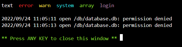

After updating my UnRaid server from 6.9.2 to 6.11.0, the FileBrowser docker seems to have stopped working.
The issue is that FileBrowser cannot access the database file:
To confirm this, I changed the path to the database.db file from the container settings, which resulted in a new database file to be created, and the FileBrowser docker to be fully functional again. Though, without any of my settings and user data etc.
Is there a way to grant permission to the FileBrowser to it's original database.db file?
Worst case scenario, I can always manually set up the docker again, but that's a bit of a pain in the butt.
may try chmod or chown the file from the terminal ?
chown 99:100 /mnt/user/appdata/Filebrowser/database.db  <- change this to the path on your mashine
or
chmod 777 /mnt/user/appdata/Filebrowser/database.db  <- change this to the path on your mashine
as note, working fine here ...
or
Thank you so much! You just saved my hair, and my weekend! :)
I'm not quite sure what happened here, as our backup server went through the same update just a week ago, and FileBrowser seemed to work just fine there. Whatever the case may be, chown seemed to be the answer here. Thank you for the quick answer!

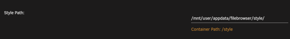

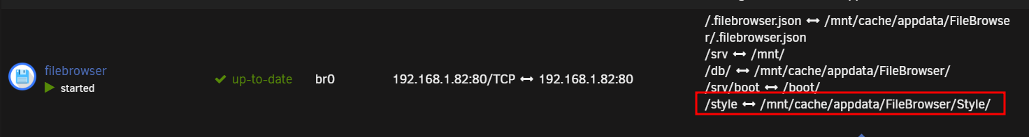

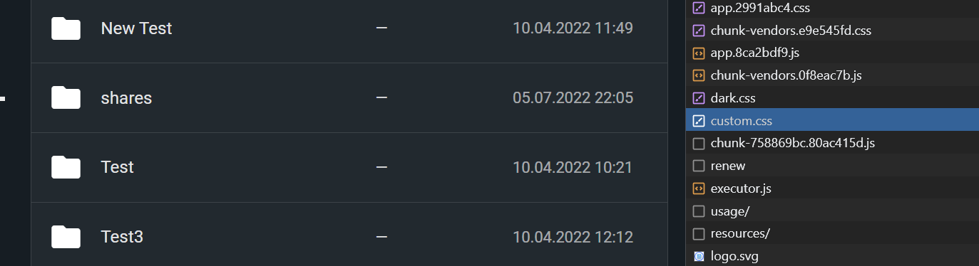

Strange but cant make custom.css to work ,not in local 192...199 not in web
copyed to filebrowser/style , tryed  /srv/style , also made path in container:
still cant find the problem ,cleared the cache from browsers, and dev in browser ,disabled css minify in cloudflare , disabled adguard,
also installed on Oracle cloud without problems but used s6 Filebrowser image ...
Problem Solved , file was not in raw format ! :(
