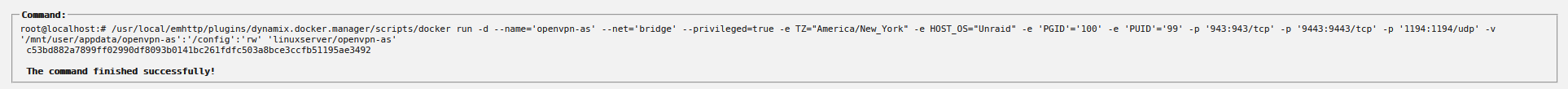

Adding INTERFACE didn't solve the problem
Current run command: /usr/local/emhttp/plugins/dynamix.docker.manager/scripts/docker run -d --name='openvpn-as' --net='bridge2' --log-opt max-size='50m' --log-opt max-file='1' -e TZ="America/Los_Angeles" -e HOST_OS="Unraid" -e 'PGID'='100' -e 'PUID'='99' -e 'INTERFACE'='eth0' -p '943:943/tcp' -p '9443:9443/tcp' -p '1194:1194/udp' -v '/mnt/user/appdata/openvpn-as':'/config':'rw' --cap-add=NET_ADMIN 'linuxserver/openvpn-as'
ff1ad02a88e6e8bcfaf27a54fb73364c371ca262c0bf217464b237662bad3c6c

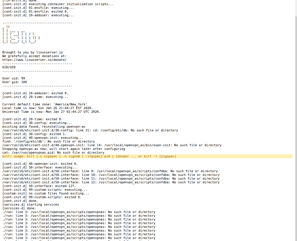

Hi All,
I seem to have a reoccuring problem with openvpn whenever I update the docker container. This has happened multiple times, and I have usually fixed it by deleting the whole docker and starting from scratch, I don't feel like this is a valid way of dealing with this problem though. So whenever I update the docker, it seems to start fine, but fails to load anything. This is the run command
and the log file
I am unsure what is going on here, if it's a file location, a configuration error or what. I followed the spaceinvaderone video that was update in 2019 to set this up. Any help would be much appreciated as this is a real pain point in my vpn. Thanks!
1 hour ago, 15goudreau said:
Hi All,
and the log file
Try /mnt/cache or /mnt/diskX for config folder. And start from scratch

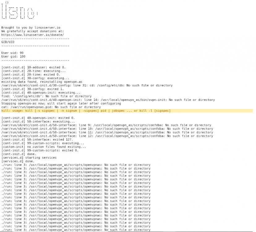

Hi guys, I'm having a weird issue after the most recent update.
Having just gotten around to updating, I can no longer get openVPN to start correctly.  Please see the image below for a snap of the log file - seems a directory has gone awry...
*edit* looks like others have had the same issue, is there a confirmed solution yet? If I have to set it all up AGAIN I think I'm just done with this container.  Every other update it seems like I have to reconfigure from scratch...
It could be just the default location for the /config as explained up. I am going to re-set up instead of using appdata and put in directly onto the cache drive and see if it happens again when an update hits. I agree this is obnoxious and none of my other containers suffer this issue so I have to think it's an openvpn-as issue completely.

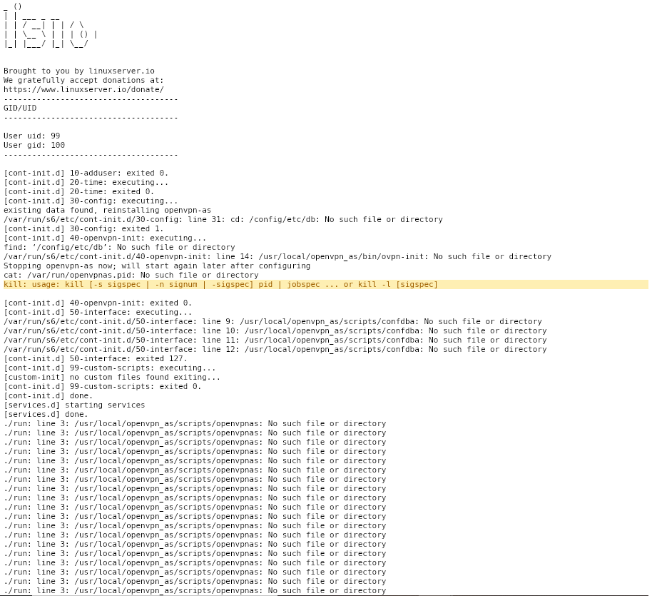

What I'm not understanding is why it's pointing to a folder that doesn't and from what I can tell, has never existed.  I've never changed any default settings when setting up the container in the past.  Unless they've changed the default settings within the container I just don't understand.
We (linuxserver.io) always recommend /mnt/cache for config folder locations. /mnt/user goes through fuse, which can have unwanted consequences for app files. If there is no cache drive, the alternative would be /mnt/diskX which also doesn't use fuse and instead writes directly to the disk
What folder are you talking about?
The error in the log indicates that /usr/local/openvpn_as/scripts/openvpnas is missing.  My docker settings have the config pointing to /mnt/user/appdata/openvpn-as/ (which is stored on the cache drive as per share settings).
The /mnt/user/appdata/openvpn-as/ folder has no 'scripts' directory either.
So myself, probably and many others, set stuff up as spaceinvaderone suggest with the appdata. Can you elaborate why it might not be a good idea for /mnt/user to be used instead of /mnt/cache? Is it fine to just have the folder in /mnt/cache? Will that mess up any cache settings of the docker? I'm not a super power user in unraid so there aren't always reasons why to do something and I am just using a suggestion from someone else without knowing the full reason. Would love more information about that.
I just explained it in the above post. /mnt/user endpoint uses the "fuse" filesystem. Some things are not compatible or do not work as expected (it's fine for storing media data, but can have issues with executed files, symlinks, database files, etc.). /mnt/cache endpoint (and /mnt/diskX) uses the native filesystem on the cache disk.
/usr/local/openvpn_as symlinks to /config. You don't have those subfolders because openvpn installation failed (likely due to fuse filesystem).
I see, thank you so much for the assistance.  Is it primarily openvpn I should be putting directly on the cache or is the same true of most dockers?
Wouldn't want to be hitting issues with other more critical stuff down the line.  In this case I've just been unable to connect out of the local network for a few days, if some of my other stuff goes down it would be much much more bothersome ;-)
Thanks again, I really appreciate the help.
We recommend all config folders to be put on /mnt/cache
Ugh, can I just update that in the configs, or is this a reinstall ALL dockers job?
As a relative newbie to unraid I'm not sure how that information has escaped me for the last 6 months.  I've not seen that mentioned in ANY of the tutorials i've watched for my various dockers.
Better to find out now rather than another 6 months down the line with a heap more stuff running i guess ;-)
If your appdata share is already set to cache only (recommended way), it's just a matter of editing the container settings and changing it from /mnt/user to /mnt/cache and it will use the same exact folders, so no reinstalling or anything.
Ahh, it is.  That's great news.  I'll get on that today.
Once more, thanks for the help 🙂
Huh, I've changed over most of it and you're very right - several minor and none critical errors (especially in Krusader) have literally vanished JUST by switching that over.  Why is this not more visible info?
Thanks man 🙂 🙂
