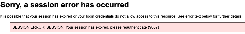

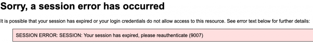

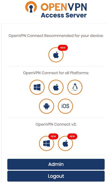

Do:
"During first login, make sure that the "Authentication" in the webui is set to "Local" instead of "PAM". Then set up the user accounts with their passwords (user accounts created under PAM do not survive container update or recreation)"
mean that "admin" should be removed in the url logon?:
https://XX.XX.XX.XX:943/admin/
If so I arrive here:
534663038_Screenshot2020-03-13at18_23_30.thumb.png.4c7c09c7755beed668e524c6a37b3838.png
Going to "Admin" I get this url:
Loggin in with default PAM I get this annoying guy:
1204226653_Screenshot2020-03-13at18_27_47.thumb.png.3e1870baedd70666dab87da0f19e7a3c.png
I have a feeling I am doing something wrong (after 2 hours)...........
Can it be port forwarding? 1194 to 943 on server ip.
Anyone?
//Frode

33 minutes ago, frodr said:
Do:
Anyone?
//Frode

On 3/13/2020 at 1:41 PM, frodr said:
Do:
Anyone?
//Frode
See here: https://discourse.linuxserver.io/t/just-installed-openvpn-as-cant-login-as-admin/1162/5
Has anybody figured out the SESSION ERROR problem? I am another of those affected by this.
I can log in the initial front end page, but only if I use my external domain name. It won't work if I refer to the site using the IP address. It also fails when I try to connect to the admin page, either using IP address or domain name.
I think that it is probably related to my LetsEncrypt proxy configuration, but I don't understand why it broke at the last update. It worked fine until then.
I looked at the link kindly provided by aptalca, but none of the suggested issues seem to belong to my configuration. I already had default and admin locations in my proxy configuration.
Because openvpn-as got an update and they changed some things
Check the openvpn logs in the config folder
