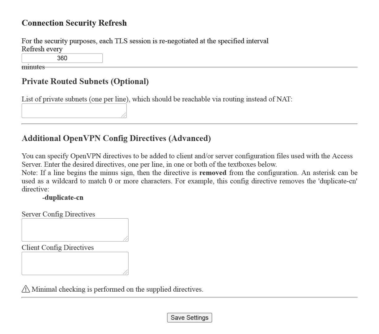

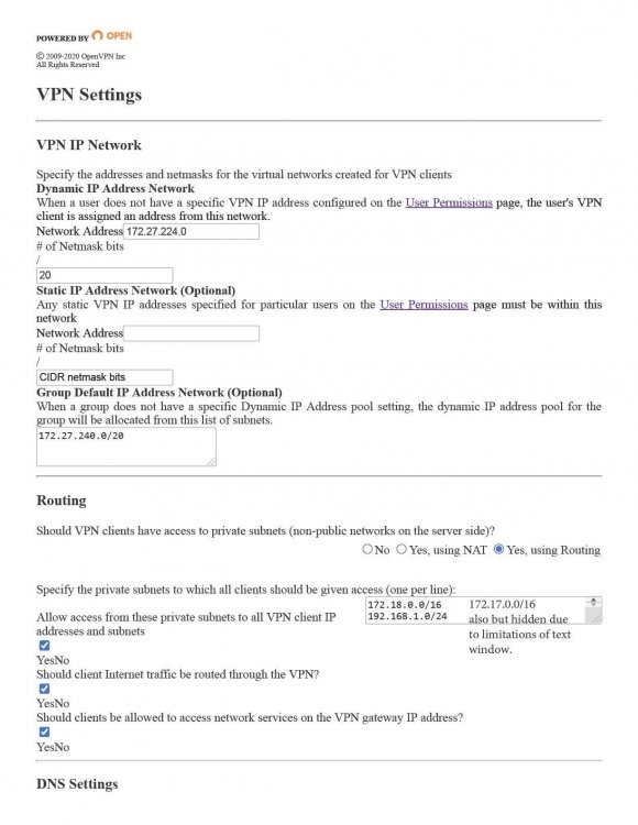

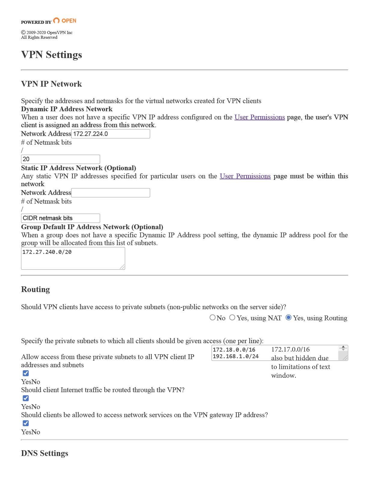

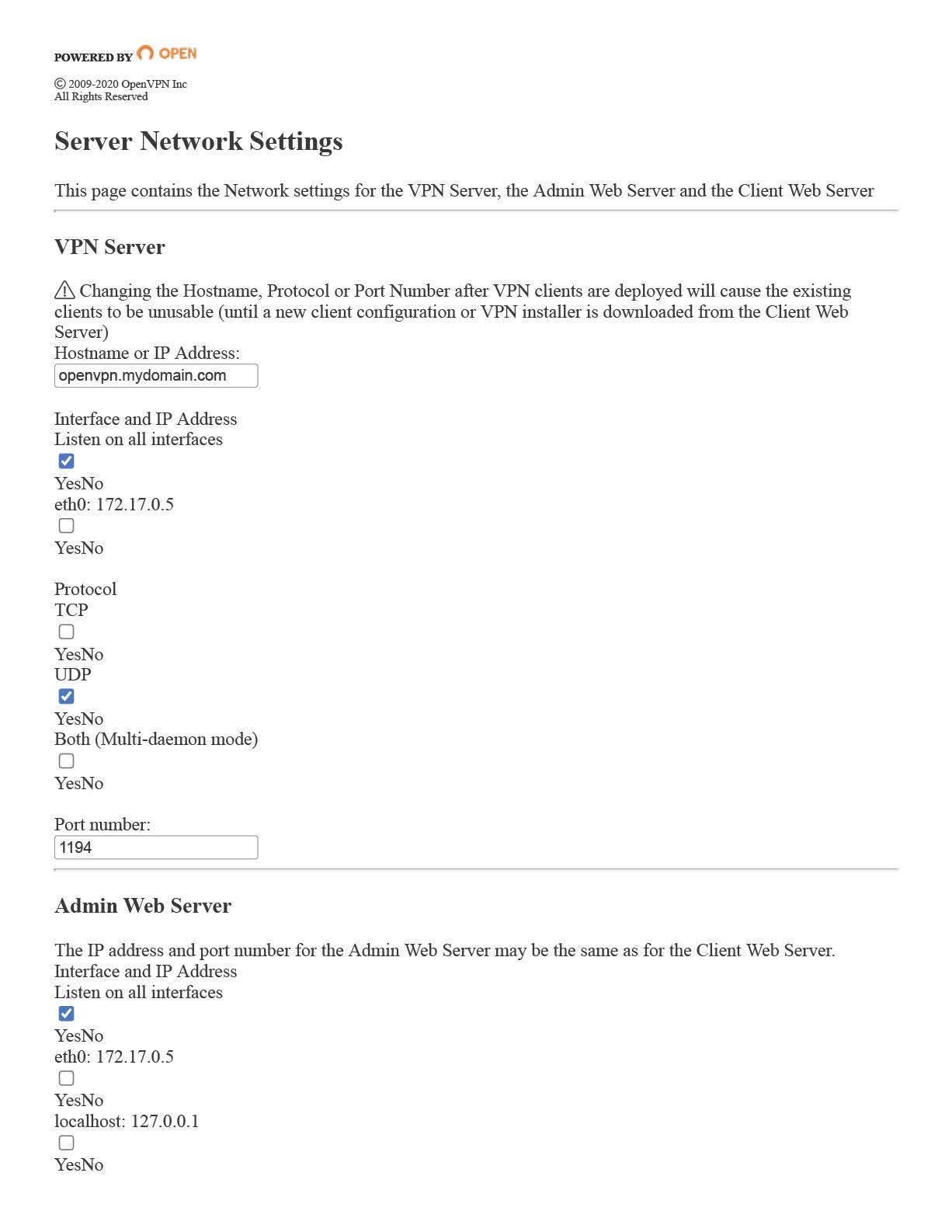

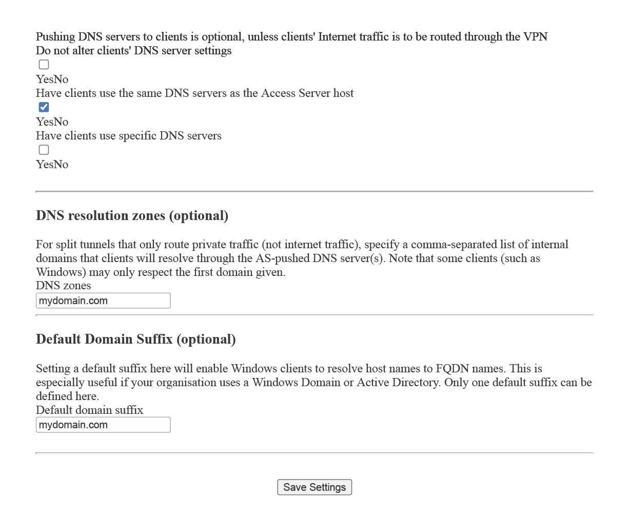

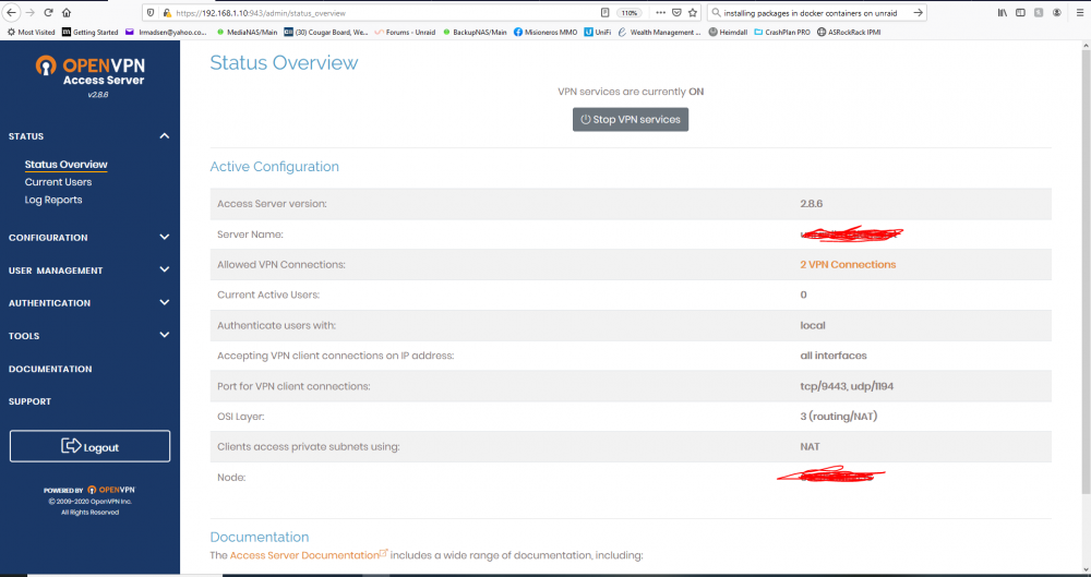

On 6/10/2020 at 6:53 AM, splerman said:
I've had OpenVPN-AS running successfully for a while in NAT-mode except it causes Source IP address-based access control that I've used in my LetsEncrypt configurations to operate incorrectly for OpenVPN clients as it acts based upon incorrect Source IP address. Now I'm trying reconfigure OpenVPN-AS from NAT-Mode to Routing-Mode so correct Source IP Addresses will be reported to LetsEncrypt.
I've searched this forum as well as Reddit and Google for "unraid openvpn-as routing" and come up short on what I need to move forward.
In the OpenVPN-AS Admin WebUI, I've changed Configuration -> VPN Settings -> "Should VPN clients have access to private subnets (non-public networks on the server side)?" from "Yes, Using NAT" to "Yes, Use Routing".
I've added a new static route to my access router:
172.27.224.0/20 (i.e., OpenVPN Client Dynamic IP Range) Next Hop to 192.168.1.200 (Unraid static IP) with Hop Distance 1
Next, I believe that I need to build a static route in Unraid to route traffic for 172.27.224.0/20 (i.e., OpenVPN Client Dynamic IP Range) to "Somewhere", but I'm not clear how to define it. Since OpenVPN-AS uses Network Type Bridge, I don't think I can assign it a static IP Address (It is currently, however, 172.17.0.5). Can I send it to 172.17.0.1? Do I reference the bridge or the container in some other way?
Are there any other modifications required? Will the server and client conf files get updated automatically based on the server modification to push proper routes or do I need to add anything to the Additional OpenVPN Config Directives fields on the server?
Current Configuration Info provided, below. Any guidance is extremely appreciated!
Current OpenVPN-AS run command:
/usr/local/emhttp/plugins/dynamix.docker.manager/scripts/docker run -d --name='openvpn-as' --net='bridge' -e TZ="America/Los_Angeles" -e HOST_OS="Unraid" -e 'PGID'='100' -e 'PUID'='99' -p '943:943/tcp' -p '9443:9443/tcp' -p '1194:1194/udp' -v '/mnt/user/appdata/openvpn-as':'/config':'rw' --cap-add=NET_ADMIN 'linuxserver/openvpn-as'

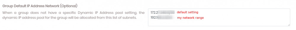

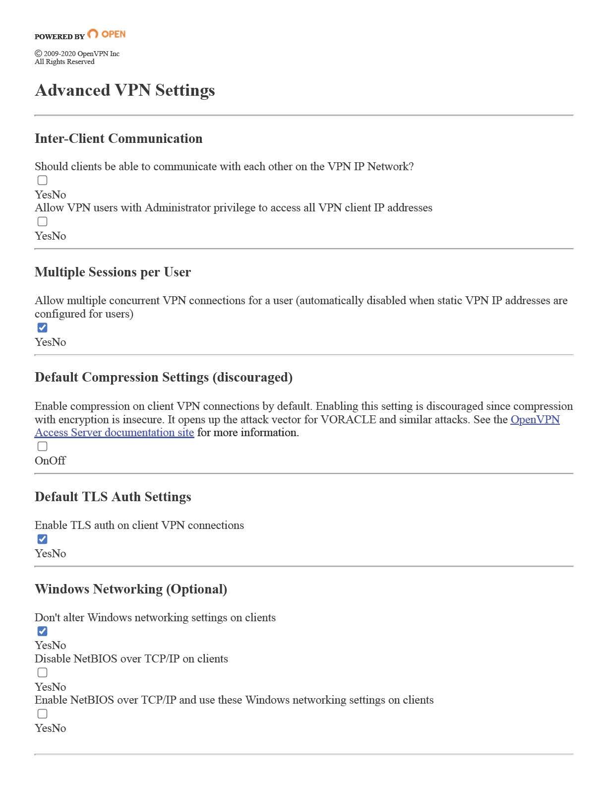

Current OpenVPN-AS Network Settings, VPN Settings and Advanced VPN Settings:
1657395370_CurrentOpenVPN-ASServerSettings_Page_1.thumb.jpg.ef9e73973dd4a74c94da96f2256ade0f.jpg
2129646130_CurrentOpenVPN-ASServerSettings_Page_2.thumb.jpg.8d97e3e155ed4cb2188f22ac2ad0e4ad.jpg
1931168366_CurrentOpenVPN-ASServerSettings_Page_3.thumb.jpg.bc5948833e8e28a512a68dfeb59ff991.jpg
5426764_CurrentOpenVPN-ASServerSettings_Page_4.thumb.jpg.5301399f5098a76018078dbf8e45c25c.jpg
1972279333_CurrentOpenVPN-ASServerSettings_Page_5.thumb.jpg.0bb1473ead394c7a7becb51be011b0bd.jpg
1495274644_CurrentOpenVPN-ASServerSettings_Page_6.thumb.jpg.9432ede26058f52e4d5f97ce400bdcc1.jpg
Still trying to troubleshoot my OpenVPN-AS now that I've switched from NAT to Routing. Results from ping tests, below. Also provided: OpenVPN Client log, route tables, iptables

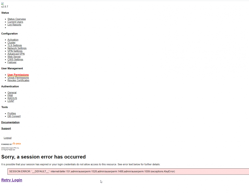

Hello,
My OpenVPN docker worked for a little while earlier this year.  It suddenly stopped working.  So I decided to uninstall the docker and reinstall it to see if I can get it to work.  I download the docker, install says it completes successfully.  The first time I go to access the WebGUI in the docker, I get the attached log with a number of errors in it.  The web page I get looks like the attached screen shot when I click on the WebUI selection on the docker in Unraid.
I have changed my DNS servers to google DNS servers 8.8.8.8 and 8.8.4.4 and flushed the DNS running the following code in the command prompt of the PC I'm using to access the web interface on: ipconfig /flushdns and received the response "successfully flushed the DNS Resolver Cache."  Then I reinstalled the docker, still same issues.  I also shutoff all my anti-virus and firewall stuff, and I am not using a proxy server.  I have also deleted the entire OpenVPN folder created in appdata before uninstalling, still does not help.  When I uninstall I select the box that says delete image file.  Is there more hidden files tucked away in different places that I need to go in and manually delete to completely remove the Docker?
I have tried different web browsers as well, with no success.
Please help....I loved it when this thing worked, but by uninstalling and reinstalling the Docker I appear to be worse off.
Thanks for your time.
WebPage_Screen_Shot.pdf OpenVPN_Error_Log.txt
