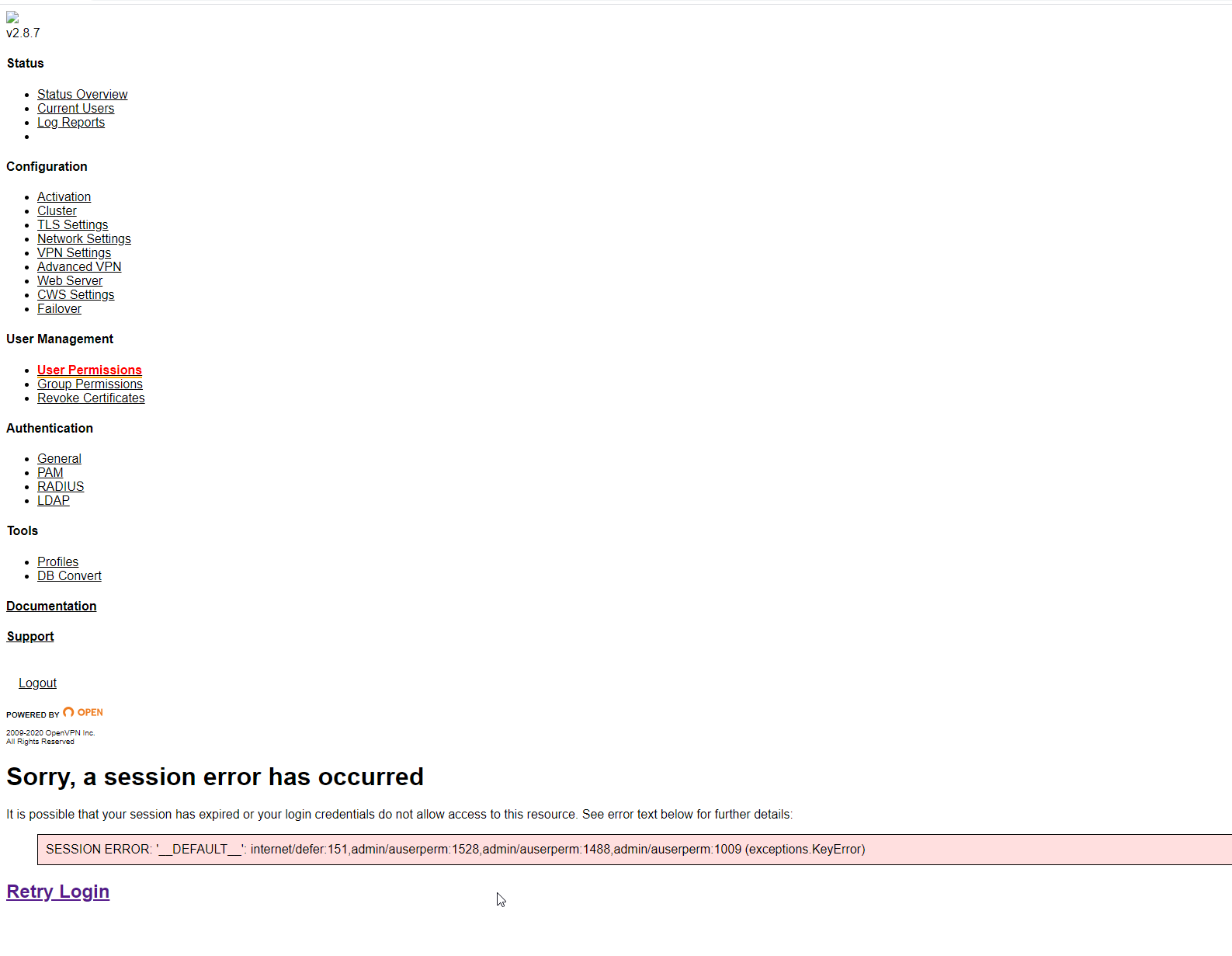

I have been struggling with a fresh installation of this... Everything seems to work fine but when i try to access the 'User Permissions' or 'Group Permissions' with my admin account i got:
Sorry, a session error has occurred
It is possible that your session has expired or your login credentials do not allow access to this resource. See error text below for further details:
SESSION ERROR: '__DEFAULT__': internet/defer:151,admin/auserperm:1528,admin/auserperm:1488,admin/auserperm:1009 (exceptions.KeyError)
Any ideas? Thank you all,

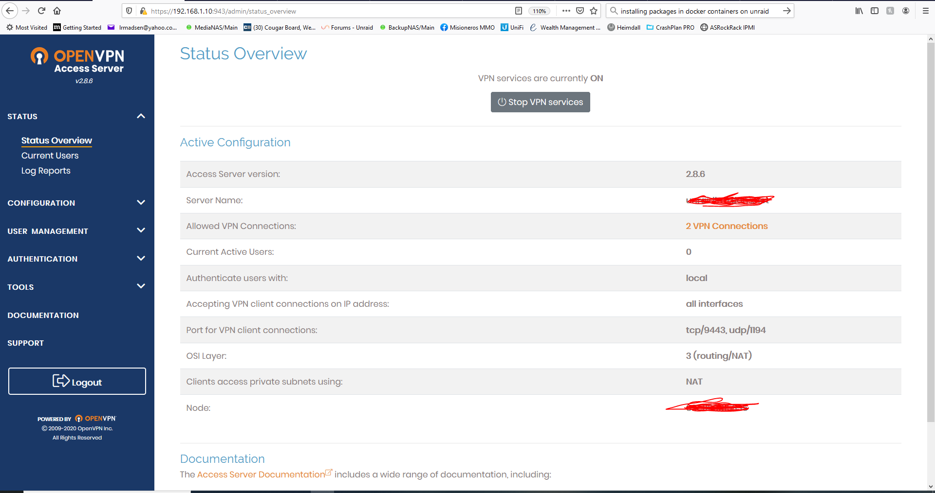

I neither can't see the port even being open. I think that the docker is not really running the openvpn server.
Docker logs: https://pastebin.com/Tw87t1F1
Shouldn't the port 1194 be listed in here?
sudo lsof -i -P -n | grep LISTEN

I have a reverse proxy run through swag (perviously known as letsencrypt) for my own domain name. Currently lets-encrypt and most of the containers I access through that domain are on the reverse proxy BUT my openvpn container is not on the reverse proxy network. It is on the bridge network. Is there any way to direct all traffic to my openvpn subdomain to the normal bridge network instead of the proxy network? I know the easiest solution would be to just put my openvpn container on the reverse proxy network but I don't want it on the reverse proxy for security reasons. Maybe this is the wrong thread for this; If so, it would be great if you could direct me to the appropriate thread.
Thank You.
