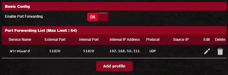

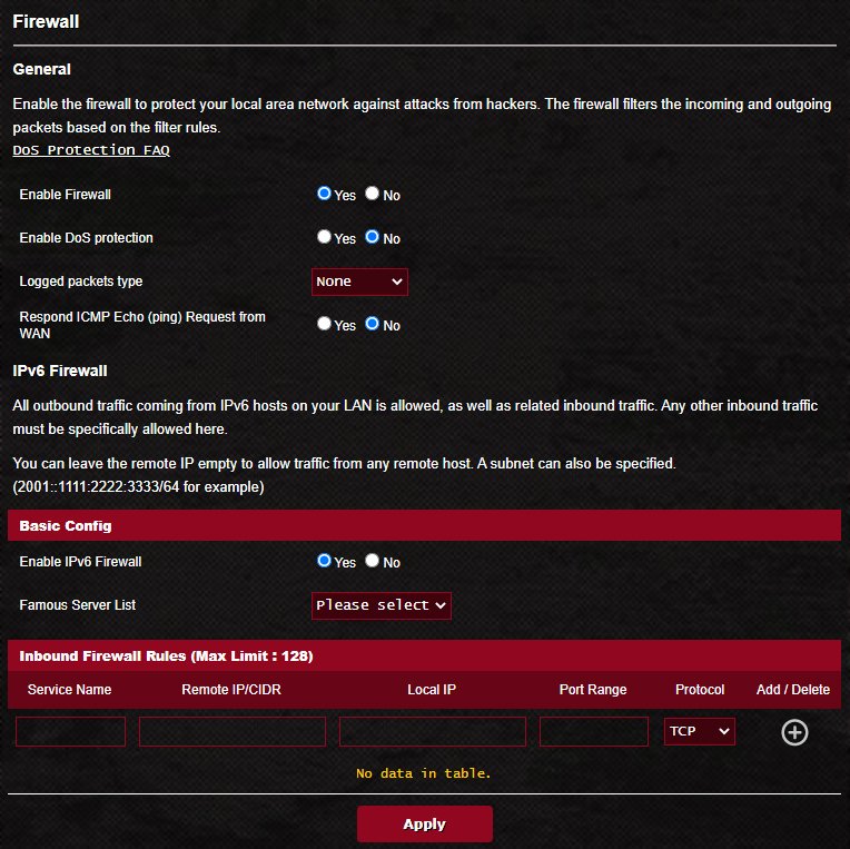

Hi All,
I am new to OpenVPN and unRAID so forgive my Noobness.
I have just set up an unRAID server with OpenVPN installed on it on my LAN at home. I'm using duckdns to update my ip address.
When setting up OpenVPN I followed the Spaceinvader One tutorial video on youtube: https://www.youtube.com/watch?v=fpkLvnAKen0&t=960s

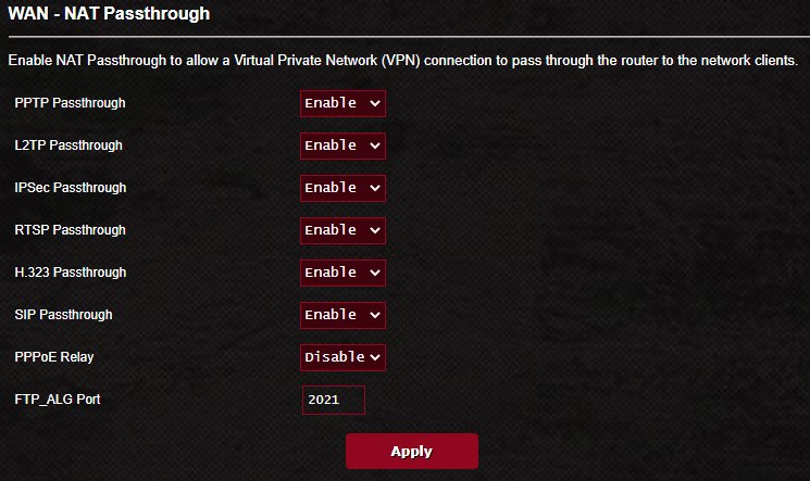

I am trying to connect to the server remotely using my laptop running windows 10. When I configure OpenVPN Server Name to my servers local ip address on the LAN and have my laptop connected to that same LAN I can connect to the server without any issues using OpenVPN. However, when I put the server name as either my duckdns address or my actual ip address (which is dynamic but doesn't change all that often) and try to connect remotely I cannot connect.
I have enabled port forwarding on my ASUS ROG Rapture GT-AX11000 Router forwarding port 1194 for UDP to my server on the LAN. I also tried turning it on for 1194 TCP and also tried TCP and UDP 943 port forwarding.
I tried turning off the firewall on my router as well.
I tried configuring OpenVPN to use port 1194 UDP only, then tried 1194 TCP only and then tried both UDP and TCP 1194 but all with the same result, no luck.
The fact that it works over LAN but not remotely makes me think that there must be some combination of ports/protocols that it wants that I am not doing right.
When I scan the port 1194 with Nmap I get "open|filtered" as the result.
I have done some googling and people are saying that "open|filtered" means Nmap cant tell exactly the condition of the port and that there may be a firewall blocking the packages but I don't know how to further test this theory.
Here is my Docker run command:
root@localhost:# /usr/local/emhttp/plugins/dynamix.docker.manager/scripts/docker run -d --name='openvpn-as' --net='bridge' -e TZ="America/Los_Angeles" -e HOST_OS="Unraid" -e 'PGID'='100' -e 'PUID'='99' -p '943:943/tcp' -p '9443:9443/tcp' -p '1194:1194/udp' -v '/mnt/user/appdata/openvpn-as':'/config':'rw' --cap-add=NET_ADMIN 'linuxserver/openvpn-as'
ddd53f84c0cd0839dd25f6098992671123985c8a16439b3459d68f3fa05673b6

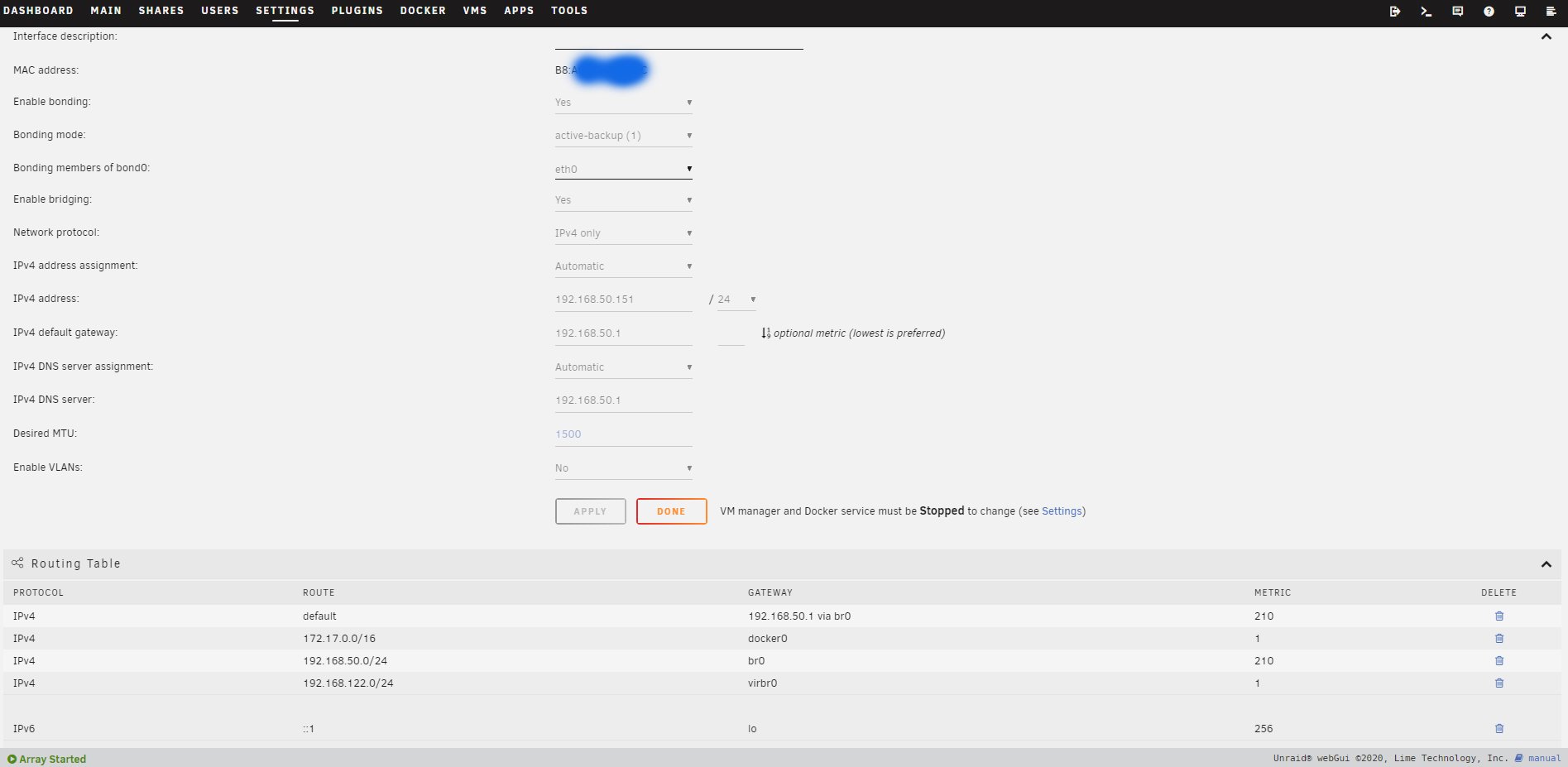

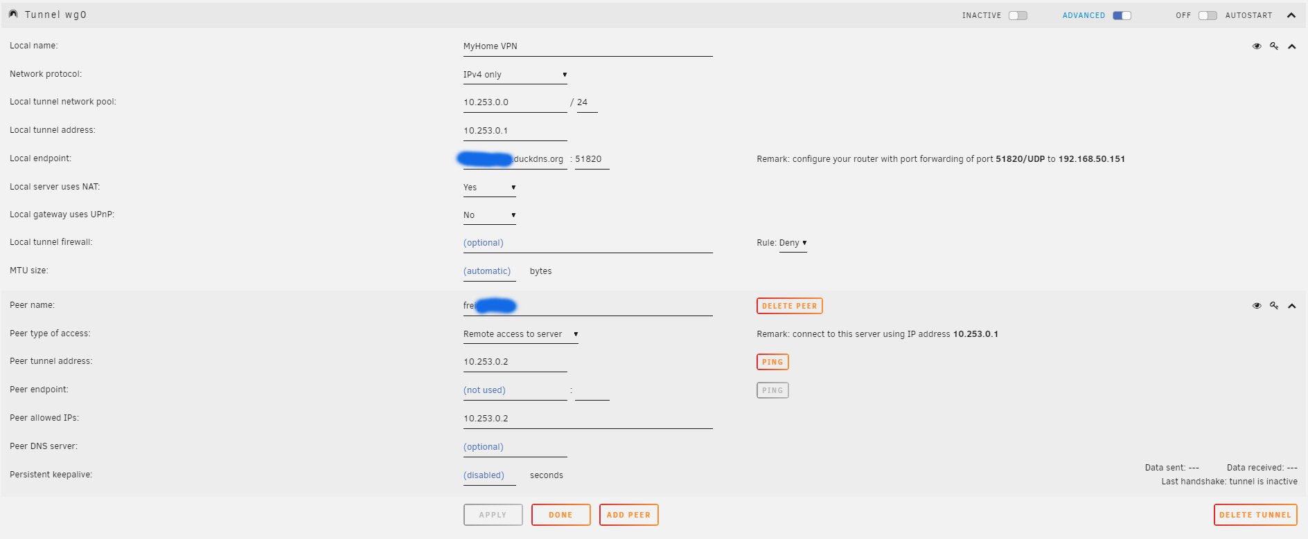

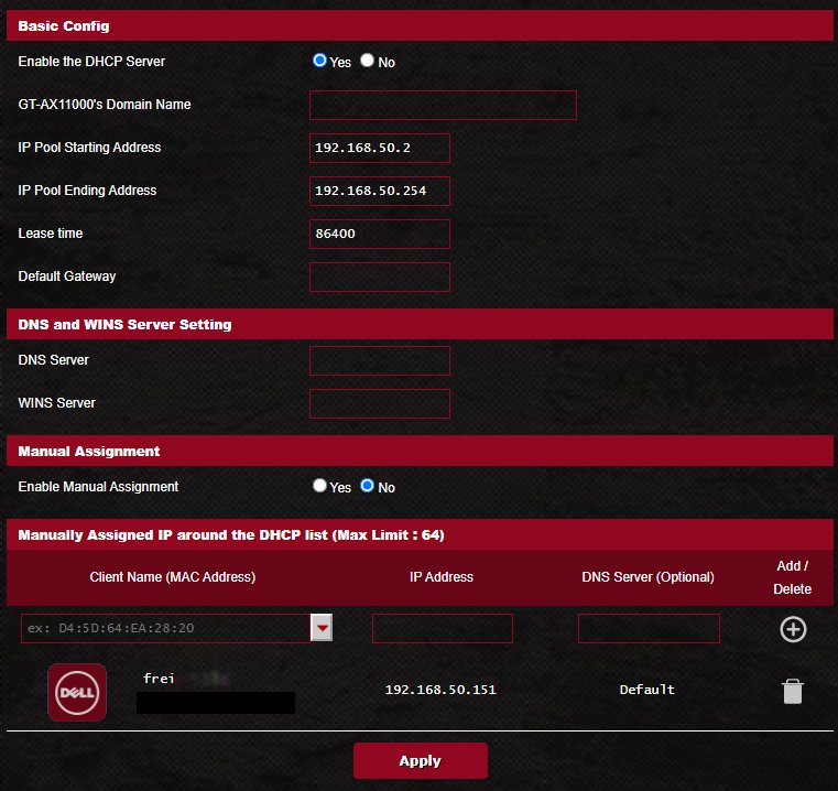

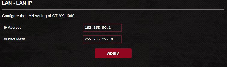

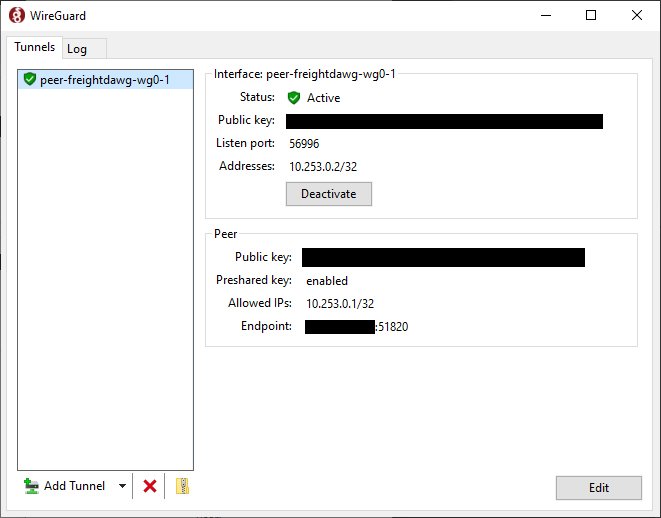

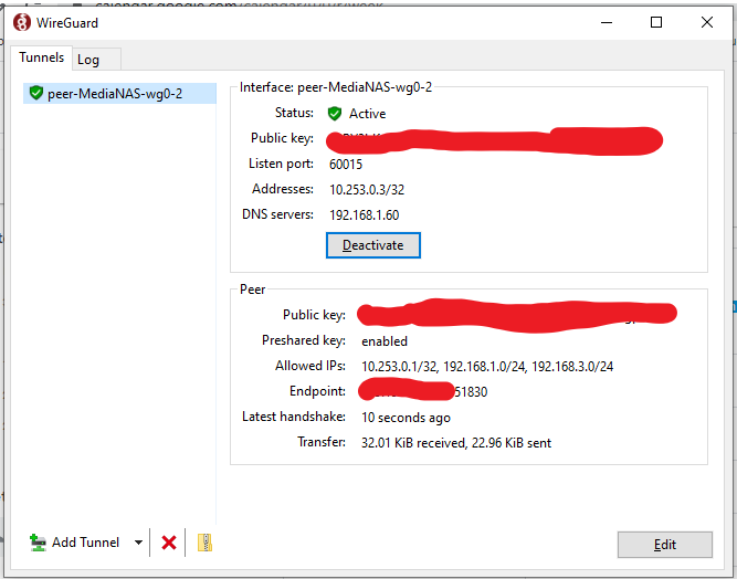

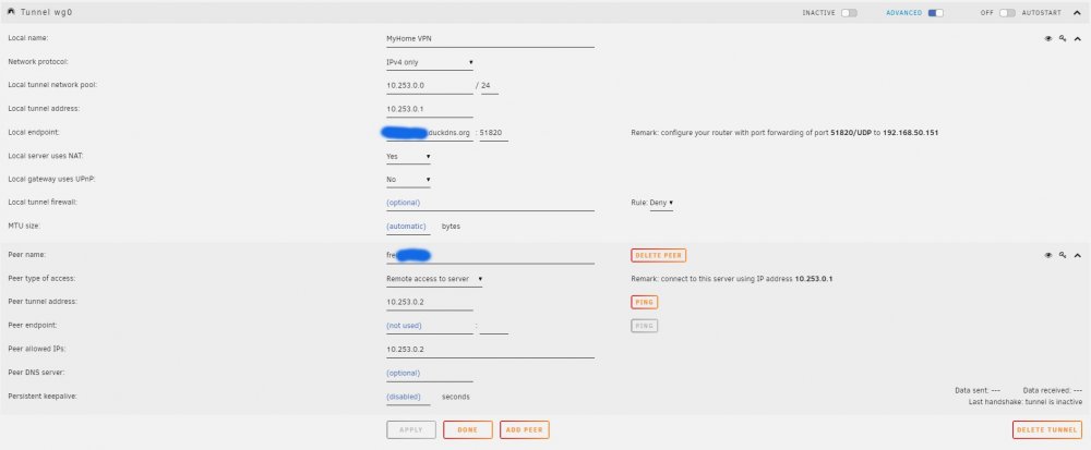

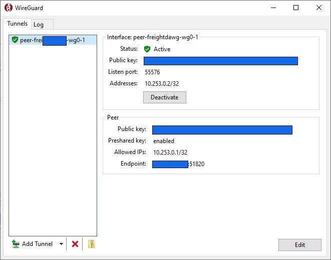

Hi Hoopster,
Thank you so much for your help. I have followed the WireGuard quickstart setup tutorial you gave the link to and the client software seems to be connecting as it is showing as "active" when I connect from the client computer. However, I am unsure how to use it to see and access my server remotely. So far when I type my server's local ip address in to chrome when WireGuard is showing the connection as "active" I still don't get anything loading. It just tries to connect and then says "This site can’t be reached".
Here is a capture of the WireGuard client interface after I click "Activate"
Here is the client log file:
2020-09-18 18:24:01.455340: [TUN] [peer-freightdawg-wg0-1] Starting WireGuard/0.1.1 (Windows 10.0.18362; amd64)
2020-09-18 18:24:01.456334: [TUN] [peer-freightdawg-wg0-1] Watching network interfaces
2020-09-18 18:24:01.458330: [TUN] [peer-freightdawg-wg0-1] Resolving DNS names
2020-09-18 18:24:01.465310: [TUN] [peer-freightdawg-wg0-1] Creating Wintun interface
2020-09-18 18:24:01.831329: [TUN] [peer-freightdawg-wg0-1] Using Wintun/0.8 (NDIS 6.83)
2020-09-18 18:24:01.856263: [TUN] [peer-freightdawg-wg0-1] Enabling firewall rules
2020-09-18 18:24:01.891169: [TUN] [peer-freightdawg-wg0-1] Dropping privileges
2020-09-18 18:24:01.892166: [TUN] [peer-freightdawg-wg0-1] Creating interface instance
2020-09-18 18:24:01.893164: [TUN] [peer-freightdawg-wg0-1] Routine: event worker - started
2020-09-18 18:24:01.895159: [TUN] [peer-freightdawg-wg0-1] Routine: handshake worker - started
2020-09-18 18:24:01.895159: [TUN] [peer-freightdawg-wg0-1] Routine: encryption worker - started
2020-09-18 18:24:01.896157: [TUN] [peer-freightdawg-wg0-1] Routine: decryption worker - started
2020-09-18 18:24:01.896157: [TUN] [peer-freightdawg-wg0-1] Routine: handshake worker - started
2020-09-18 18:24:01.897154: [TUN] [peer-freightdawg-wg0-1] Routine: encryption worker - started
2020-09-18 18:24:01.897154: [TUN] [peer-freightdawg-wg0-1] Routine: decryption worker - started
2020-09-18 18:24:01.898150: [TUN] [peer-freightdawg-wg0-1] Routine: handshake worker - started
2020-09-18 18:24:01.898150: [TUN] [peer-freightdawg-wg0-1] Routine: decryption worker - started
2020-09-18 18:24:01.898150: [TUN] [peer-freightdawg-wg0-1] Routine: TUN reader - started
2020-09-18 18:24:01.898150: [TUN] [peer-freightdawg-wg0-1] Routine: encryption worker - started
2020-09-18 18:24:01.898150: [TUN] [peer-freightdawg-wg0-1] Setting interface configuration
2020-09-18 18:24:01.898150: [TUN] [peer-freightdawg-wg0-1] UAPI: Updating private key
2020-09-18 18:24:01.899149: [TUN] [peer-freightdawg-wg0-1] UAPI: Removing all peers
2020-09-18 18:24:01.899149: [TUN] [peer-freightdawg-wg0-1] UAPI: Transition to peer configuration
2020-09-18 18:24:01.899149: [TUN] [peer-freightdawg-wg0-1] peer(SEly…Hrlk) - UAPI: Created
2020-09-18 18:24:01.899149: [TUN] [peer-freightdawg-wg0-1] peer(SEly…Hrlk) - UAPI: Updating preshared key
2020-09-18 18:24:01.899149: [TUN] [peer-freightdawg-wg0-1] peer(SEly…Hrlk) - UAPI: Updating endpoint
2020-09-18 18:24:01.899149: [TUN] [peer-freightdawg-wg0-1] peer(SEly…Hrlk) - UAPI: Updating persistent keepalive interval
2020-09-18 18:24:01.899149: [TUN] [peer-freightdawg-wg0-1] peer(SEly…Hrlk) - UAPI: Removing all allowedips
2020-09-18 18:24:01.899149: [TUN] [peer-freightdawg-wg0-1] peer(SEly…Hrlk) - UAPI: Adding allowedip
2020-09-18 18:24:01.899149: [TUN] [peer-freightdawg-wg0-1] Bringing peers up
2020-09-18 18:24:01.900145: [TUN] [peer-freightdawg-wg0-1] Routine: receive incoming IPv6 - started
2020-09-18 18:24:01.900145: [TUN] [peer-freightdawg-wg0-1] Routine: receive incoming IPv4 - started
2020-09-18 18:24:01.903137: [TUN] [peer-freightdawg-wg0-1] UDP bind has been updated
2020-09-18 18:24:01.903137: [TUN] [peer-freightdawg-wg0-1] peer(SEly…Hrlk) - Starting...
2020-09-18 18:24:01.903137: [TUN] [peer-freightdawg-wg0-1] peer(SEly…Hrlk) - Routine: sequential receiver - started
2020-09-18 18:24:01.904143: [TUN] [peer-freightdawg-wg0-1] peer(SEly…Hrlk) - Routine: nonce worker - started
2020-09-18 18:24:01.904143: [TUN] [peer-freightdawg-wg0-1] peer(SEly…Hrlk) - Routine: sequential sender - started
2020-09-18 18:24:01.904143: [TUN] [peer-freightdawg-wg0-1] Monitoring default v4 routes
2020-09-18 18:24:01.904143: [TUN] [peer-freightdawg-wg0-1] Binding v4 socket to interface 22 (blackhole=false)
2020-09-18 18:24:01.905132: [TUN] [peer-freightdawg-wg0-1] Setting device v4 addresses
2020-09-18 18:24:02.083655: [TUN] [peer-freightdawg-wg0-1] Monitoring default v6 routes
2020-09-18 18:24:02.085650: [TUN] [peer-freightdawg-wg0-1] Binding v6 socket to interface 0 (blackhole=false)
2020-09-18 18:24:02.088642: [TUN] [peer-freightdawg-wg0-1] Setting device v6 addresses
2020-09-18 18:24:02.228270: [TUN] [peer-freightdawg-wg0-1] Listening for UAPI requests
2020-09-18 18:24:02.228270: [TUN] [peer-freightdawg-wg0-1] Startup complete
Am I going the right way about how to try to access the server or is there something I am missing?
Edited by jorocketoz
With WireGuard active you are just typing in the IP address of the unRAID server in your browser, correct?
Port 51820 is forwarded to unRAID server IP in your router or you have UPnP enabled?  I disable UPnP so I have to manually forward the port in my router config.
Do you have a static route in your router from the tunnel IP subnet to your unRAID server IP address (UPnP may make this unnecessary)?  Mine is 10.253.0.0/24 to 192.168.1.10
Below is a screenshot of my WireGuard tunnel setup.  I have mine configured with a Peer DNS server and for access to a VLAN for docker containers with their own static IP addresses.  That's why I have multiple Allowed IPs ranges.
The endpoint in your screenshot is showing what I assume is your router public IP address?  You may want to obscure that.
Perhaps reading from this post forward in the WireGuard Quickstart thread may help you find a solution.
Edited by Hoopster

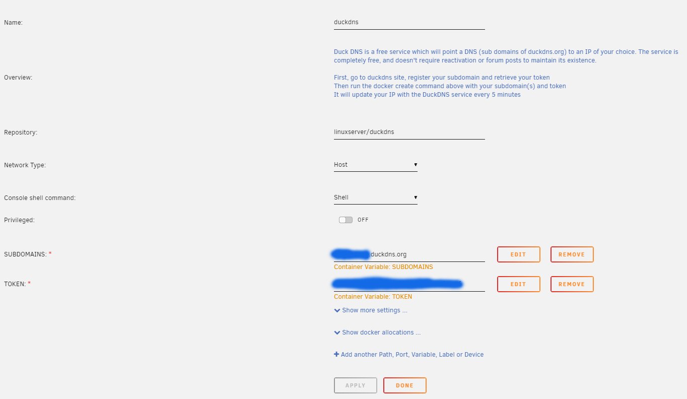

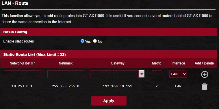

Hey Hoopster,
Yes, with WireGuard active I am just typing the IP address of the unRAID server into my browser and getting "This site can’t be reached".
I first tried leaving UPnP enabled but it didn't work so I disabled it and manually forwarded the port in my router settings.
Since I disabled UPnP I set up a static route in my router but it wouldn't let me do the range of IP's (I could only type "10.253.0.0" not the "/24" at the end).
Thanks, my bad, I didn't even see the IP was showing, I have now edited and blocked the IP on the image attached.
I followed the Quickstart Guide link you posted and tried following the steps but it still isn't working.  As such I have just taken a bunch of screenshots of what I believe are the relevant settings pages in the router and on the unRAID server and posted them below so that maybe you can see what I am doing wrong:

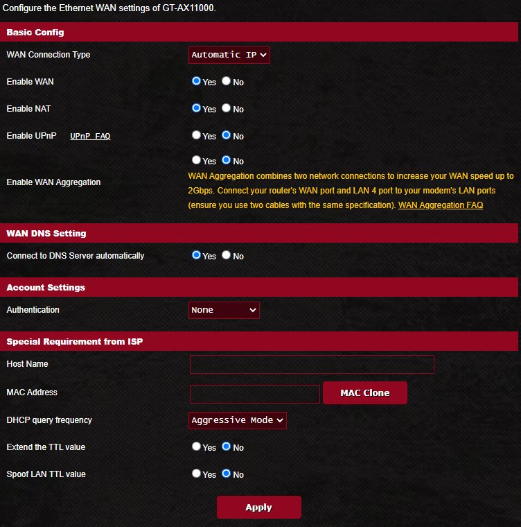

Firewall
LAN DHCP
LAN IP
LAN Route
WAN NAT Passthrough
WAN Port Forwarding
WAN UPnP off
Dashboard VPN and WireGuard Client "Active"
2079141240_VPNDashboardVPN.jpg.48b0500a6863d5bda67973d5e3bafe54.jpg454676077_Wireguardclient.jpg.ccf32e4ff0f3067d1d73a3de18a7446e.jpg
unRAID Settings Network Settings
unRAID Settings VPN Settings
unRAID DuckDNS settings
I know its a lot of screenshots but maybe it will enable you to see where I have gone wrong.
Kind regards.
