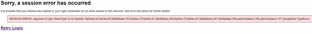

Since last week my OPENVPN-AS does not work properly so I delete the hole container and also the appdata folder of OPENVPN_AS. Next I reinstall the docker end followed the setup guide like the video of spacevaderone
But for some reason I could not remove or disable the admin user. So, I create an new user with admin rights. Login with the new admin user end next I disable, change password etc. But nothing works. After loginout or restarting the docker the admin user is back with his default password and username.
I also tried to edit the AS.CONF file located in the appdata folder of OPENVPN but when I change the rule to  # boot_pam_users.0=admin and reboot the docker. The admin cannot login anymore, so I thought problem solved. But unfortunately when I tried to login with my new username I receive the error from the attachment.
Hopefully someone knows the right solutions and will tell me how to solve.
Thx.
Thx.
https://docs.linuxserver.io/images/docker-openvpn-as#application-setup
30 minutes ago, MasterMark said:
Thank you. the IMPORTANT NOTE did the trick
IMPORTANT NOTE: Commenting out the first pam user in as.conf creates issues in 2.7.5. To make it work while still blocking pam user access, uncomment that line and change admin to a random nonexistent user as described above.

I'm not sure if this is the right place to post this but I just updated to unraid 6.8.1 and updated openvpn-as but now it doesn't work. (unable to connect with phone like before). I also can not pull up the web gui as well. I deleted the open-vpn from the docker and reinstalled but it still doesn't have websui. it simply says unable to connect.
Also I connected to it right before the server update and docker update just fine. Any ideas what is going on?
