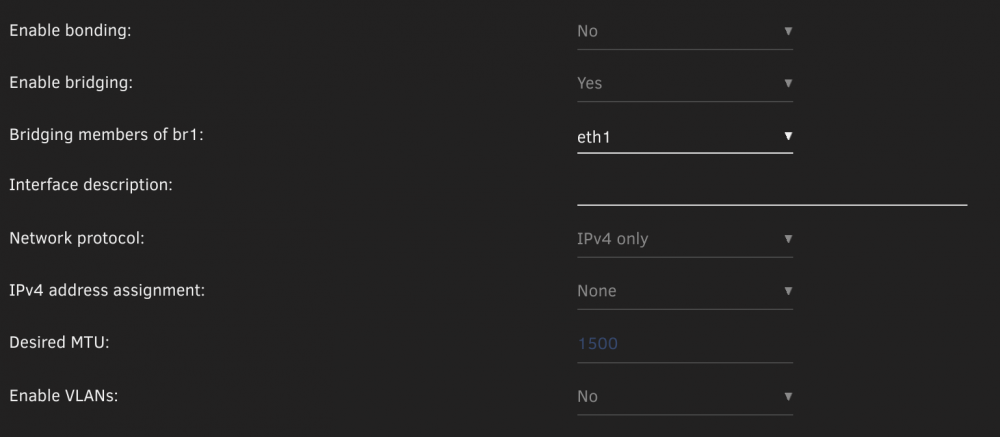

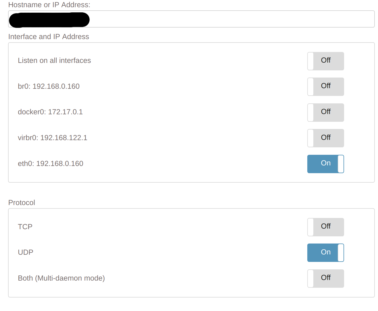

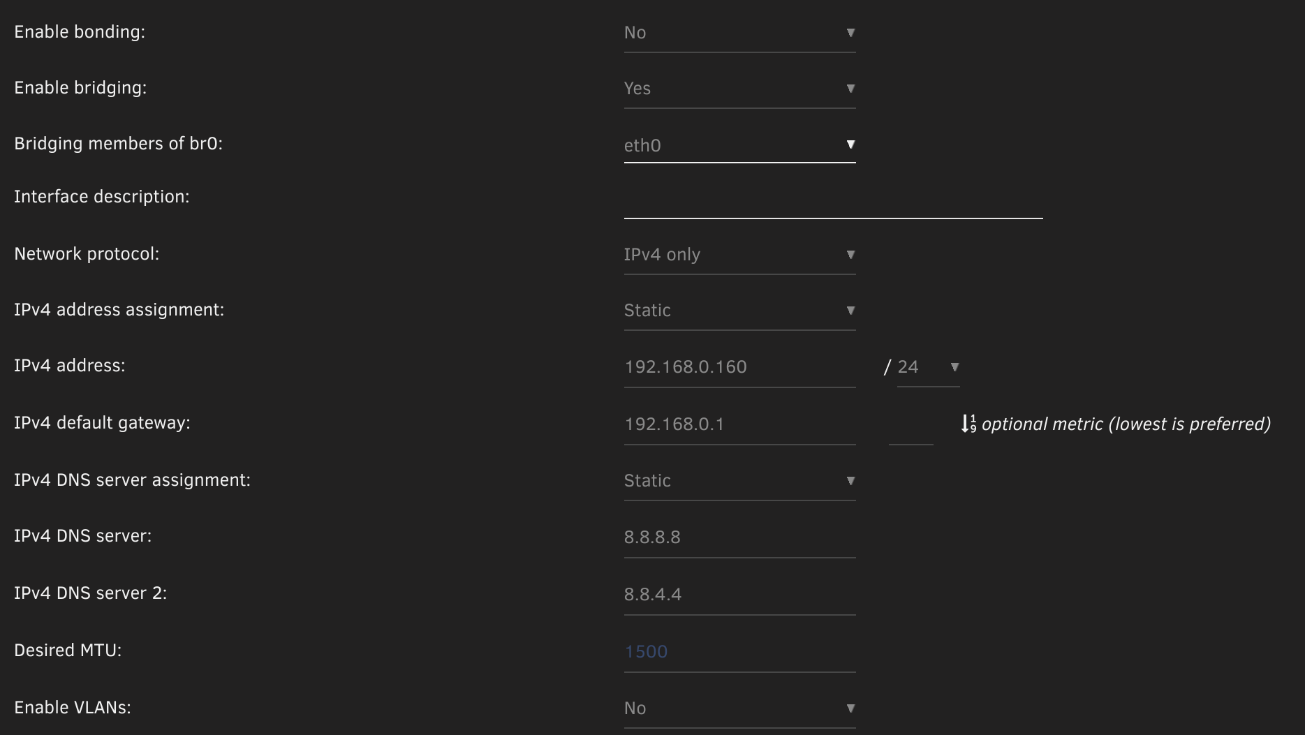

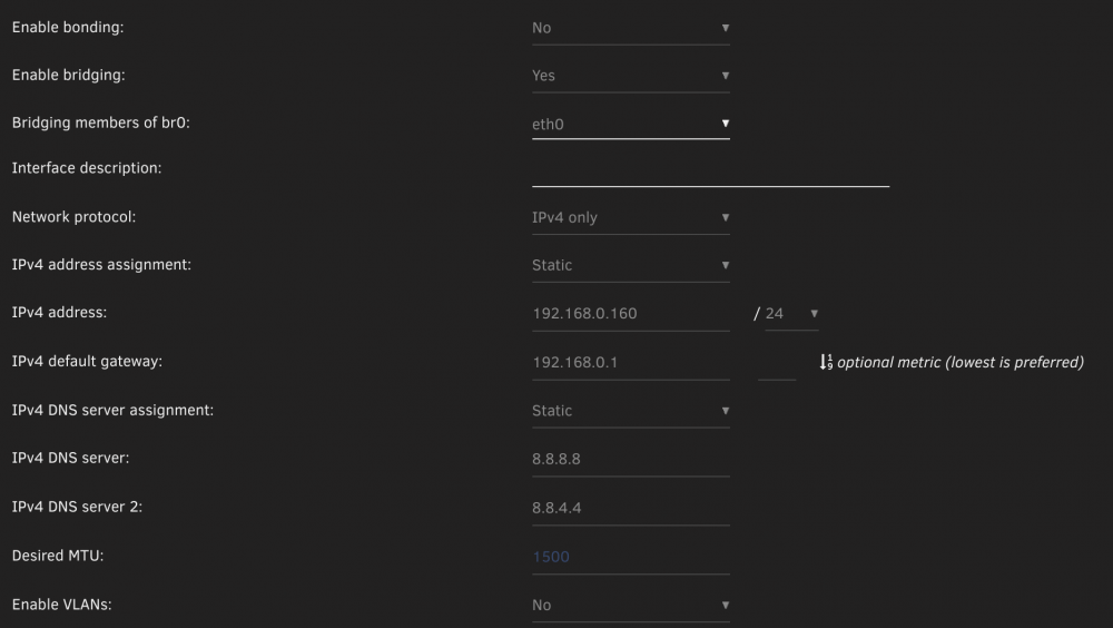

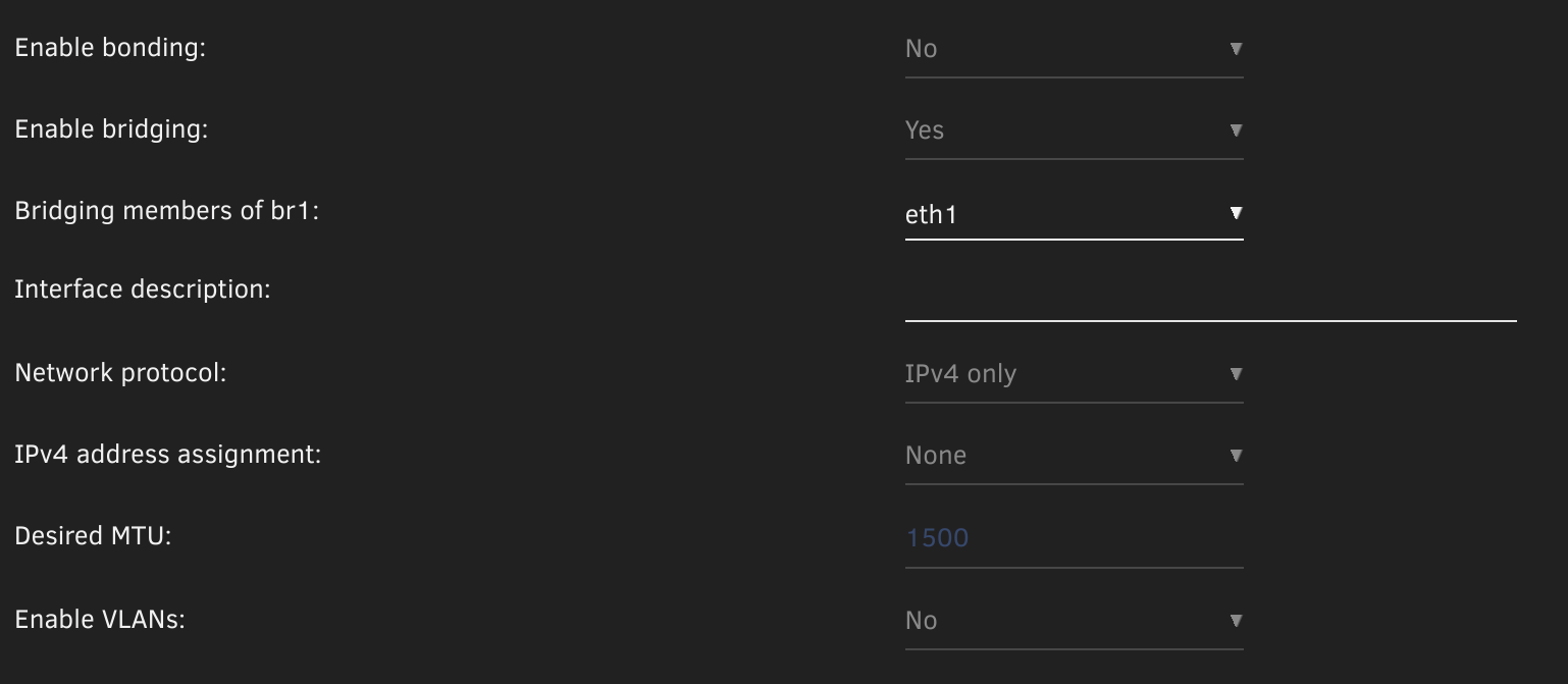

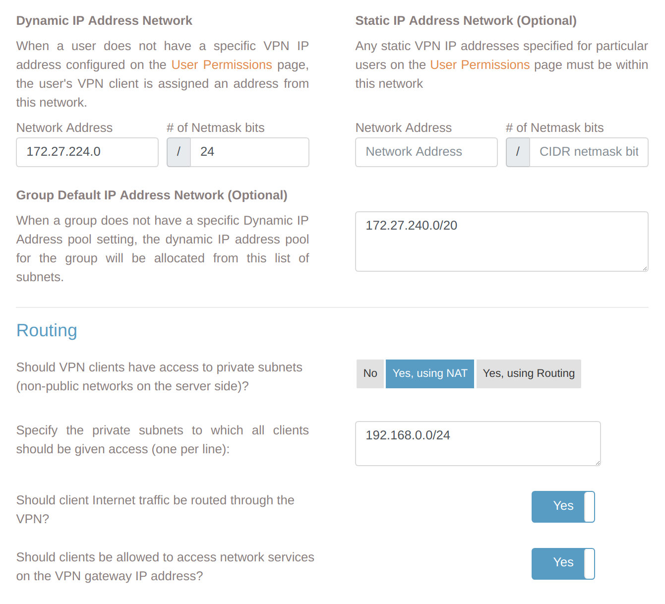

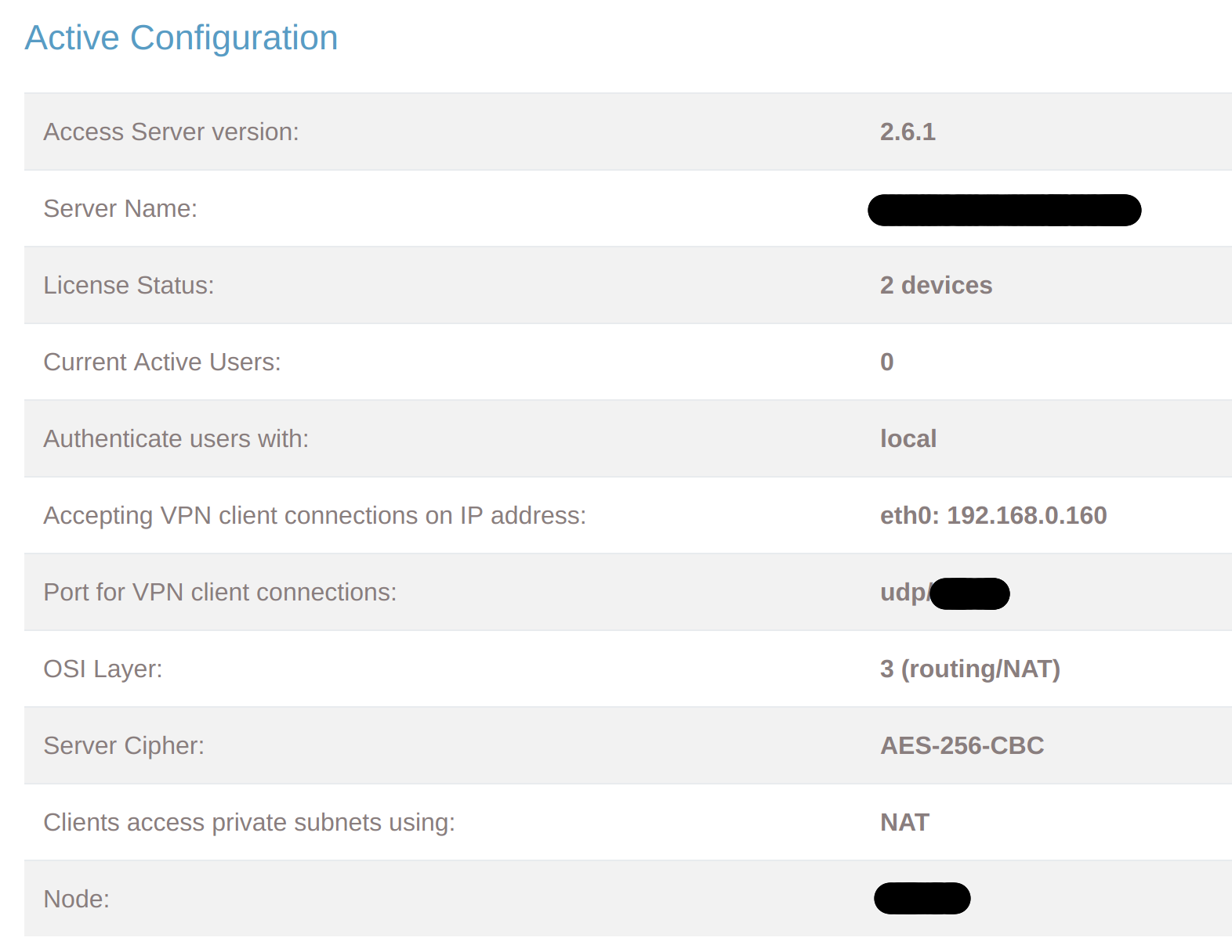

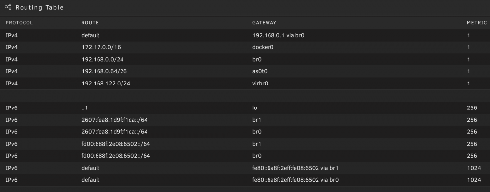

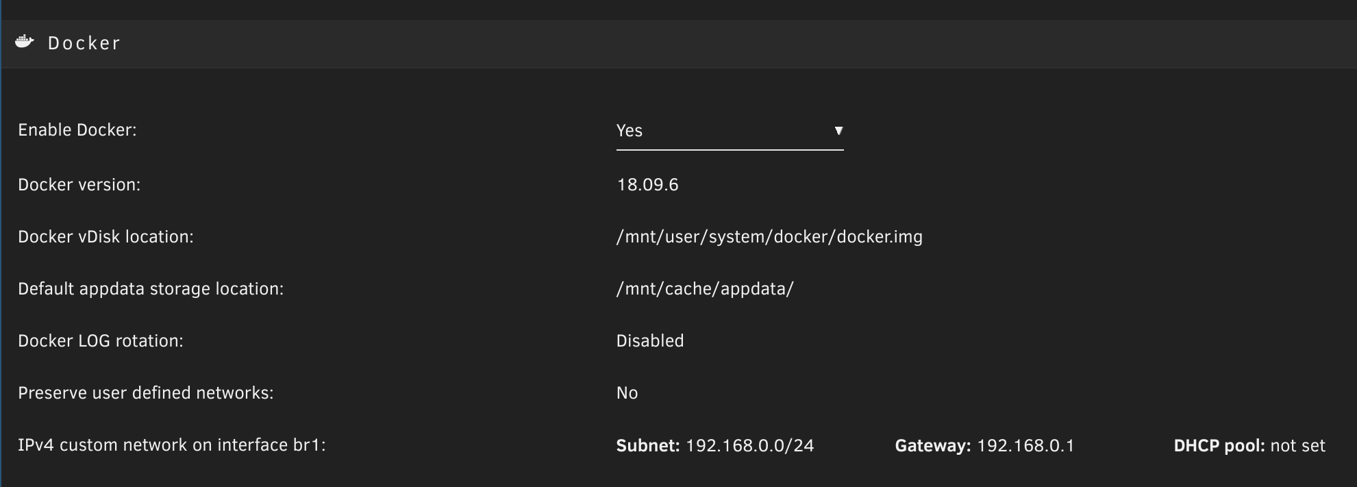

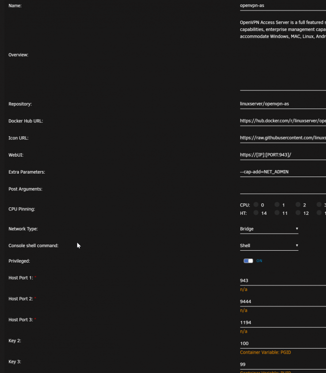

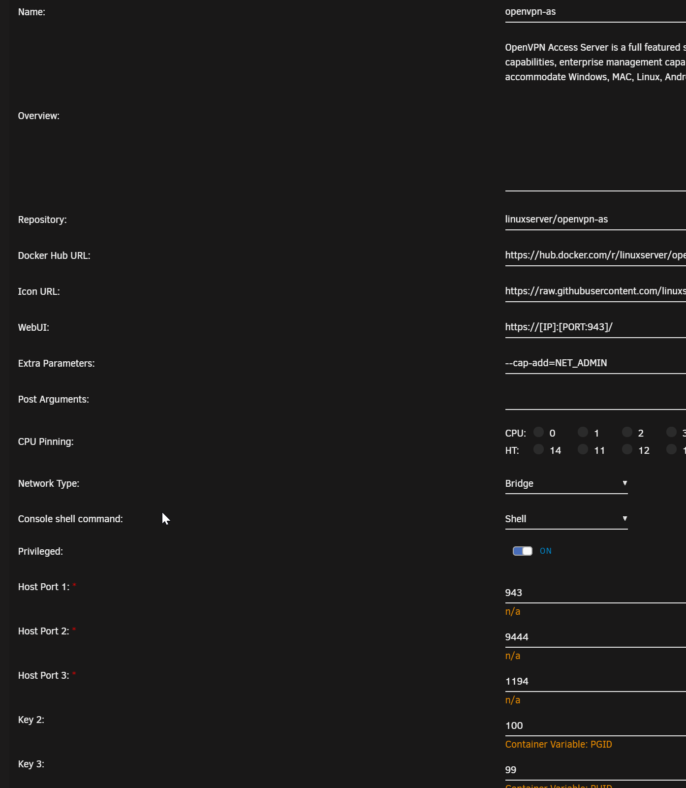

17 hours ago, ken-ji said:
@Jenardo can you show the actual network settings? ip addresses and routes? and the same info from within the openvpn-as container?
1457630716_2019-09-05-193029_2560x1600_scrot.thumb.png.27312f26cf74030ee28e2eaed3c3fea9.png
1976724185_2019-09-05-193035_2560x1600_scrot.thumb.png.9e4a57b63499f499a284cd0f391c4e6f.png
450749094_2019-09-05-193057_2560x1600_scrot.thumb.png.ef87fff2624d6a10fdd391016951ef86.png
594937250_2019-09-05-193112_2560x1600_scrot.thumb.png.9b493104a0e7a6f624436e7c338cfb82.png
2123423010_2019-09-05-193132_2560x1600_scrot.thumb.png.1c3944bfe22ea7046fb9433905b47cb2.png
806922558_2019-09-05-193217_2560x1600_scrot.thumb.png.6fc1431d4c6c7abee363cbc8f821c48d.png
334261462_2019-09-05-193538_2560x1600_scrot.thumb.png.5744cc841391e087d04a354dbd74f347.png
Thanks for taking a look at this!
The only thing I see that could be wrong is that your openvpn-as copintainer is in host mode right? if so, make sure its bound to br0 not eth0 (I think that's how bridges should be used.) Does the openvpn-as container work in custom network mode work? (set to br1 with own IP address)
