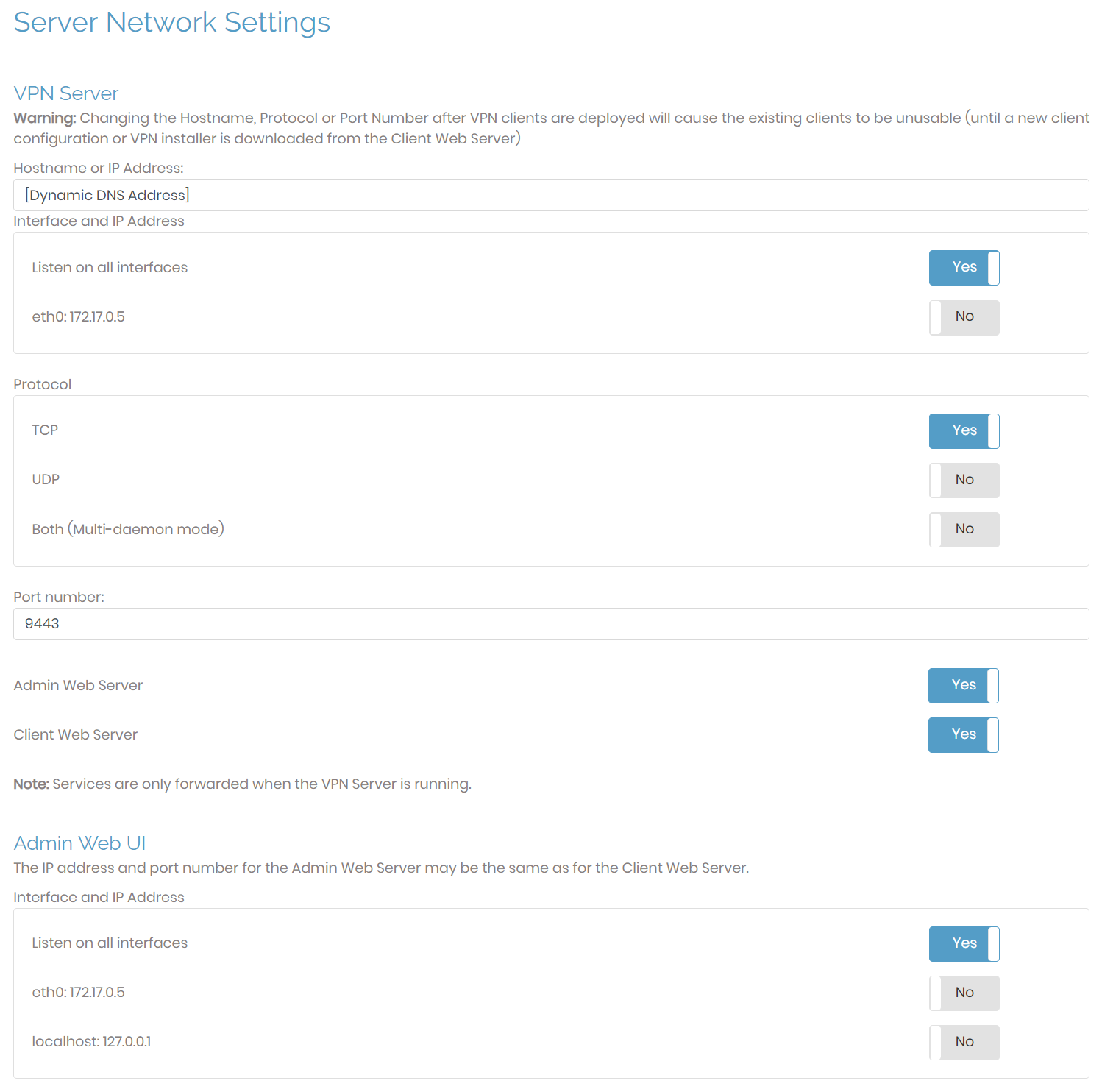

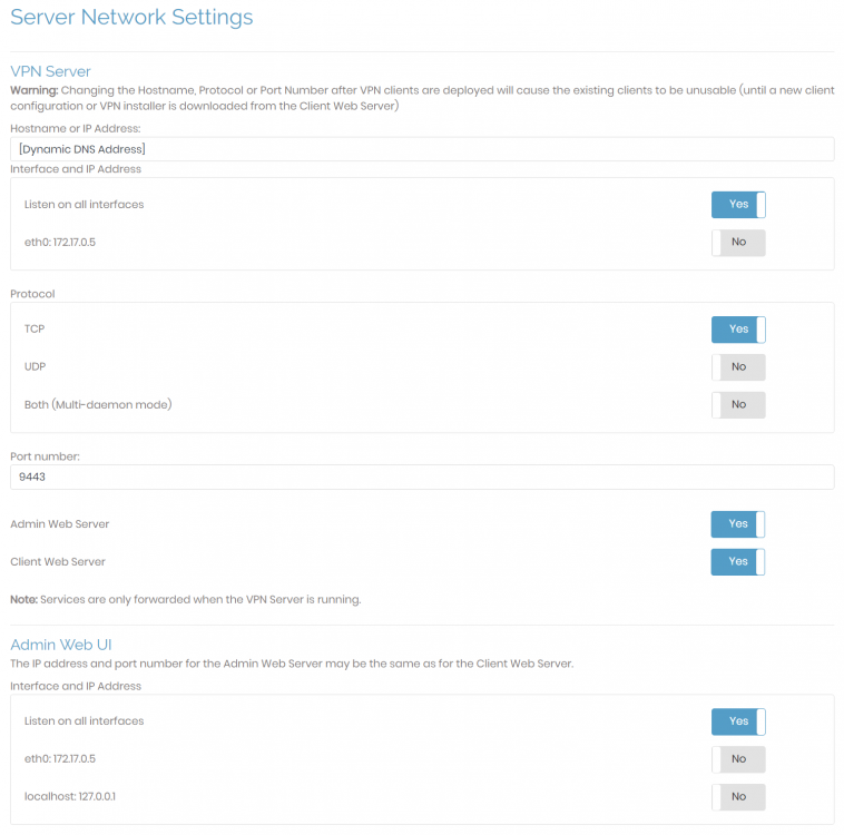

On 6/7/2019 at 4:26 AM, dajinn said:
Go into your Access Server settings and change the hostname from the docker IP to your public IP/hostname.
I thought I had the answer with this as well but this is not working for me. I have my Dynamic DNS hostname in place which I use for other services so I know it's resolving properly. However, when I try to connect from my phone I see it trying to connect to the Docker Containers IP address which is 172.12.0.5. I should mention that the Open Port Checker at https://www.yougetsignal.com/tools/open-ports/ shows that 9443 is open. So I know it's got to be an issue with the app config. Here are a few screen grabs of my network config for OpenVPN-AS. I temporarily masked my Dynamic DNS address for the grab.

Download a new client config. Your current config was generated before you fixed the hostname on your server.
Yup that did it! Thank you so much! Hope this helps someone else as well!

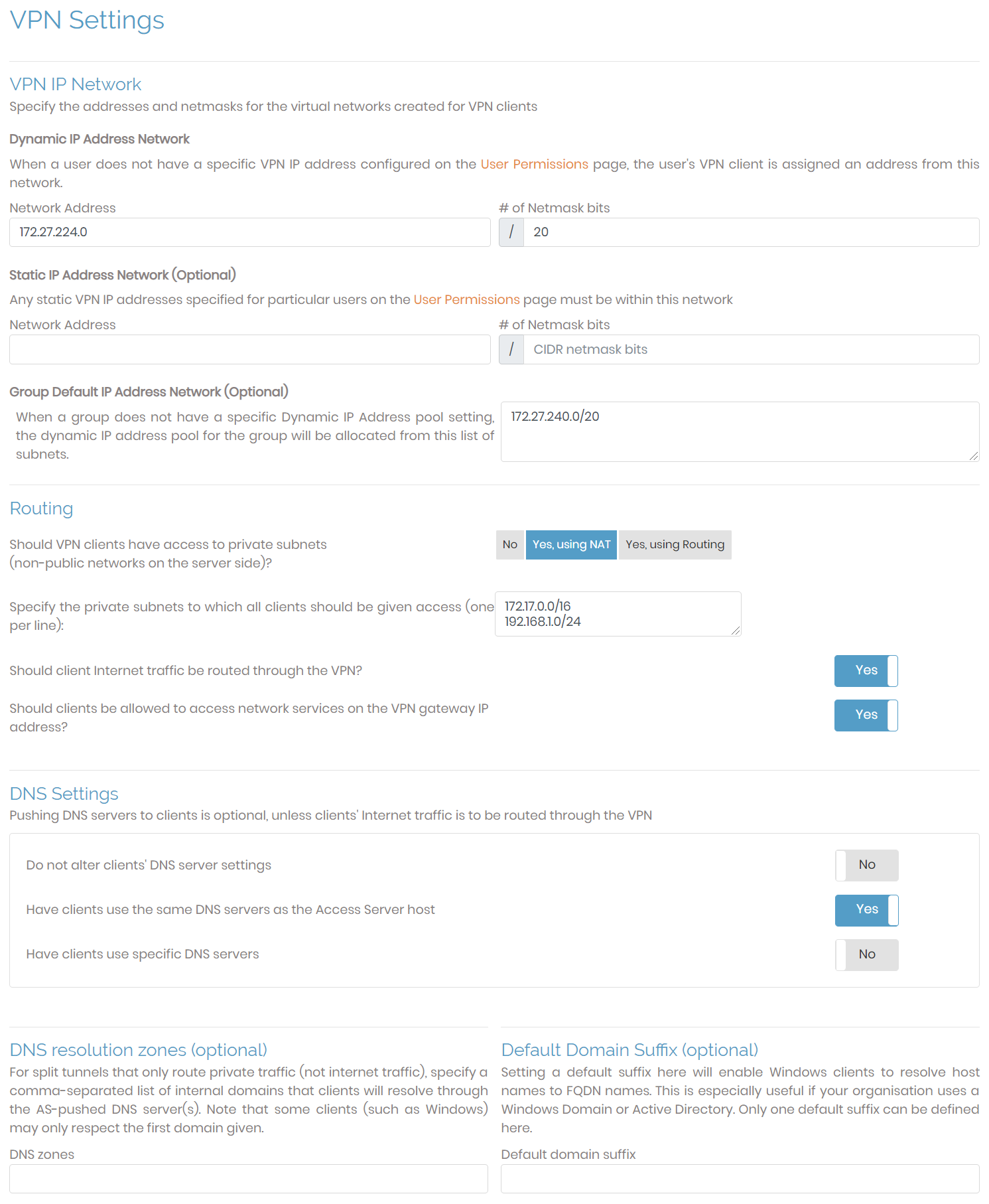

Hi guys,
looking for some advice I am on the latest version of Unraid using PFSENSE VM as my firewall/router.
When I install the openvpn-as non of the options i select allows me to connect to the openVPN management gui
Has anyone else got this setup working and have the time to point me in the right direction
Thanks
Ant

1 - once i connect via openvpn I am unable to reach my internal subnet of 192.168.1.0/24 not sure why the automatic NAT rules are failing

2 hours ago, antohind said:
Hi yeah, after playing around i figured out I can configure OpenVPn directly onto the PFsense VM :)
It's almost ready just have a few issues still
Not to sound like a brokren record, but did you add your subnet in the routing info in the server, as the new ovpn spits out an ip in the subnet of the docker as default.
