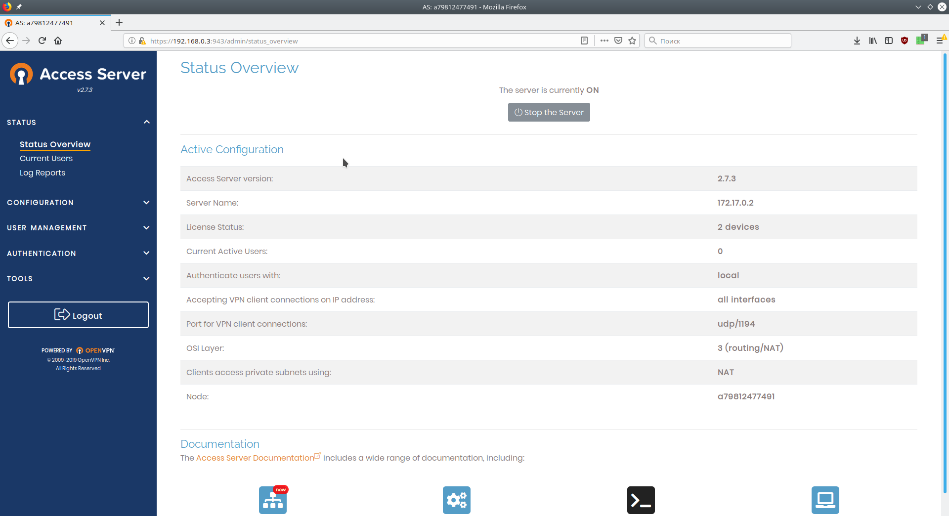

  • PSA. It seems openvpn pushed another broken bin, tagged 2.7.3 I get the same error with it as I did with the previously pulled 2.7.2   While they/us try to figure it out, you can change

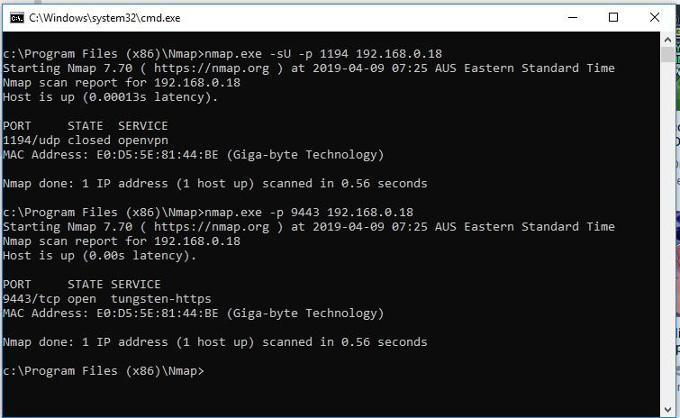

Did you forward the udp port on your router as udp?
yep, nothing changed.  Port was forwarded and it was working fine before the update.  If i nmap the udp port from my local PC to the server it is showing as closed.
What’s your run command Sauso?
If you run in bridge mode with privileged=off, you also need --cap-add=NET_ADMIN
This was missing for me, probably because I’ve just been updating without problems for a long time and am using a very old template. It was causing all sorts of problems until I fixed it.
Just a thought, might not be your problem.

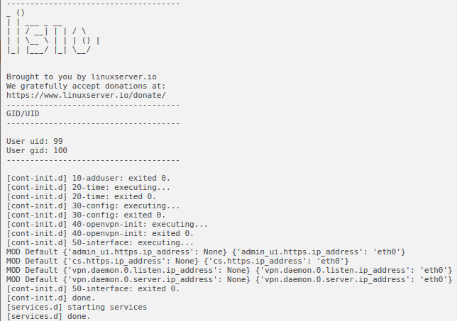

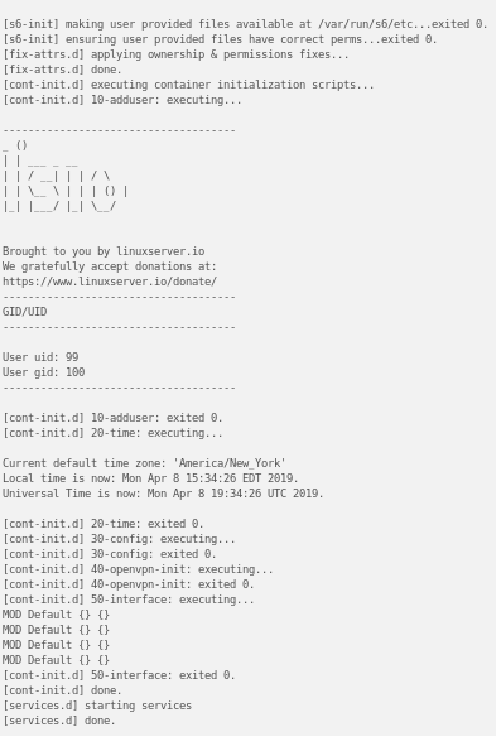

I was also having problems getting openvpn-as back up and going.
Tonight I made sure everything was completely deleted and the I download the linuxserver version using the Apps tab.  This way it wouldn't be using any of the settings that I might have in my personal dockers (I don't know if this part really mattered though).
After I first ran the docker I saw these errors in my log file:
But after that the web UI was working again.  I stopped and started the docker and everything seemed to come back fixed:
The last part I had difficulty with was figuring out where I could download the connection profile.  I finally found that if I changed "https://###.###.###.###:943/admin/" to be "https://###.###.###.###:943/?src=connect", I was able to download what I needed.  I'm sure there is an easier way but this did seem to work.
Everything seems to be back in order!  Sorry for such a long post, but I thought it might be helpful to see what I saw.
image.thumb.png.1d8f95225e2bfaf582cb67060238c2a9.pngimageproxy.php?img=&key=00b562fcac28e727
imageproxy.php?img=&key=00b562fcac28e727image.thumb.png.46c12cd3cc160eb90b81359da3816960.png
Those errors are harmless. The openvpn package is trying to start itself via systemd after install and also after init and it's failing because there is no systemd service inside the container. We manage it with s6, so you can ignore those errors.

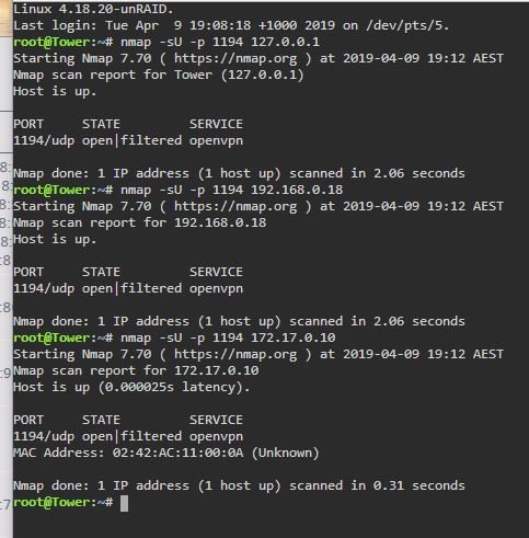

Hey Jorgen,
Below is my docker run.  It already has NET_ADMIN in it so i'm at a loss.
docker run -d --name='openvpn-as' --net='bridge' -e TZ="Australia/Sydney" -e HOST_OS="Unraid" -e 'PGID'='100' -e 'PUID'='99' -p '943:943/tcp' -p '9443:9443/tcp' -p '1194:1194/udp' -v '/mnt/user/appdata/openvpn-as':'/config':'rw' --cap-add=NET_ADMIN 'linuxserver/openvpn-as'
This is where is gets really bizarre.  If if terminal into my unraid box and run  an nmap to the container the port is open.   I can even connect to localhost, the IP of my unraid box and the ip of the container all successfully.  But as soon as i try from another device it shows as blocked.
Anyone else have any ideas?
***EDIT***
Still scratching my head so i decided to setup the openvpn appliance.  changed my port forward to the new appliance and it worked first time.
Could it be my Unraid server blocking the connection??
**FINAL EDIT**
So i'm a muppet.  Something funky must have been going on in my Unraid box.  Restarted it and it came good straight away...  I forgot rule 1 of tech support.  Have you tried turning it off and on again....
Edited by sauso

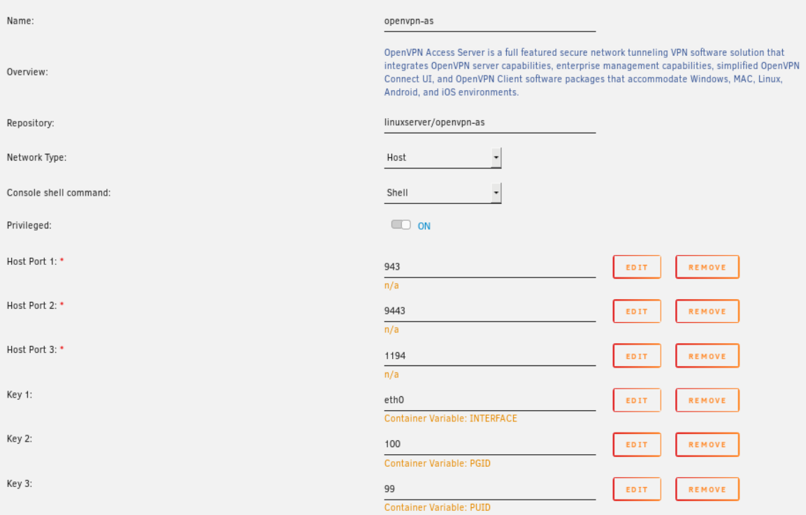

I'm finally getting around to fixing openvpn-as, and it looks like I'm a few weeks behind all the threads. My openvpn-as stopped connecting, can't get to web-ui either. I deleted the docker, image, and appdata. The new settings don't match what Spacedinvader's video has, there's no INTERFACE section. A bunch of the defaults that come up are not the same.
When I just do the best I can in there, and hit Apply, still no web-gui. I see that some folks posted
docker pull linuxserver/openvpn-as:2.6.1-ls11
But I can't get this command to work in either the Main ">_", or in the docker Console >_
docker pull
does return a message, so there is a "docker" command in the Main console, but it gets confused when I put the rest of the "linuxserver/openvpn-as:2.6.1-ls11" on the line, also with "double quotes".
I tried installing the docker, then updating the Repository in the Docker template to "linuxserver/openvpn-as:2.6.1-ls11" but I still don't get any of the correct fields.
Would someone spell out the steps for rolling this back correctly to make it work for the interim? Including turning off auto-update to keep it from breaking automatically during the next update?
whuffie in advance.

So basically you did everything but read the official documentation?
See here for the most accurate info: https://hub.docker.com/r/linuxserver/openvpn-as
Or here: https://github.com/linuxserver/docker-openvpn-as
You may have missed the cap add statement.
If it still doesn't work after that, check the logs (both the docker log and the log folder under config folder)
@aptalca you are exactly right, I'm guilty of RTFM no doubt. I did try and read it, but it was beyond me.

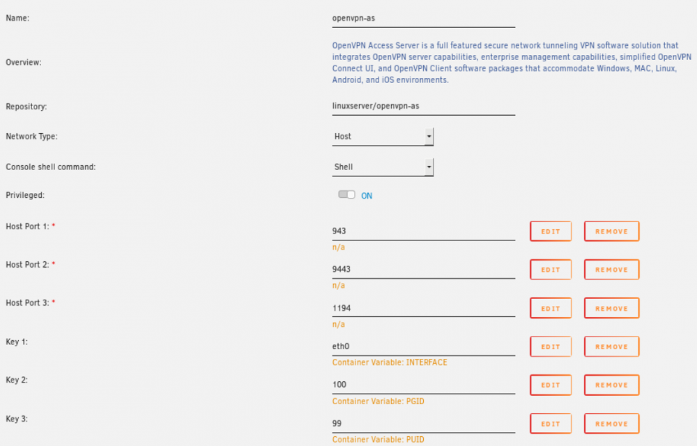

[SOLVED]
I got the regular docker template, and made some changes/additions.
Repository: "linuxserver/openvpn-as:2.6.1-ls11"
Network type: Host
Privileged: ON
and had to add a couple VARIABLES, I think: INTERFACE, and one of the PGID or PUID variables too.
Once I muddled through those bits, it came back up. It did take a minute or two. It was tripping over something initially (something about finding an old configuration, and I should run command DELETE), but I didn't do anything, and it came up. I don't see any errors in the logs any longer.
Weird that I had to make additions and changes to the template. Last time, it was only a couple changes that @SpaceInvaderOne made in his video. But it's a little old now, 12/2017.
Edited by dkerlee

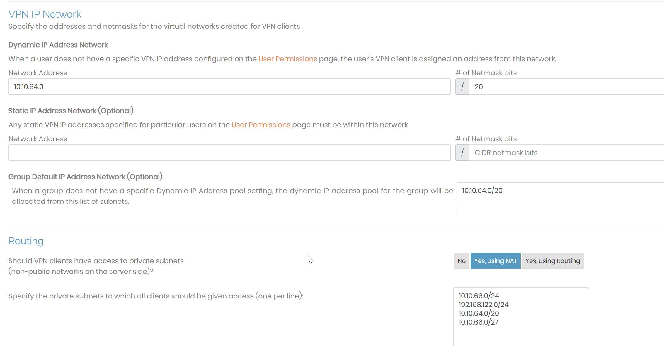

I have been messing about for about 5 days trying to get this to work but finally I have it sorted (using bridging only). Because port udp 1194 is already in use on my system I have been mapping to a different external port. But after downloading the ovpn file for the client I was constantly getting the server poll time out.
What I have found seems to indicate the connection file you download from the gui only contains the container port for connection. If you are doing a straight 1194:1194 this makes no difference. But if for example you keep 1194 internal and map to say 1200 externally, the file will still contain 1194. If you change the internal port through the gui to match 1200, the file will contain 1200 but I don't think the container actually updates to use that port and remains using 1194.
What I did was leave internal port at 1194. Set an alternative external port, say 1200. Download the ovpn file. It will contain 1194 in it. Edit the file changing the 1194 to the 1200. Then import that file into client. It works!!!

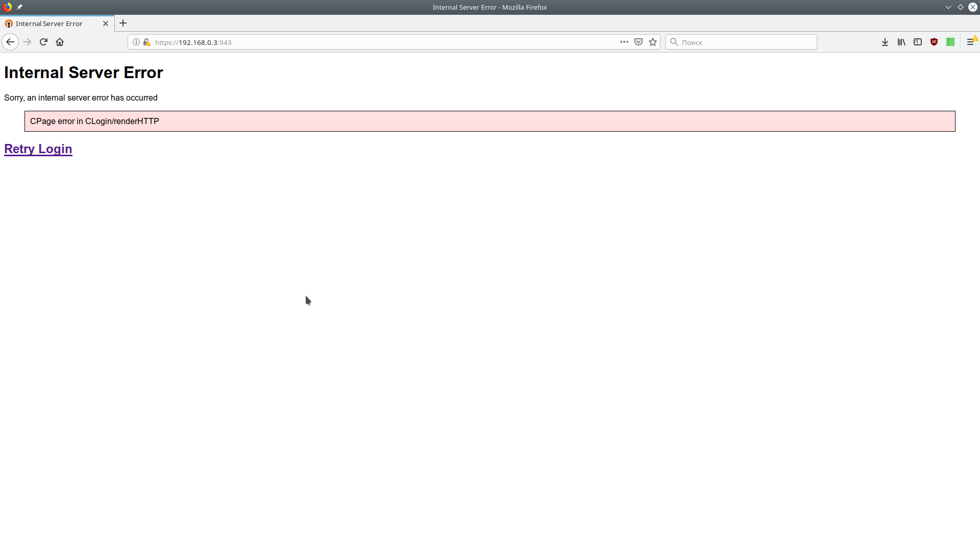

Good afternoon, I launched the container
docker run -d --name='openvpn-as' --net='bridge' -e TZ="Australia/Sydney" -e HOST_OS="Unraid" -e 'PGID'='1000' -e 'PUID'='1000' -p '943:943/tcp' -p '9443:9443/tcp' -p '1194:1194/udp' -v '/home/user/openvpn-as':'/config':'rw' --cap-add=NET_ADMIN 'linuxserver/openvpn-as'
 Everything worked well.
But when I try to log in to the user, I get an error
Internal Server Error
Sorry, an internal server error has occurred
    CPage error in CLogin/renderHTTP
Retry Login
There is an error in the logs
019-04-22T18: 52: 03 + 1000 [twisted.python.log # info] "-" - - [22 / Apr / 2019: 08: 52: 02 +0000] "POST / RPC2 HTTP / 1.0" 200 201 "-" "Twisted / XMLRPClib"
2019-04-22T18: 52: 03 + 1000 [twisted.python.log # info] "-" - - [22 / Apr / 2019: 08: 52: 02 +0000] "POST / RPC2 HTTP / 1.0" 200 8597 "-" "Twisted / XMLRPClib"
2019-04-22T18: 52: 03 + 1000 [stdout # info] [WEB] OUT: "2019-04-22T18: 52: 03 + 1000 [stdout # info] CPage exception in CLogin / renderHTTP: 'hostname': connect / clogin: 147, connect / cpage: 84 (exceptions.KeyError) "
2019-04-22T18: 52: 03 + 1000 [stdout # info] [WEB] OUT: '2019-04-22T18: 52: 03 + 1000 [twisted.python.log # info] "192.168.0.14" - - [ 22 / Apr / 2019: 08: 52: 03 +0000] "GET / HTTP / 1.1" 500 798 "-" "Mozilla / 5.0 (X11; Ubuntu; Linux x86_64; rv: 66.0) Gecko / $ 2
Docker works in a virtual machine
uname -a
Linux debian 4.9.0-8-amd64 #1 SMP Debian 4.9.144-3.1 (2019-02-19) x86_64 GNU/Linux
df -h
udev               1,5G            0  1,5G            0% /dev
tmpfs              302M         4,3M  297M            2% /run
/dev/sda1           15G         2,2G   12G           16% /
tmpfs              1,5G            0  1,5G            0% /dev/shm
tmpfs              5,0M            0  5,0M            0% /run/lock
tmpfs              1,5G            0  1,5G            0% /sys/fs/cgroup
tmpfs              302M            0  302M            0% /run/user/0
Unfortunately I could not find information on this error.
Above scott47 wrote, he managed to log in by changing the address to
https://ip:943?Src=connect
It helped me too.

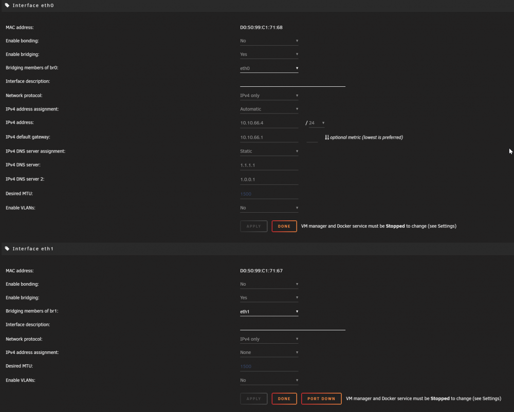

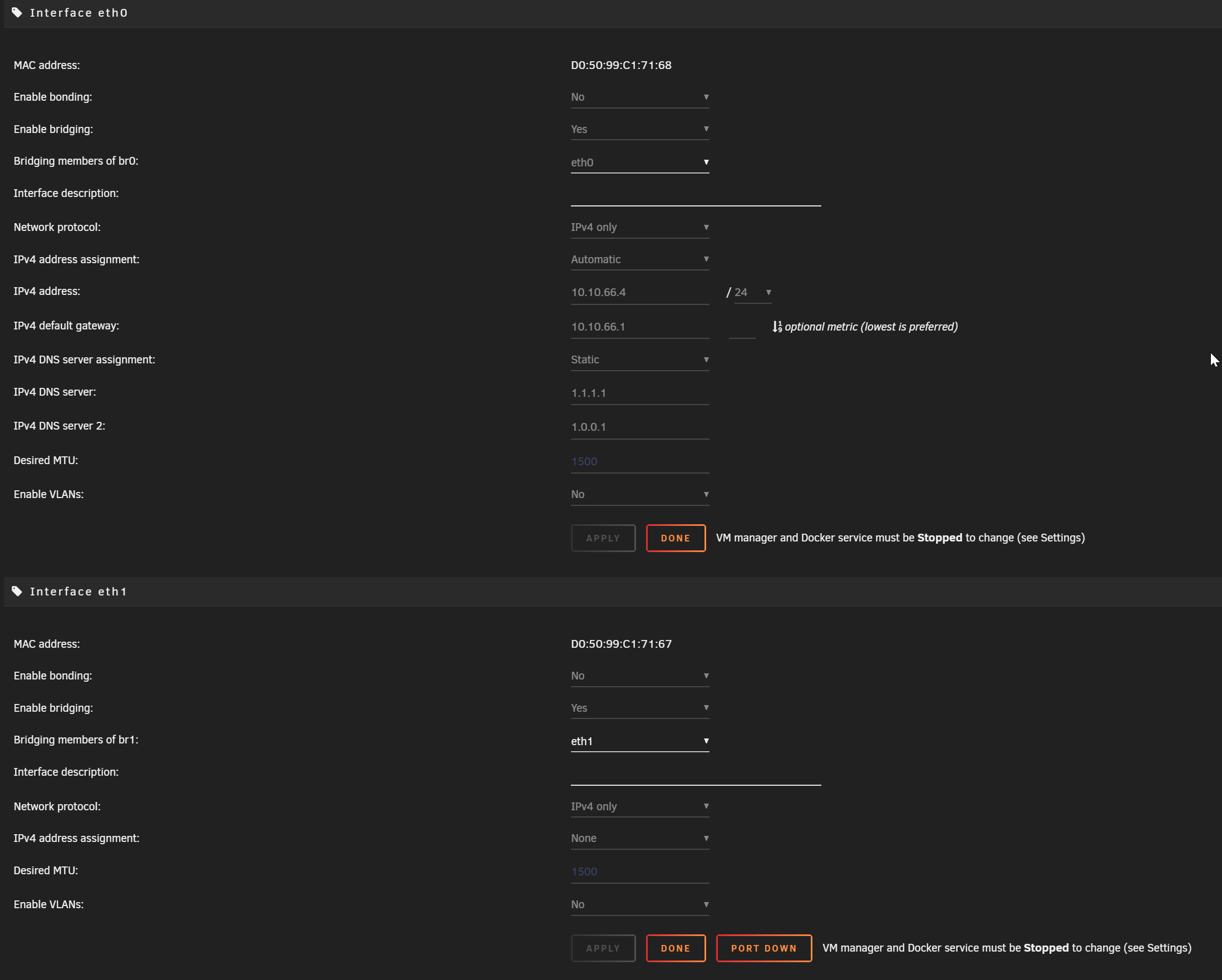

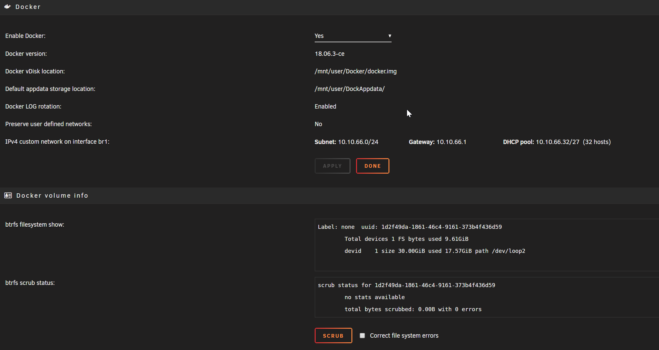

So when I am in the webui, I see references to the local container ip addresses. Is this correct? Cause I can't get a network IP when I log in. Gives me the 172 range.
I know this is a known issue but I have attempted a solution to the problem of accessing dockers over VPN using OpenVPN-as as a docker. I follow these instructions:
Here is my network settings:
1735363579_2019-05-0515_59_00-unraid_NetworkSettings.thumb.png.a63c3cbe68bb16225170f45a582a196a.png
Docker settings:
1274313979_2019-05-0515_59_48-unraid_DockerSettings.thumb.png.b95938e3aba51e70f822ef0b4c989223.png
OpenVPN-as network settings:
1227190807_2019-05-0516_01_01-AS_unraid.thumb.png.373a7a755ace5bf70a88d7b9750ca3d9.png
What looks wrong here? I have the secondary NIC to support this as per bonienl instructions but still I am unable to access my docker IP's over VPN. unRAID GUI is fine just no dockers.
Thanks

https://imgur.com/NaMcd85 and https://imgur.com/IZGFpXY This is the docker creation page for OpenVPN I am talking about.
Here are my network settings.
https://imgur.com/mspL162 https://imgur.com/ftysL1E https://imgur.com/2AloCA9
I am running RC8.
Edited by sittingmongoose
added more detail
