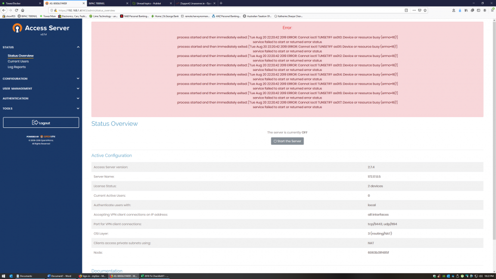

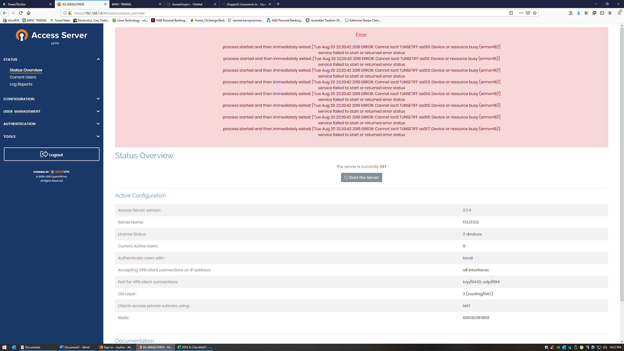

I have freshly installed this docker, and on the main webui page, i need to click on start server but get the following error:
Any ideas on where to start looking to fix? All docker setting were left as default
Cheers
Quick edit  - I restarted unraid and now the service is running
Not sure why a reboot was required!
